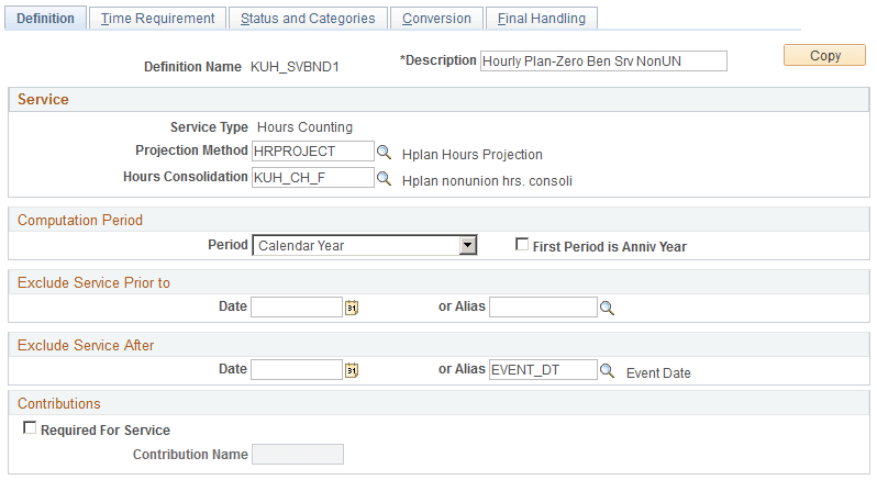

Service-Hours Counting - Definition Page
Use the Service-Hours Counting - Definition page (PA_SVC_DEFINITION) to set up basic service information.
Most of the field information on this page is the same as for the Service-Elapsed Time - Definition Page. Only the differences are documented here.
Navigation:
  • Set Up HCM, and then Product Related, and then Pension, and then Components, and then Service-Hours Counting, and then Definition
  • Set Up HCM, and then Product Related, and then Pension, and then Components, and then Service-Hours Equivalence, and then Definition
This example illustrates the fields and controls on the Service-Hours Counting - Definition page.
Service
Field or Control Description
Service Type
When you access this page through the Service-Elapsed Time component, the type is always Elapsed Time.
When you access this page through the Service-Hours Counting component, the type is always Hours Counting.
When you access this page through the Service-Hours Equivalence component, the type is always Hours Equivalence.
Projection Method
Set up your projection method on the Projections page, and enter the name of that method here.
When you estimate a benefit for a future retirement date, you need to be able to project hours data for future periods.
Note: The system displays this field and Hours Consolidation for the hours counting method only.
Hours Consolidation
Enter the name of your consolidation process here.
An hours counting service definition is based on the number of hours worked during a specific period. The hours consolidation process provides the necessary hours data.
Computation Period
Period
Select Anniversary Year, Calendar Month, Calendar Year, or Plan Year.
Hours counting service definition is based on the number of hours worked during a specific period.
Exclude Service Prior to and Exclude Service After
Date and or Alias
If the exclusion date occurs in the middle of an hours consolidation period, the system prorates the total hours for the period to determine the number of hours to be excluded. To exclude hours based on the day they are earned, create an hours consolidation definition that excludes those hours.

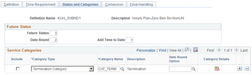

Service-Hours Counting - Status and Categories Page
Use the Service-Hours Counting - Status and Categories Page (PA_SVC_STATUS) to establish which employee action and reason codes turn service accrual off and which turn service accrual on.
Navigation:
  • Set Up HCM, and then Product Related, and then Pension, and then Components, and then Service-Hours Counting, and then Status and Categories
  • Set Up HCM, and then Product Related, and then Pension, and then Components, and then Service-Hours Equivalence, and then Status and Categories
  • Set Up HCM, and then Product Related, and then Pension, and then Components, and then Service-Elapsed Time, and then Status and Categories
This example illustrates the fields and controls on the Service-Hours Counting - Status and Categories page.
Hours counting service depends on the hours consolidation. Unless there is a minimum or maximum number of hours (real or projected) specified for a particular status, the service calculation uses whatever hours are provided. For example, if the consolidated hours includes hours from an employee's leave of absence, then those hours are considered for service; the service function does not categorize those hours and cannot, therefore, exclude them.
This means that Status and Categories work very differently for hours counting than for elapsed time and hours equivalence. The latter two methods use statuses as the basis for granting or not granting service credit; hours counting uses actual hours, rather than statuses, for this purpose.
To avoid crediting service for particular employee statuses, you must define your hours consolidation to exclude those hours.
In an hours counting definition, you identify Status and Categories for the following purposes:
  • Identifying hire and termination periods if you use different hours-to-service conversion methods for those periods.
  • Applying status-based minimum or maximum hours limits.
  • Establishing a link between the service definition and the employee's action/reason history.
    You need to put the following types of action and reason categories into your service definition:
    • Action and reason categories that start and stop limited periods.
      For example, if certain leaves of absence have a maximum of 500 hours, you must identify action and reason codes for both those leaves types and for returns from leave.
    • Categories of hire and termination actions.
    • Categories covering any action and reason that could appear as the first action in an employee's job record. Normally a hire and rehire category covers this, but if your practices include using other actions for an employee's initial job record, be sure those actions are incorporated into one of the service categories. Without this information, the system cannot match employees to definitions.
Because you do not need to make elaborate adjustments to an employee's job history in order to apply service rules, you don't necessarily need the same amount of service status detail as you would for an elapsed time service definition. However, it's a good practice to enter included and excluded service statuses that match the way your consolidation handles hours from those statuses. For example, if you generate hours for certain kinds of leaves, those leaves would be service included statuses.

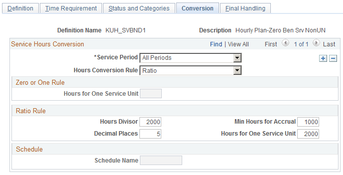

Conversion Page
Use the Conversion page (PA_SVC_HRS_CONVERT) to set up rules to convert hours to service. This is necessary for any hours-based service definition (hours counting or hours equivalence.)
Navigation:
  • Set Up HCM, and then Product Related, and then Pension, and then Components, and then Service-Hours Counting, and then Conversion
  • Set Up HCM, and then Product Related, and then Pension, and then Components, and then Service-Hours Equivalence, and then Conversion
This example illustrates the fields and controls on the Conversion page - Service-Hours Counting.
Service-Hours Counting - Conversion page
Service Hours Conversion
Service Period
You can use different conversion rules for the hire period and termination periods from those you use for a standard computation period. For example, you may use a ratio rule for hire and termination periods, but a zero or one rule for other periods.
Select the Service Period for the rules you are establishing: All Periods, Hire Period, or Termination Period.
The Service function identifies hire and termination periods by the categories you established on the Status and Categories page.
Note: Be sure to set up a rule for all periods. You can choose whether or not to set up additional rules for hire and termination periods.
Hours Conversion Rule
For each type of computation period, select an Hours Conversion Rule to establish the basis for your hours-to-service conversion:
  • Zero or One gives one service unit to employees with at least a minimum number of hours. Employees with fewer hours receive zero service units.
    If you select Zero or One, enter the minimum number of hours required in the Zero or One Rule group box.
  • Ratio gives fractional service units by dividing the number of hours by a constant. For example, if you divide by 2000, an employee with 1000 hours receives one half of a service unit.
    If you select Ratio, you must complete the Ratio Rule group box.
  • Schedule looks up the hours amount on a schedule and credits the corresponding amount of service.
    If you select Schedule, enter the schedule name in the Schedule group box.
Ratio Rule
Hours Divisor
Enter the denominator.
Decimal Places
Indicate the number of decimal places for the division.
Min Hours for Accrual (minimum hours for accrual)
Employees accrue of maximum of one service unit, even if the numerator is greater than the denominator.
To set a threshold number of hours, enter the minimum hours for accrual. Employees with fewer hours receive no service credit. For example, if you enter 500, employees with less than 500 hours receive no service credit.
Hours for One Service Unit
Set the number of hours for one service unit. Employees with the specified number of hours or more automatically receive one service unit; additional hours do not add service.
