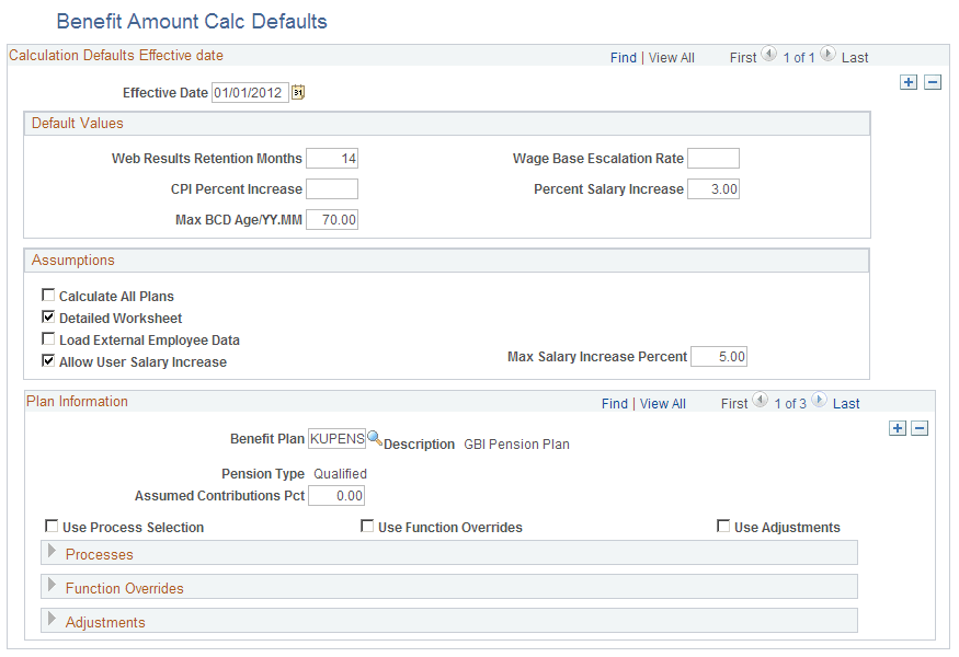

Benefit Amount Calc Defaults Page
Use the Benefit Amount Calc Defaults page (PA_SP_BNC_DEFAULTS) to define default settings for benefit calculations.
Navigation:
Set Up HCM, and then Product Related, and then Pension, and then Service Purchase, and then Benefit Amount Calc Defaults
This example illustrates the Benefit Amount Calc Defaults page.
Understanding Benefit Amount Calculation Defaults for Service Purchase
Service purchase transactions perform on-demand benefit calculations to determine an employee’s benefit amount with and without purchasing service. Normally, when you run the calculation process, you enter processing parameters on the pages in the Define Calculation component. When the service purchase process makes a remote call to the benefit calculation, it populates some of the parameters based on context. For example, the calculation type is always individual, and the service purchase transaction supplies the employee ID. Other values, however, come from the defaults that you supply.
Most (though not all) of the fields on the Benefit Amount Calc Defaults page simply provide values for the equivalent fields on various pages of the Define Calculation component. Refer to the topic Setting Up Benefit Calculations for more information about how these fields are used.
Default Values
Field or Control Description
Web Results Retention Months
Enter the number of months that you want the system to retain calculation results. Every time the calculation runs, the new results replace any previous results.
Be sure to enter a value that is consistent with your service purchase data retention requirements.
CPI Percent Increase
Corresponds to the Main Definitions page: Assumptions group box: CPI Percent Increase field.
Max BCD Age/YY.MM
Enter the maximum benefit commencement age, in years and months, to use in the calculation.
Wage Base Escalation Rate
Corresponds to the Main Definitions page: Assumptions group box: Wage Base Escalation Rate field.
Percent Salary Increase
Corresponds to the Main Definitions page: Assumptions group box: Salary Scale Percent Increase field.
Assumptions
Calculate All Plans
Corresponds to the Main Definitions page: Options group box: Calculate All Plans check box.
Detailed Worksheet
Corresponds to the Main Definitions page: Options group box: Detailed Worksheet check box.
Load External Employee Data
Corresponds to the Main Definitions page: Options group box: Load External Employee Data check box.
Allow User Salary Increase
Select this check box to allow users to enter an assumed annual percentage salary increase in the Benefit Calculation section of the Purchase Service page.
If this check box is not selected, the Annual Salary % Increase field on the Purchase Service page is hidden.
Max Salary Increase Percent
If you select the Allow User Salary Increase check box, use this field to define the maximum allowable salary increase percentage.
Plan Information
These calculation parameters are plan-specific.
Benefit Plan
Corresponds to the Plan Inputs page: Benefit Plan field.
Assumed Contributions Percent
Corresponds to the Plan Inputs page: Overrides group box: Assumed Contributions Pct field.
Use Process Selection
Corresponds to the Plan Inputs page: Use Process Selection group box.
Processes
Corresponds to the Process Selection page.
Use Function Overrides
Corresponds to the Plan Inputs page: Use Function Overrides group box.
Function Overrides
Corresponds to the Function Overrides page.
Use Adjustments
Corresponds to the Plan Inputs page: Use Adjustments group box.
Adjustments
Corresponds to the Adjustments page.

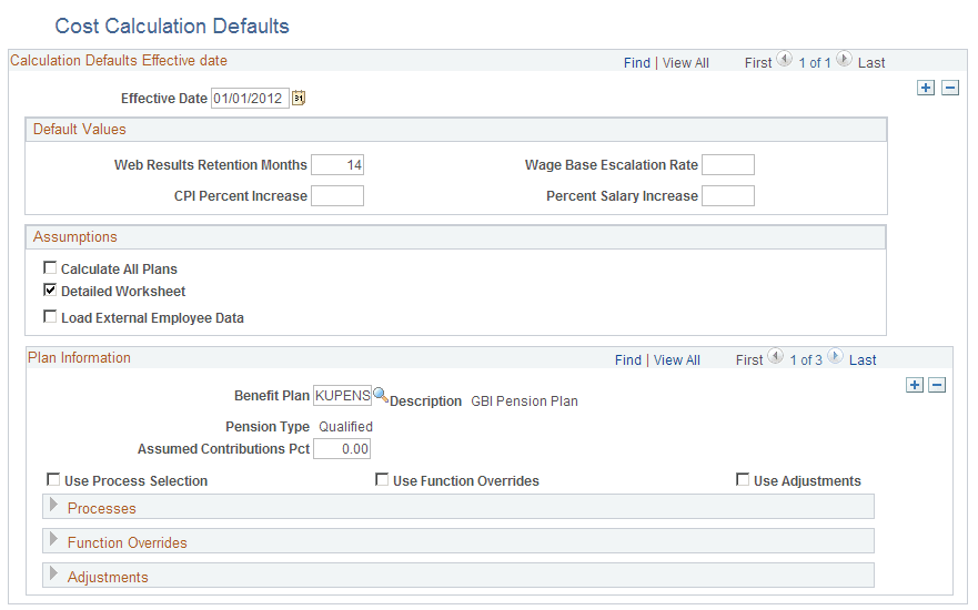

Cost Calculation Defaults Page
Use the Cost Calculation Defaults page (PA_SP_CSC_DEFAULTS) to define default settings for cost calculations.
Navigation:
Set Up HCM, and then Product Related, and then Pension, and then Service Purchase, and then Cost Calc Defaults
This example illustrates the Cost Calculation Defaults page.
Understanding Cost Calculation Defaults
Service purchase transactions perform on-demand cost calculations to determine how much an employee must pay to purchase service. If the Service Purchase Configuration - Cost Page indicates that you calculate cost using a benefit calculation, use the Cost Calculation Defaults page to provide default calculation parameters.
This page includes the same calculation parameter fields as the Benefit Amount Calc Defaults Page.
