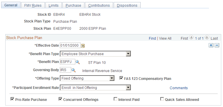

Stock Purchase Plan Rules - General Page
Use the Stock Purchase Plan Rules - General page (ST_ESPP_PLAN1) to define basic rules for a stock purchase plan and link the stock plan to a benefit plan.
Define plan details, such as the governing body, offering type, and when participants can enroll.
Navigation:
Set Up HCM, and then Product Related, and then Stock, and then Purchase Plans, and then Stock Purchase Plan Rules, and then General
This example illustrates the Stock Purchase Plan Rules - General page.
Field or Control Description
Benefit Plan
Select a benefit plan that matches the stock plan you selected. This is where you link the two plan codes.
Governing Body
The default is IRS.
Offering Type
If you select Fixed, the offering end date for all the participants is the same no matter when they enrolled in the offering. If you select Rolling, the offering end date is measured from the date on which the participants enroll with multiple offerings outstanding.
For both offering types, the offering begin date of a subsequent offering can't be earlier than the offering end date of the previous offering.
FAS 123 Compensatory Plan
Select if your plan is compensatory as defined by FAS 123.
Participant Enrollment Rule
Select one of the following rules that governs when new participants enroll in a stock purchase plan:
Enroll in Next Purchase Period: Enrolls the participant in the first purchase period for which the period begin date for the purchase period is greater than or equal to the coverage begin date, regardless of the offering. After you've identified the purchase period, the system assigns the offering of that purchase period and the first grant date before the purchase period begin date of the offering.
Enroll in Next Offering: Enrolls the participant in the first offering period for which the period begin date for the offering period is greater than or equal to the coverage begin date. After you've identified the offering period, the system assigns the first purchase period within the offering and the first grant date within the offering period.
Enroll in Current Offer/Pur Pd: Enrolls the participant in the current offering and purchase period. The system determines the current offering and purchase period by finding the first grant date greater than or equal to the coverage begin date. It assigns the offering based on the grant date and then the purchase period within the offering by selecting the first purchase period for which the purchase period begin date greater than or equal to the grant date.
User Defined: Does not enroll participants. Use this to import enrollments, modify the update participants process, or manually enter the enrollments.
Comments
Select to access the Plan Comments page, where you add comments.
Pro-Rate Purchase
Select to prorate purchases. If you select this, you can enter a prorate factor on the Stock Purchase - General page.
Concurrent Offerings
Select if your plan allows more than one active offering at a given time.
Interest Paid
Select if you pay interest on contributions. This field is informational only.
Quick Sales Allowed
Select to enable quick sales at the individual issuance level. This field is informational only.

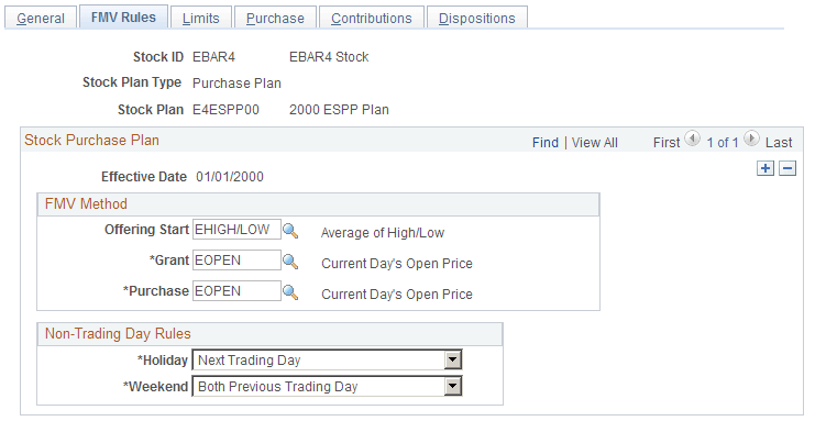

Stock Purchase Plan Rules - FMV Rules Page
Use the Stock Purchase Plan Rules - FMV Rules page (ST_ESPP_PLAN2) to select FMV methods and specify rules for nontrading days.
Navigation:
Set Up HCM, and then Product Related, and then Stock, and then Purchase Plans, and then Stock Purchase Plan Rules, and then FMV Rules
This example illustrates the Stock Purchase Plan Rules - FMV Rules page.
You define which method to use for calculating the stock FMV. You may chose to use different methods for different types of transactions.
FMV Method
Define a method to determine the stock values at various points in the stock purchase process. You define the FMV methods using the FMV Method Table page. These methods supersede the FMV defined in the Stock Details component for these specific events.
Offering Start
Select an FMV method. This field is informational only.
Grant
Select an FMV method. This field represents the grant FMV based on a participant's grant date. It might be used to determine the purchase price.
Purchase
Select an FMV method. This field is used to calculate the ordinary income for dispositions. Depending on your purchase plan rules, it may be used to determine the purchase price.
Non-Trading Day Rules
The system accounts for all days in a calendar year. The days that are not market trading days must be identified as such. Therefore, define a method to account for these nontrading days. The methods below supersede the holiday and weekend FMV rules defined in the Stock Details component.
Holiday
When a FMV calculation includes a holiday, select Previous Trading Day to use the previous trading day's price, or Next Trading Day to use the next trading day's price.
Weekend
When a FMV calculation includes a weekend, select one of the following:
Both Previous Trading Day: Uses the previous trading day's price for both weekend days.
Both Next Trading Day: Uses the next trading day's price for both weekend days.
Saturday Previous - Sunday Next: Uses the previous trading day's price for Saturday and the next trading day's price for Sunday.
Saturday Next - Sunday Previous: Uses the next trading day's price for Saturday and the previous trading day's price for Sunday.

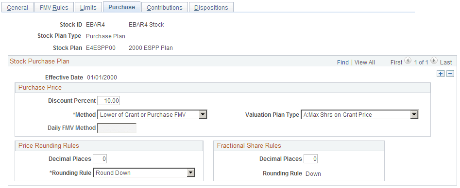

Stock Purchase Plan Rules - Purchase Page
Use the Stock Purchase Plan Rules - Purchase page (ST_ESPP_PLAN4) to define the purchase rules of your plan, such as purchase price calculation and share and price rounding rules.
Navigation:
Set Up HCM, and then Product Related, and then Stock, and then Purchase Plans, and then Stock Purchase Plan Rules, and then Purchase
This example illustrates the Stock Purchase Plan Rules - Purchase page.
Purchase Price
Discount Percent
Enter the discount percent the Calculate Prices process is to use when calculating the purchase price for the stock.
Method
Select how the Calculate Prices process should calculate the participants' purchase price:
Average Daily FMV in Purch PD: Averages the daily FMV throughout the purchase period.
Grant FMV: Uses the FMV on the day of the grant.
Lower of Grant or Purchase FMV: Uses the lower of the grant or purchase FMV. This is the default.
Purchase FMV: Uses the stock FMV on the day of the purchase.
User Defined: Uses some other method. The Calculate Prices process must be manually entered.
Valuation Plan Type
Select the appropriate valuation plan type, as defined in FAS 123. Valid values range from Type A to Type I.
Daily FMV Method
If you selected a purchase price method of Average Daily FMV in Purch PD, this field is available for entry. Select a method to determine what type of price is used for each day. Valid values are defined in the FMV Method Table.
Price Rounding Rules
The price rounding rules defined on the Stock Details - Common Rules page is the default. You can make them more restrictive.
Decimal Places
Enter a number between 0 and 6 to determine the number of decimal places when calculating a price or FMV in the Calculate Prices process.
Rounding Rule
Select a rounding rule to use when calculating a price or FMV in the Calculate Prices process: Standard, Up, and Down.
Fractional Share Rules
These fields become available for entry if fractional shares are allowed at the stock detail level. The fractional share rules defined on the Stock Details - Common Rules page are the default. You can make them more restrictive. If fractional shares are not allowed, The Decimal Places field is 0 and the Rounding Rule field is Down.
Decimal Places
Enter a number between 0 and 6 to determine the number of decimal places to round when calculating the number of shares purchased.
Rounding Rule
Displays Down, which is the method of rounding when calculating the number of shares to purchase.

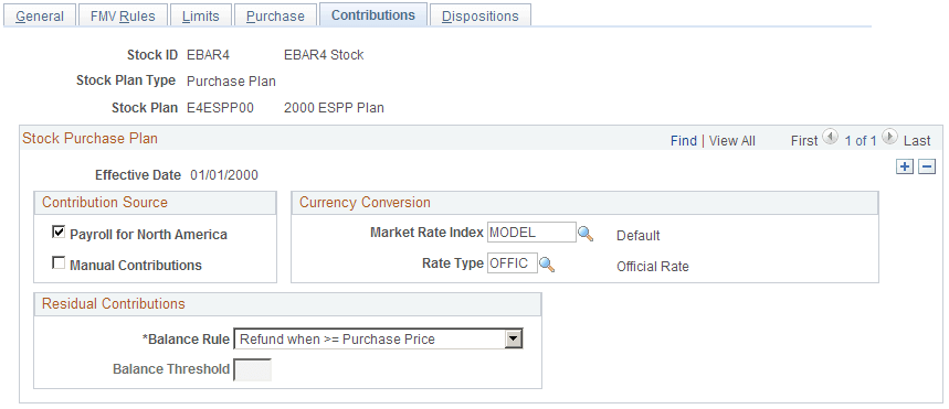

Purchase Plan Rules - Contributions Page
Use the Purchase Plan Rules - Contributions page (ST_ESPP_PLAN5) to define the contribution rules.
Navigation:
Set Up HCM, and then Product Related, and then Stock, and then Purchase Plans, and then Stock Purchase Plan Rules, and then Contributions
This example illustrates the Stock Purchase Plan Rules - Contributions page.
You define the contribution source, currency conversion, and what happens to residual contributions for a stock purchase plan. The system gathers the contributions in the local currency based on the participant's pay group. It converts the contributions to the stock currency for the purchase, then back to the current local currency for refunds.
Contribution Source
Select Payroll for North America if you receive stock purchase contributions from Payroll for North America. If Payroll for North America is not installed, this option is not available. Select Manual Contributions if you receive stock purchase contributions from any other source. If you use Payroll for North America as your primary contribution source, you might also select Manual Contributions to allow for adjustments. This field determines what contributions are processed in the Gather Contributions process.
Currency Conversion
If you use the system to convert local currency to the currency defined at the stock ID level, select the currency conversion parameters for the Currency Conversion process.
Market Rate Index
Select a market rate index for the Convert Currencies process to use to convert participant contributions from a local currency to the stock currency. The Market Rate Index is defined in Define General Options is the default.
Rate Type
Select a currency conversion rate type to indicate the type of rate used to convert the local currency to the stock ID currency.
Residual Contributions
After a stock purchase is processed and confirmed, some of the participants' contributions may be left over. The balance may be less than the purchase price of the stock or the participant may have reached an offering period, or purchase period limit, which left more than the purchase price unused. Indicate a method of handling these residual contributions.
Balance Rule
Select Carry Forward Balance and no balance threshold amount to carry forward any amount. Select this option and enter a balance threshold amount to carry forward any amount less than or equal to the threshold amount and refund the rest.
Select Carry Fwd when <= Purchase Price to carry forward any amount less than or equal to the participant's purchase price. If the amount is greater than the purchase price, it is refunded.
Select Refund Balance and no balance threshold amount to refund any amount. Select this option and enter a balance threshold amount to refund any amount greater than or equal to the threshold amount. If the amount is less than the threshold amount, it is carried forward to the next purchase.
Select Refund when >= Purchase Price to refund any amount greater than or equal to the participant's purchase price after a purchase. If the amount is less than the purchase price, it is carried forward to the next purchase. This is the default.
Balance Threshold
If you selected a balance rule of Carry Forward Balance or Refund Balance, this field becomes available for entry. Enter the minimum amount needed to carry forward or refund.
