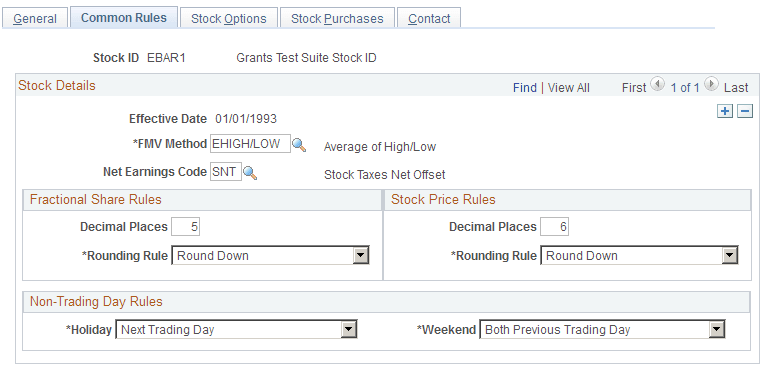

Stock Details - Common Rules Page
Use the Stock Details - Common Rules page (STOCK_DTL2) to define rules common to stock option and stock purchase plans, including fractional share, stock price, and non-trading day rules.
Navigation:
Set Up HCM, and then Product Related, and then Stock, and then Stock Rules, and then Stock Details, and then Common Rules
This example illustrates the Stock Details - Common Rules page.
Field or Control Description
FMV Method
Select the method to determine fair market value. FMV methods are defined on the FMV Method Table page.
Net Earnings Code
Select the earnings code that is used to net out the taxes sent to Payroll for North America so that a check is not generated.
Decimal Places
Specify how many decimal places to use for fractional shares and stock prices. Enter a number from 1 to 6.
Rounding Rule
Specify how to round the fractional shares and stock prices.
Holiday
Determine which day's price to use when an FMV calculation includes a holiday. Values are Previous Trading Day and Next Trading Day.
Weekend
Specify the combination of day's prices to use when an FMV calculation includes a weekend. Values are:
  • Both Next Trading Day. The system uses the next trading day's price for both weekend days.
  • Both Previous Trading Day
  • Saturday Next - Sunday Previous
  • Saturday Previous - Sunday Next

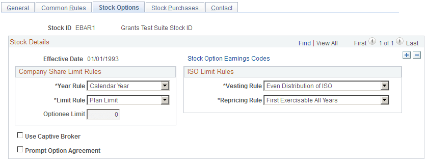

Stock Details - Stock Options page
Use the Stock Details - Stock Options page (STOCK_DTL3) to define rules specific to stock option plans, such as earnings codes, company share limit, ISO limit rule, captive broker, and agreement details.
Navigation:
Set Up HCM, and then Product Related, and then Stock, and then Stock Rules, and then Stock Details, and then Stock Options
This example illustrates the Stock Details - Stock Options page.
Stock Option Earnings Codes
Click to access the Stock Option Earnings Code page, where you can define stock option earnings codes.
Year Rule
Select either Calendar Year or Fiscal Year to indicate how your company calculates any company-mandated annual share limits on stock option grants to optionees. Select Calendar Year if your company does not impose a share limit.
If you select Fiscal Year, use the Stock Fiscal Year page to define the fiscal year.
Limit Rule
Select Stock Limit if your company limits the number of shares granted to each optionee for this stock ID. Select Plan Limit if your company limits the number of shares granted to each optionee by stock plan.
Optionee Limit
Enter the number of shares each optionee is limited to. This field is available if you select Stock Limit as the limit rule.
Vesting Rule
Specify the rule to use for handling the amount over the ISO limit. Select Even Distribution of ISO to use the same percentage over the limit to determine the total non-qualifying (NQ) shares. Select Maximum ISO limit each year to use the actual percentage over the limit to determine the total NQ shares.
Repricing Rule
Select the rule for determining how repriced grants contribute to the ISO limit. Select First Exercisable All Years to look at the shares first exercisable in all years. Select First Exercisable as of Reprice to look at the shares first exercisable the year of the reprice up to the reprice date.
Use Captive Broker
Select to require that participants use a captive broker for options transactions that require a broker.
Prompt Option Agreement
Select to have the system display a warning message for exercise transactions that do not have a related agreement on file.
