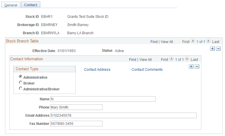

Stock Branch Table - Contact Page
Use the Stock Branch Table - Contact page (STOCK_BRANCH2) to define brokerage branch contacts.
Navigation:
Set Up HCM, and then Product Related, and then Stock, and then Stock Rules, and then Stock Branch Table, and then Contact
This example illustrates the Stock Branch Table - Contact page.
Field or Control Description
Contact Type
Values are: Administrative, Broker, or Administrative/Broker. You can identify one person or different people to serve as the administrative and broker contact.
