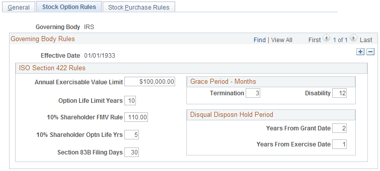

Governing Body Rules - Stock Option Rules Page
Use the Governing Body Rules - Stock Option Rules page (ST_GOVERN_BODY2) to define ISO Section 422 rules and Section 83B filing days for your stock option system.
Navigation:
Set Up HCM, and then Product Related, and then Stock, and then Foundation Rules, and then Governing Body Rules, and then Stock Option Rules
This example illustrates the Governing Body Rules - Stock Option Rules page.
ISO Section 422 Rules
The system displays default amounts defined by the IRS for qualified stock option plans and employee stock purchase plans as of 1/1/1933, the date that IRS Section 422 regulations became effective. You can change the default amounts if, for example, you want to make all your equity plans more restrictive. If you make the amounts more generous, your plans may not comply with regulatory agency rules and securities laws.
Field or Control Description
Annual Exercisable Value Limit
The annual ISO exercisable value limit, determined as of the grant date, as defined by the IRS.
Option Life Limit Years
The number of years between an option's grant date and its expiration date.
10% Shareholder FMV Rule
The percentage of FMV that the price of an option that is granted to a 10% shareholder must equal or exceed.
10% Shareholder Optn Life Yrs (option life years)
The number of years between the grant date and the expiration date for options that are granted to 10% shareholders.
Section 83B Filing Days
The number of days allowed for an individual to file a Section 83B election after being awarded a restricted stock award.
Grace Period - Months
Termination
The number of months following a termination to exercise a vested ISO option, after which it is treated as a non-qualifying option.
Disability
The number of months following a termination due to disability to exercise a vested ISO option, after which it is treated as a non-qualifying option.
Disqual Disposn Hold Period (disqualifying disposition hold period)
An ISO grant must be held a minimum number of years from the grant date to be considered a qualifying disposition when it is sold.
Years From Grant Date
The minimum number of years from grant date to sale date for an ISO sale to be considered a qualified disposition. The system displays 2 years.
Years From Exercise Date
The minimum number of years from exercise date to sale date for an ISO sale to be considered a qualified disposition.
