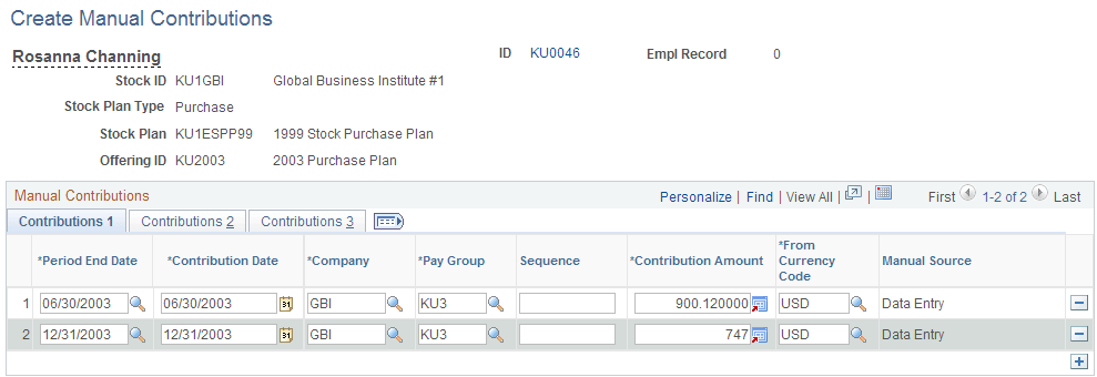

Create Manual Contributions Page
Use the Create Manual Contributions page (ST_CONTRIB_MANUAL) to enter participants' contributions that are not automatically provided through Payroll for North America.
You must first enroll participants.
Navigation:
This example illustrates the Create Manual Contributions page.

Contributions 1 Tab
| Field or Control | Description |
Sequence |
Enter a sequence number if you are entering multiple contributions for the same date. |
Contribution Amount |
Enter the amount contributed in the original currency. To change to a different currency, click the Currency Conversion button to access the Display in Other Currency page, where you change the currency. |
Manual Source |
If you entered the data online using the Manual Contributions page, the system displays Data Entry. If you imported your data, the system displays Import. |
