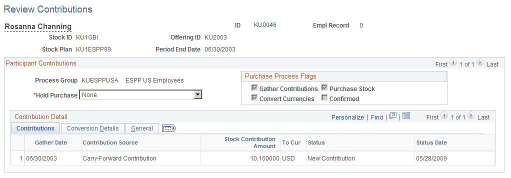

Review Contributions Page
Use the Review Contributions page (ST_CONTRIB_PARTIC) to view a participant's contributions.
You can place a hold on the purchase if you don't want to process the purchase.
Navigation:
Stock, and then Stock Purchases, and then Review Contributions
This example illustrates the Review Contributions page.
Common Page Information
Field or Control Description
ID
Click to access the Employee Information page to view employee information.
Hold Purchase
If you have not confirmed the purchase, this field is available for entry. To hold this individual's purchase, select a hold reason. Otherwise, use the default value of None. The Gather Contributions process generates a Hold Purchase flag for terminated employees and participants identified as major shareholders on the Insider page.
Note: If you select a hold reason for a participant and have already run the purchase process but not confirmed the purchase, the purchase is invalidated and must be recalculated. The system issues a warning message. If you accept it, the system removes the participant's calculated purchase records.
Purchase Process Flags
If you've run the Gather Contributions, Convert Currencies, Purchase Stock, or Confirm Purchase processes, the system selects the appropriate check boxes.
Contributions Tab
Gather Date
Displays the date on which the contributions were gathered.
Contribution Source
Valid values are North American Payroll, Manual Contributions, Carry Forward, or Residual Contribution.
Stock Contribution Amount
Displays the contribution amount converted to the stock currency.
Status
Valid values are Processed Contribution, Refunded, New, and Other.
Status Date
Displays the date of the process status.
Conversion Details Tab
The system calculates the contribution amount by multiplying the contribution amount by the rate multiplier and then dividing by the rate divisor for the market rate index, rate type, and exchange date specified.
General Tab
Sequence
Displays the purchase sequence number. The system generates one sequence number for multiple transactions done in a single day.
