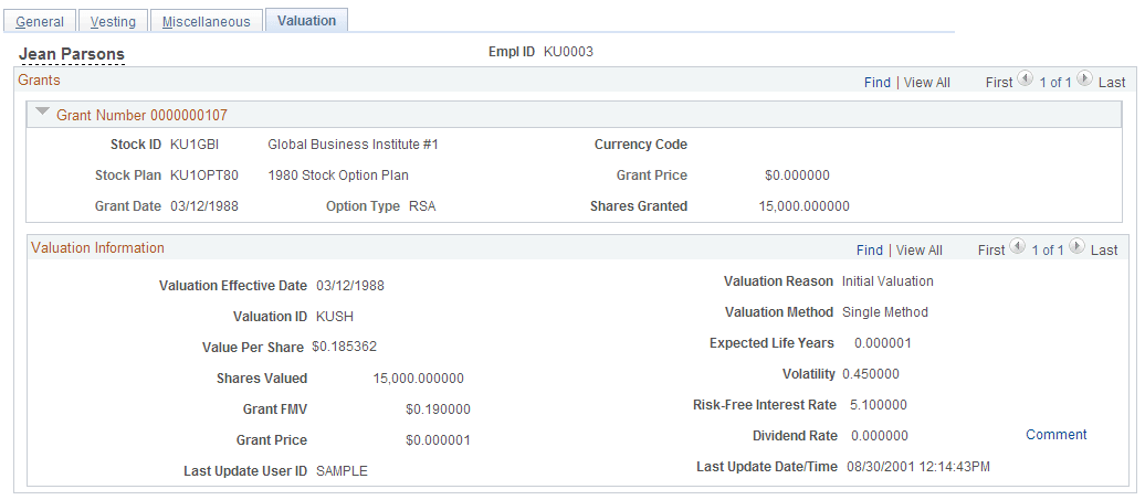

Maintain Grants - Valuation Page
Use the Maintain Grants - Valuation page (ST_GRANT_VALUE) to view grant valuation information including the shares valued, the grant FMV, and expected life years for a selected employee and grant.
Navigation:
Stock, and then Grants, and then Maintain Grants, and then Valuation
This example illustrates the Maintain Grants - Valuation page.
When you use the multiple valuation method to value grants, the values on this page reflect the weighted averages for the grant.
Field or Control Description
Valuation Reason
When a grant valuation is first confirmed, the valuation reason is set to Initial Valuation.
Reprice appears in this field if this grant has been revalued after repricing.
Value Per Share
This field displays the fair value per share and appears as a hyperlink if the multiple valuation method was used. Click the link to open the Grant Valuation page, where you can see detailed information for each valuation period.
