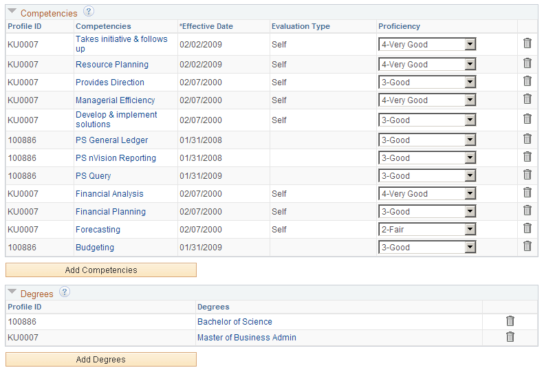

This example illustrates two profile-related sections of a job opening.
Job Opening page: profile-related sections
<Profile Content Type>
The Job Opening page includes a separate grid for each profile content type in the associated job opening template.
The columns in each grid depend on the settings on the Content Section Configuration – <Content Type> Page.

<Content Item Name>
Displays the name of the specific content item. For example, in the Competencies grid, this column (labeled Competencies) displays names of specific competencies such as Forecasting or Budgeting
To modify information about a content item that you have already added to the grid, click the content item name to access the corresponding detail page.
<Additional Column Names>
The columns that appear in each grid depend on the settings in the Content Section Configuration page for the content type. Specifically, fields for which you select the Summary check box on the Content Section Configuration page appear as grid columns.
Add <Content Item>
Click this link to access the content item detail page, where you enter specific content items (such as Analytical Thinking. The fields on the detail page depend on the content type definition within the Manage Profiles business process.
Save the data on the detail page to add the content item to the grid.
Proficiency Ratings
When content types such as competencies are associated with ratings scales, the content type grid displays a proficiency rating. This data is informational only.
When you screen applicants based on competency ratings, the system does not evaluate whether the employee has received the specified rating. Instead, the screening process awards points based on the rating scale that you set up when you define your screening criteria.
