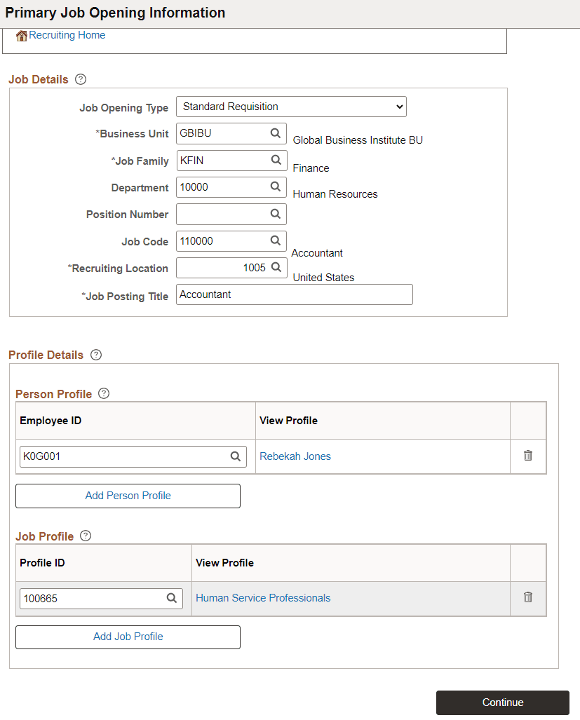

Primary Job Opening Information Page
Use the Primary Job Opening Information page (HRS_JO_LAUNCH) to enter primary job opening information.
Navigation:
Recruiting, and then Create Job Opening
This example illustrates the Primary Job Opening Information page.
Job Details
The driver fields for flexible templates are Business Unit, Job Family, Job Code, Department, and Recruiting Location (which represents the primary recruiting location). The Job Family field appears only if it is the segmenting type specified on the Recruiting Installation - General page.
Field or Control Description
Job Opening Type
Select whether this is a Standard Requisition or a Continuous Job Opening. You cannot change the type after you move on to the Job Opening page.
A standard requisition is for a specific job or position that you want to fill. You must provide specific data regarding the job or position code. Standard requisitions can represent multiple job codes if you've configured the Recruiting Installation - Jobs page to allow this.
A continuous job opening represents a job for which your organization is always hiring. This type of job opening can be used as a placeholder for possible candidates and can potentially remain open for an indefinite amount of time. Continuous job openings are not used in Time to Fill reporting.
Continuous job openings require only a job posting title. They do not require a job code or position number.
Business Unit
Select the business unit associated with the job opening.
A user’s default business unit is based on the primary permission list assigned to the user ID. The default business unit for that permission list is specified on the Application Fundamentals: Org Defaults by Permission Lst - Defaults Page.
The business unit controls the available values for various business unit-controlled or setID-controlled job opening fields such as position number, job code, location, and recruiting location.
The business unit does not control values for the profiles that you enter in Person Profile grid and the Job Profile grid, but it does filter the profile identities (job codes, positions, and so forth) that the system brings from the profiles into the job opening.
Department
Select the department associated with this job opening.
Position Number
Optionally select the position number for the job opening. This field appears when Position Management Option on the Application Fundamentals: HCM Options Page is set to Full or Partial.
When job openings are segmented by business unit, department, job family, or job profile, you must enter a segmenting value before entering a position, as the segmenting value (along with the business unit) controls which positions are available for selection.
When job openings are segmented by company, job code, or salary grade, you can select a position without first entering a segmenting value.
Job Code
Select the job code associated with this job opening.
For continuous job openings, this field is optional, even if job openings are segmented by job code.
For standard requisition job openings, this field is required if the Position field is blank. If the Position field contains a value, the system derives the job code from the position number.
Recruiting Location
Select the primary recruiting location associated with this job opening. You can enter additional recruiting locations on the main Job Opening page.
Posting Title
Enter an initial primary posting title. The system uses the primary posting title to identify the job opening on various pages throughout the system. The primary posting title is also the default title when you create job postings. After you have created one or more job postings for the job opening, you can change the primary posting title by selecting a posting to use for that purpose.
Additional Job Details Based On Segmenting Type
The Primary Job Opening Information page always displays a required field for the template segmenting type. This page already includes fields for many of the segmenting type options, but the following fields appear only when they are used as the segmenting value:
Company
This field appears when the Template Segmenting Type field on the Recruiting Installation - General page is set to Company.
Select the company associated with the job opening.
Job Family
This field appears when the Template Segmenting Type field on the Recruiting Installation - General page is set to Job Family.
Select the job family associated with this job opening.
Job Profile
This field appears when the Template Segmenting Type field on the Recruiting Installation - General page is set to Job Profile.
Select the job profile that is associated with this job opening. Available profiles include non-person JOB profiles.
Salary Admin Plan (salary administration plan) and Salary Grade
These fields appear when the Template Segmenting Type field on the Recruiting Installation - General page is set to Salary Grade.
Select the salary administration plan and salary grade that are associated with this job opening.
Profile Details
If the Allow Profile Utilization field on the Recruiting Installation - General page is set to Yes, the Profile Details group box appears on the Primary Job Opening Information page. Use the grids in this group box to select profiles to import into the job opening.
You can enter a maximum of three profile IDs on this page using any combination of the Person Profile grid, the Job Profile grid, and any profile that is loaded based on recruitment template settings. For example, if the recruitment template is configured to load the profile for the job code, and you enter a job code that has a profile, then that profile counts toward the limit of three profiles per job opening.
Person Profile
This grid appears only if the Person Profile Integration field on the Recruiting Installation - General page is set to Yes.
Enter the employee IDs for the people whose profile data you want to bring into the job opening. Profile security applies: administrators can select any profile, other users can select only their own profile and the profiles of their direct reports.
The View Profile link displays the name of the person whose employee ID you entered. Click the link to access the PeopleSoft Human Resources Manage Profiles: Person Profile Page so that you can preview the characteristics of the selected profile.
Job Profile
Enter the profile IDs for the job profiles whose data you want to bring into the job opening.
You can select non-person profiles with any profile type.
The View Profile link displays the name of the profile you entered. Click the link to access the PeopleSoft Human Resources Manage Profiles: Non-person Profile Page so that you can review (though not update) the characteristics of the selected profile.
Continue Button
Continue
Click this button to continue creating the job opening.

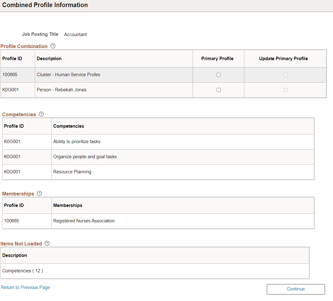

Combined Profile Information Page
Use the Combined Profile Information page (HRS_JO_PRFL_PRVW) to review the profile characteristics that are being brought into the job opening.
Navigation:
Click the Continue button on the Primary Job Opening Information Page.
This page appears only if profile integration is active and the system has identified at least one profile to be imported into the job opening.
This example illustrates the Combined Profile Information page
Profile Combination
This grid lists the profiles whose attributes you are bringing into the job opening. It lists both person and non-person profiles.
You cannot change your profile selection on this page. To change your profile selection, return to the Primary Job Opening Information page.
Profile ID
Displays the profile ID. When you review specific content items that system copied into the job opening, the profile ID for the content item indicates which profile supplied the data.
Description
Displays the type of profile and the profile name. For example, a person profile description follows the format Person - <Person Name>.
Primary Profile
You must select one of the profiles as the primary profile for the job opening. Any content items that you later add to the job opening are associated with the primary profile, unless there is a profile type configuration incompatibility, in which case the profile ID for the new content item is 0.
Update Primary Profile
If the primary profile is a non-person profile, select this check box if you want to update the profile based on the job opening profile. For example, when you are creating a job opening, the hiring manager might provide updated requirements that you can then transfer back to the job opening's primary non-person profile, maintaining consistency and eliminating redundant work efforts. Copying occurs only when the job opening is in an open status.
The system updates the profile when you save the job opening after adding new content items or after modifying or removing content items that came from the primary profile.
Note: You cannot update person profiles from the job opening.
Profile Associations
This grid lists the job codes and positions that are associated with the profiles that you are using. If any of the profiles were derived from job code or position data that you entered on the Primary Job Opening Information page, then that job code or position necessarily appears in the grid.
Primary Job Code
Select the primary job code and position for the job opening. The job code and position that you entered on the Primary Job Opening information page are selected by default. If you change this default, the job opening is created using the job code and position that you select here instead of the original job code and position from the Primary Job Opening information page.
Note: Position information appears only under full or partial position management.
Content Types and Content Items
Grids appear for every profile content type that has data to be imported. Each grid lists the specific content items that are to be loaded into the job opening. For example, the Competencies grid lists specific competencies.
The system imports data only for profile content types that are included in the job opening template.
Profile ID
Identifies the profile that provided the content type. For example, if you load Betty Locherty's person profile and the Director of Finance job profile, the Competencies grid lists both Betty's competencies and the job competencies, and this field lets you know which profile a specific competency came from.
If multiple profiles have the same item (for example, an identical competency), and one profile has a version with a later effective date, then the system brings that later version and its Profile ID in the grid for that content type.
<content item>
The second column in each grid displays the name of the specific content item that is to be loaded to the job opening. For example, in the Competencies grid, this column shows the name of the competency.
Items Not Loaded
Description
Displays information about the number and type of profile attributes that cannot be imported into the job opening. For example, Competencies (3) indicates that three competencies were not loaded.
Items are not loaded when your organization has configured a particular type of attribute differently for job openings than for the type of profile that you are importing. The message appears so that you understand why attributes that you might have been expecting to see do not appear on this page. You cannot force the system to import the incompatible attributes.

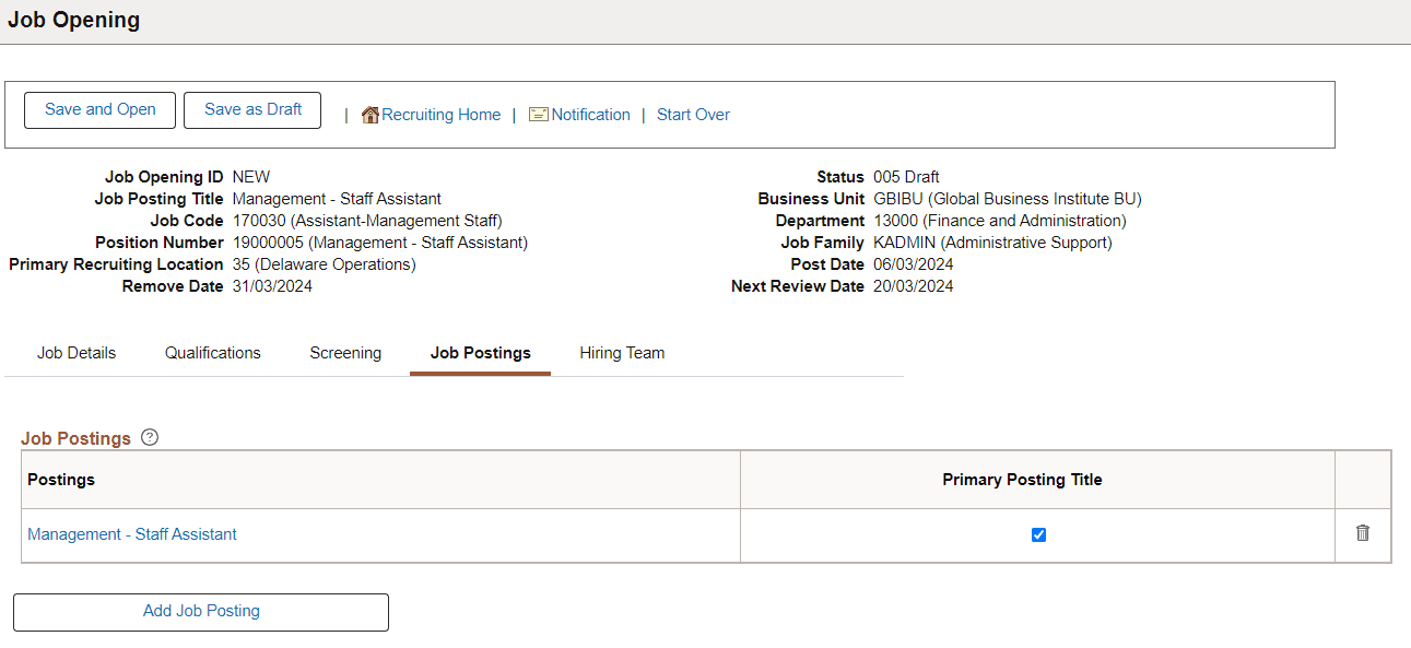

Job Opening Page
Use the Job Opening page (HRS_JOB_OPENING) to create a job opening and to manage job opening details.
Navigation:
  • Recruiting, and then Create Job Opening
    Click the Continue button on the Primary Job Opening page (and, if applicable, on the Combined Profile Information page).
  • Recruiting, and then Search Job Openings
    Click a job opening to access the Job Opening page, then access the Details tab.
This example illustrates the toolbar, header, and tabs on the Job Opening page.
Job Postings under Job Opening Page
Toolbar
The toolbar is different when you view the job on the Manage Job Opening Page.
Save and Open
Click this button to save the job opening and set the job opening status to Open (or, if you changed the delivered status configuration, to the default job opening status you defined.)
This button appears on unsaved and Draft job openings if no approval is required.
Save and Submit
Click this button to save the job opening and set the job opening status to Pending Approval (or, if you changed the delivered status configuration, to the pending approval status that you defined.) This action also sends a notification to the approver.
This button appears on unsaved and Draft job openings if approvals are required.
Save as Draft
Click to save the job opening and set the job opening status to Draft.
This button appears on unsaved and Draft job openings regardless of whether approval is required.
Save
Click to save changes to a job opening without changing its status.
This button appears replaces the Save as Draft button after job opening is opened or submitted.
Delete
Click to delete the job opening and return to the Primary Job Opening Information Page.
This button appears only on Draft job openings.
Notification icon Notification
Click to access the Send Notification Page. Notifications that you send this way are simple text messages, without a link to the job opening.
This button is visible only in unsaved and draft job openings.
Start Over
Click to return to the Primary Job Opening Information Page to start the job creation process over.
This button appears only if you have not yet saved the job opening.
Print Job Opening icon Print Job Opening
Click to open the Select Job Opening Sections Page, where you generate the Job Opening report after selecting which data to include in the report.
This button appears only after you initially save the job opening, either by saving as draft, opening, or submitting.
CloneClone
Click to open the Clone Job Opening Page where you can clone the current job opening.
This button becomes visible after a job opening is opened or submitted.
Create New Job iconCreate New
Click to access the Primary Job Opening Information Page, where you begin the process of creating a new job opening.
Job Opening List iconJob Opening List
If you access a draft job opening from a list of job openings (such as the search results on the Search Job Openings page), use this toolbar button to return to the job opening list.
Previous iconPrevious Job Opening, Next iconNext Job Opening
If you access a job opening from a list of job openings (such as the search results on the Search Job Openings page), use these toolbar buttons to return to the job opening list or to navigate directly to other job openings in the list.
Header
The read-only fields below the toolbar provide basic information about the job opening.
Job Opening ID
Displays the unique identifier for the job opening.
Status
Displays the current status of the job opening.
Job Posting Title
Displays the primary posting title for the job opening. This is initially entered on the Primary Job Opening Information page. You update the posting title by creating job postings and designating one to be used for the primary posting title. Manage postings and the primary posting title on the Job Opening Page: Job Postings Section.
Business Unit
Displays the business unit of the job opening.
Job Code
Displays the job code of the job opening. If a job opening has multiple job codes, this is the primary job code.
Under full position management, the Job Code field is not shown. The Job Code field is also hidden if the job opening does not specify a job code, This occurs only in Continuous job openings.
Department
Displays the department for the job opening. If the job opening does not specify a department, this field is not visible.
Position
Displays the position for the job opening. If a job opening has multiple positions, this is the primary position. If the job opening does not specify a primary position, this field is not visible.
Job openings include position data only if the PeopleSoft HCM system is configured for full or partial position management.
Job Family, Job Profile ID, Company, or Salary Plan/Grade
If your template segmenting value (the data that controls selection of a job opening’s recruitment template) is job family, job profile ID, company, or salary grade, then the corresponding field appears in the job opening header.
The segmenting value is configured on the Recruiting Installation - General Page.
Post Date, Remove Date, and Next Review Date
Displays the posting destination details for the job. These fields appear if the job has a job posting that is made primary. Also, the posting should have a primary posting destination enabled, and the post date, remove date and next review dates should be available for the posting destination. See Posting Information Page.
