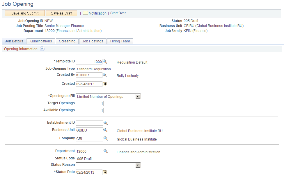

This is the first of three examples that illustrate the Job Opening page: Opening Information section.
Job Opening page: Opening Information section (1 of 3)

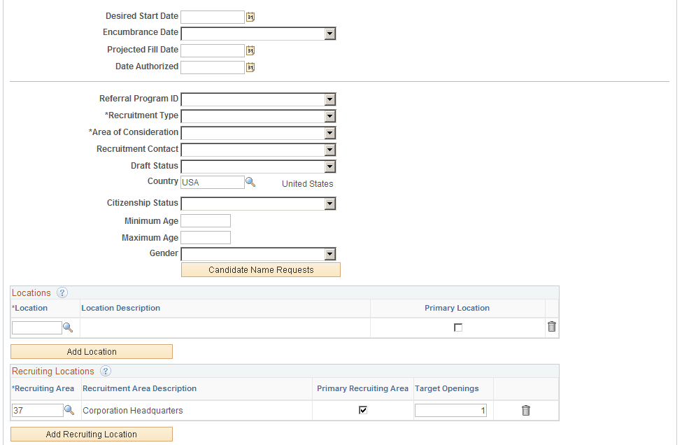

This is the second of three examples that illustrate the Job Opening page: Opening Information section.
Job Opening page: Opening Information section (2 of 3)

Opening Information
Field or Control Description
Template ID
Select a recruitment template to associate with the job opening.
The system determines the default value for this field based on the Template Segmenting Type entered on the Recruiting Installation - General Page, the Segmentation Values entered on the Segmentation Values Page, and the job opening data that you enter.
This field is visible only to users with administrator privileges.
Job Opening Type
Displays the type of job opening selected on the Primary Job Opening Information page: Standard Requisition or Continuous Job Opening.
Created By
The default creator is the person who originally created the job opening, but you can modify this if necessary.
Created
The default date is the date that the job opening was actually created, but you can modify this if necessary.
Openings to Fill
Specify whether the openings are:
  • Limited: Enables the Target Openings and Available Openings fields to appear. The system closes the job opening when all openings are filled.
  • Unlimited: Hides the Target Openings and Available Openings fields. The job opening stays open until it is manually closed.
Target Openings
Enter the number of positions that are to be filled. This field appears only if you select Limited in the Openings to Fill field.
Farther down the page, in the Recruiting Locations grid, you will specify the number of target openings associated with specific recruiting locations. The overall number of target openings must be equal to or greater than the total target openings for all recruiting locations.
Available Openings
This field displays the number of available openings only if Limited was selected in the Openings to Fill field. The initial number of openings is the value entered in the Target Openings field. When you hire an applicant in this job opening, the system decreases this number by one. When all available positions are filled, the status of the job opening is set to Closed.
The total Available Openings is always less than or equal to the Target Openings.
Establishment ID
Select the Establishment ID for this job opening.
The value defaults to the establishment ID assigned to the job code or position ID.
Business Unit
Select a business unit. The default value is the value that you entered on the Primary Job Opening Information page. Changing the business unit can result in a new flexible job creation process being used the next time the job opening is accessed.
Position Number
If the system is configured to allow multiple jobs or positions in a job opening, this field does not appear. Instead, a Positions grid appears further down on the page.
If the system allows only one position in the job opening, use this field to identify a position number. This field defaults to the value, if any, entered on the Primary Job Opening Information page.
When you enter a position, the system brings position data (such as job code, company, department, location, and regulatory region) into the job opening. You can override this data within the job opening, but any overrides that you enter are not brought into the job data record that is created during the hire process. This is because the job data record gets its default data from the position rather than from the job opening.
Changing the position can result in a new flexible job creation process being used the next time the job opening is accessed.
Company
Select a company. The default value is the value, if any, that you entered on the Primary Job Opening Information page.
Job Code
If the system is configured to allow multiple jobs or positions in a job opening, this field does not appear. Instead, a job code scroll area appears for those job opening sections where each job code has its own settings.
If the system allows only one job code in the job opening, use this field to identify the job code. The default value is the value, if any, that you entered on the Primary Job Opening Information page.
Changing the job code can result in a new flexible job creation process being used the next time the job opening is accessed.
Department
Select a department. The default value is the value, if any, that you entered on the Primary Job Opening Information page. Changing the department can result in a new flexible job creation process being used the next time the job opening is accessed.
Users who have access to the job opening's department through the HCM department security tree also have access to the job opening, even if they are not part of the hiring team.
Status Code
Displays the current job opening status. In general, the system sets the value of this field as the job opening moves through the recruiting process and, if approvals are active, through the approval process.
Recruiting administrators are the only users who can make direct edits to the job opening status. For all other users, the field is read-only. If approvals are required, this field is also read-only for recruiting administrators until the job is approved.
Non-administrators can update the status indirectly from the Search Job Openings page, where the Group Action menu provides actions that let users close a job opening, cancel it, or put it on hold.
Status Reason
Select a status reason that is associated with the current status.
When the Status Code for a job opening changes, the system clears the Status Reason.
Status Date
Enter the date on which the status went into effect. When the system makes status changes, it also updates the status date.
Desired Start Date
Enter the date that you would like a successful applicant to start work.
This field can be used as a parameter for screening applicants.
Encumbrance Date
If your organization uses the Commitment Accounting business process in PeopleSoft Human Resources, indicate how the system budgets for the unfilled position. Select one of these options:
  • Authorization Date: Start budgeting for the position from the date that it is authorized, as indicated in the Date Authorized field.
  • Project Fill Date: Start budgeting for the position from the date that you expect to fill the position as indicated in Projected Fill Date field.
If you're not using commitment accounting, leave this field blank.
Projected Fill Date
If you selected Project Fill Date in the Encumbrance Date Indicator field, enter the date that you expect to fill the job opening.
Date Authorized
The date that the job opening changed to an Open status. If approvals are being used, this date is the date the job opening reaches final approval.
When you create a job posting, you can set the posting date relative to this date.
Referral Program ID
Select an employee referral program. The default value is the employee referral program associated with the recruitment template, if any.
(USF) Recruitment Type
Select from the following values:
  • Internal - only current federal employees.
  • Merit Promotion - current and previous federal employees.
  • Open Competition - internal and external applicants.
The system uses the recruitment type to determine what type of priority to give to applicants with priority placement codes.
See Understanding Priority Placement Processing.
(USF) Area of Consideration
  • Agency
  • External Government
  • Federal Government
  • Nationwide
  • Subagency
  • Worldwide
Recruitment Contact
Select a recruitment contact. Recruitment contacts are defined on the Recruitment Contacts page and must have a recruitment type of Office.
(USF) Additional U.S. Federal Page Elements
(USF) Draft Status
Select the applicant's draft status:
  • Not Applicable
  • Not Yet Registered
  • Registered
(USF) Country
Select the country in which the job opening is to be filled.
(USF) Citizenship Status
Select the applicant citizenship status.
(USF) Minimum Age
Enter the minimum age for this job opening.
(USF) Maximum Age
Enter the maximum age for this job opening.
(USF) Gender
Enter any gender restriction for this job opening.
(USF) Candidate Name Requests
Click to access the Candidate Name Requests page, where you can enter candidates that you are requesting for the job opening. This information can be used in resolving ties when screening applicants.
Locations
Locations represent your organization’s physical locations. These are system-wide values, not specific to recruiting.
See Application Fundamentals: Establishing Locations.
Location
Select a location code for the physical location of this job opening.
If the location you select is associated with any recruiting locations (on the Recruiting Locations Page), those recruiting locations are added to the Recruiting Locations grid. Deleting a location does not, however, remove associated recruiting locations from the job opening.
Primary Location
If there is more than one location associated with the job opening, indicate which location is primary.
Add Location
Click to add another row to the Locations grid.
Recruiting Locations are the locations that are visible to applicants in Candidate Gateway. For example, the physical location might be a specific city, while the recruiting location shown to applicants and used for Candidate Gateway job searches might be a broader area or region.
See Setting Up Recruiting Locations.
Recruiting Area
Select a recruiting location for the job opening.
When you set up recruiting locations, you associate them with physical locations. However, adding a recruiting location to a job opening does not cause the related recruiting locations to be added to the job opening.
Note: In Candidate Gateway, the recruiting location and its associated physical location control whether an applicant is asked to provide USA-specific self-identification details (gender and ethnicity) during the application process. The physical locations that are explicitly listed on the job opening are not used for this purpose.
Primary Recruiting Area
If there is more the one recruiting location associated with the job opening, indicate which recruiting location is primary.
Changing the primary recruiting location can result in a new flexible job creation process being used the next time the job opening is accessed.
Target Openings
Enter the number of target openings for each recruiting location. The total number of target openings for all recruiting locations cannot exceed the overall number of target openings for the job opening.
Add Recruiting Location
Click to add another row to the Recruiting Locations grid.
