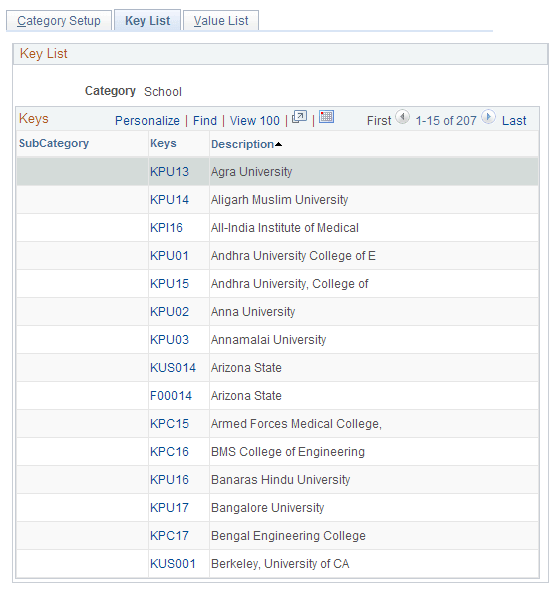

Key List Page
Use the Key List page (HRS_DM_CAT_KEYLIST) to view key lists.
Navigation:
Set Up HCM, and then Product Related, and then Recruiting, and then Utilities, and then Data Mapping Categories, and then Key List
This example illustrates the Key List page.
Key List page
Field or Control Description
Subcategory
Serves as a secondary key for the data mapping functionality. Not all categories use the subcategory secondary key. Subcategories themselves must also be data mappings.
Keys
Displays the primary key for the category. These keys are determined by the data in the associated data mapping category tables. Click the key link to access the Key Data Mapping page. This page displays all the values that are mapped to the given key.

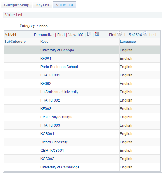

Value List Page
Use the Value List page (HRS_DM_CAT_VALLIST) to view value lists.
Navigation:
Set Up HCM, and then Product Related, and then Recruiting, and then Utilities, and then Data Mapping Categories, and then Value List
This example illustrates the Value List page.
Value List page
The Value List page lists all the values that are being mapped to a category key. Click a link in the Keys column to access the Value Data Mapping page.

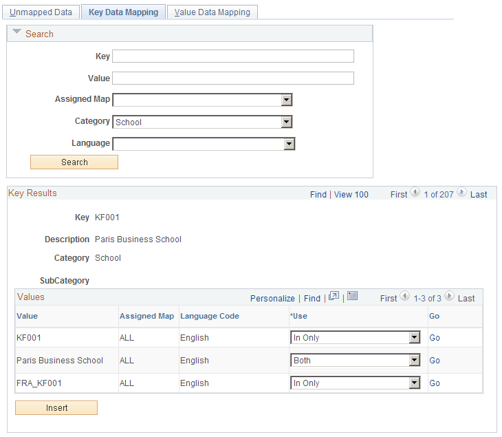

Key Data Mapping Page
Use the Key Data Mapping page (HRS_DM_MAPING_DICT) to map keys.
Navigation:
Set Up HCM, and then Product Related, and then Recruiting, and then Integration, and then Data Mapping, and then Key Data Mapping
This example illustrates the Key Data Mapping page.
This page displays a complete list of all the values that are mapped to a given key.
Values
This group box enables you to add other values to the key. The values must be chosen from the unmapped data values.
Value
Select the values that are associated with the key.
Assigned Map
Select the data mapping assignment that the key is associated with.
Language Code
Select the language that the value is assigned to
Use
Select to use this data mapping for incoming data, outgoing data, or both.
Insert
Click to add a row to the group box.

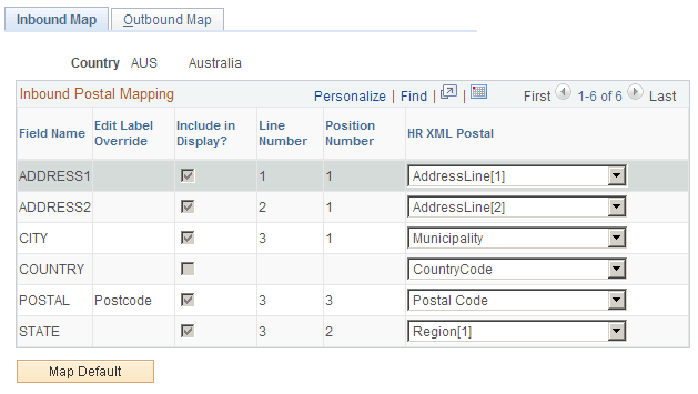

Inbound Map Page
Use the Inbound Map page (HRS_HRXML_PSTL_IN) to map inbound postal information.
Navigation:
Set Up HCM, and then Product Related, and then Recruiting, and then Integration, and then Postal Map, and then Inbound Map
This example illustrates the Inbound Map page.
Inbound Map page
This page displays the field names that are associated with the Country table.
HR XML Postal
Select the XML element where you want the corresponding PeopleSoft field to be written for incoming messages.
Map Default
Click to have the system make an initial guess at what the mapping from the XML should be.

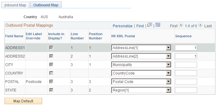

Outbound Map Page
Use the Outbound Map page (HRS_HRXML_PSTL_OUT) to map outbound postal information.
Navigation:
Set Up HCM, and then Product Related, and then Recruiting, and then Integration, and then Postal Map, and then Outbound Map
This example illustrates the Outbound Map page.
Outbound Map page
This page displays the address field names that are associated with the Country table.
HR XML Postal
Select the XML element where you want the corresponding PeopleSoft field to be written for outgoing messages.
Map Default
Sequence
When multiple data elements from the PeopleSoft address table are mapped to a single element in the XML document, the sequence number determines the order in which the PeopleSoft fields are mapped.
