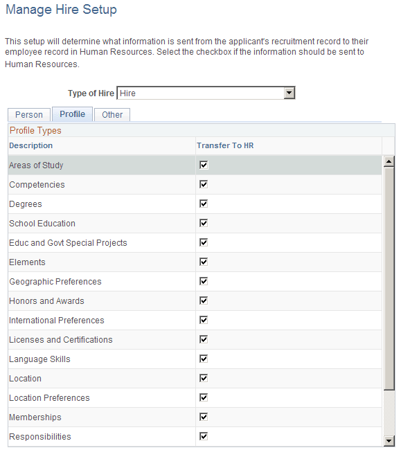

Profile
Select the Profile tab.
This example illustrates the Profile tab of the Manage Hire Setup page.
Manage Hire Setup page: Profile tab
The Profile tab lists profile content types that have been set up for applicants. The specific content types depend on your configuration, but examples might include competencies, licenses and certificates, and language skills.
Select the check boxes for the types of profile information that the system is to include when sending the applicant's data to the human resources system.
