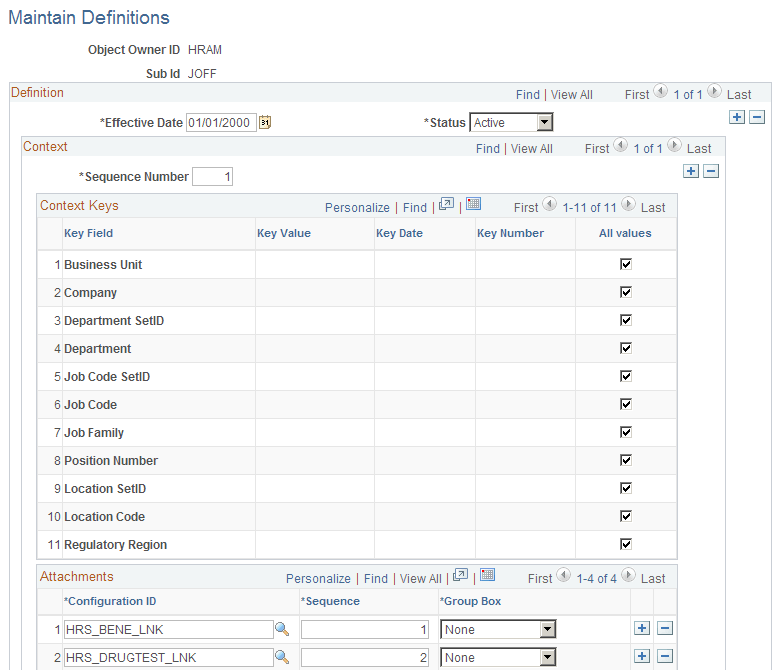

This illustration shows the Maintain Definitions page for the HRAM owner ID. In this illustration, the All Values check box is selected for all of the context keys, so the listed attachments will be available for all job openings, regardless of the business unit, company, and so forth.
Maintain Definitions page showing the context keys for job offers attachments
To add attachments that are available for just one specific business unit, you would create an additional row in the Context scroll area, deselect the All Values check box for the Business Unit key field, and enter the specific business unit for the context. You would then add the business unit-specific attachments to the Attachments grid.
