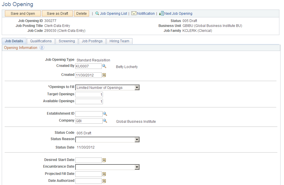

This example shows the first few fields of a draft job opening as a hiring manager would see it without the benefit of a flexible job creation process. Many more fields appear after the ones shown here.
Example of a draft job opening with all fields visible

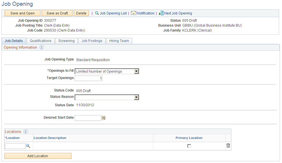

This example shows a draft job opening as a hiring manager would see it when the flexible job creation process shows hiring managers a small subset of the job opening fields. Note that the flexible recruiting process does not hide tabs even when the user cannot see any fields on a tab.
Example of the flexible job creation process limiting the fields that a hiring manager sees

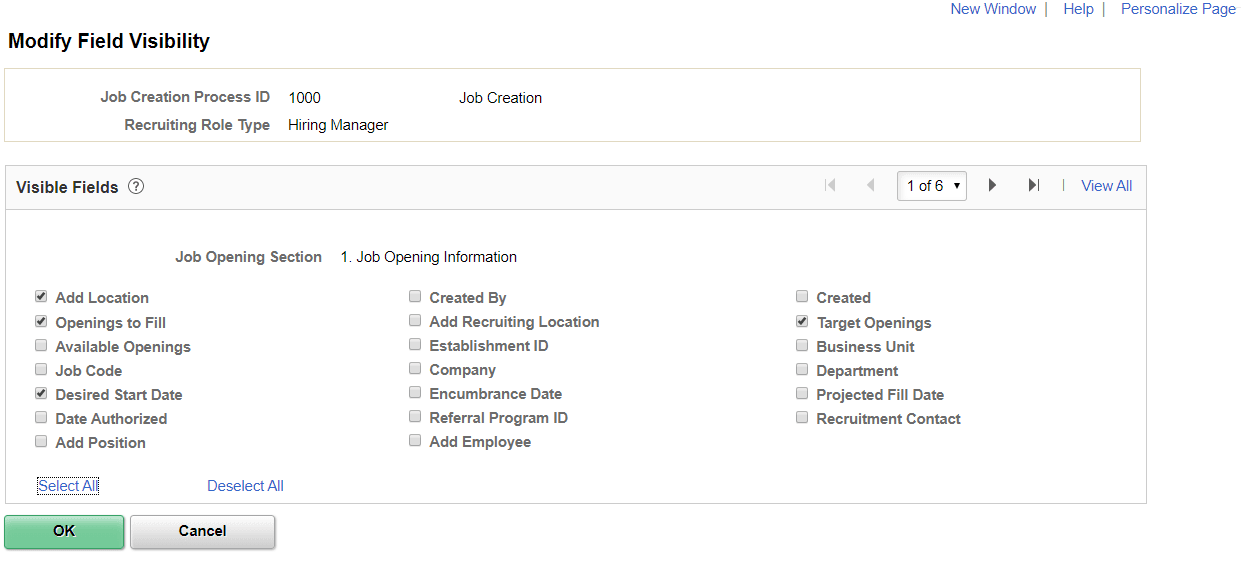

Section 1: Job Opening Information
This section includes fields and grids from the Opening Information group box on the Create Job Opening page.
This section does not include check boxes for certain fields, including:
  • The Job Opening ID and Job Opening Type, which are always visible and never editable.
  • The Template ID field, which is visible only to recruiting administrators.
  • The Status Code, Status Reason, and Status Date fields.
  • The Job Family field, which is visible only if your template segmenting type is Job Family, in which case this field is always visible and never editable.
Note: If you display the Business Unit, Job Code, and Department fields and the Recruiting Locations grid, uses can make changes that affect which flexible process template governs the job opening. However, the system does not apply the new template until the next time the Job Opening page is opened.

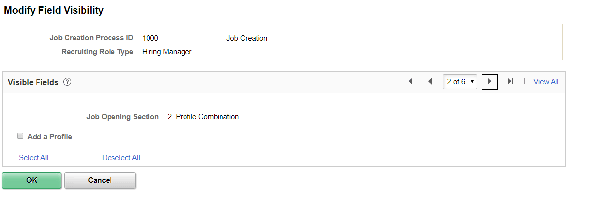

Section 2: Profile Combination
This section has a single check box that controls access to the Profile Combination grid, which displays the profiles whose content items were copied into the job opening.

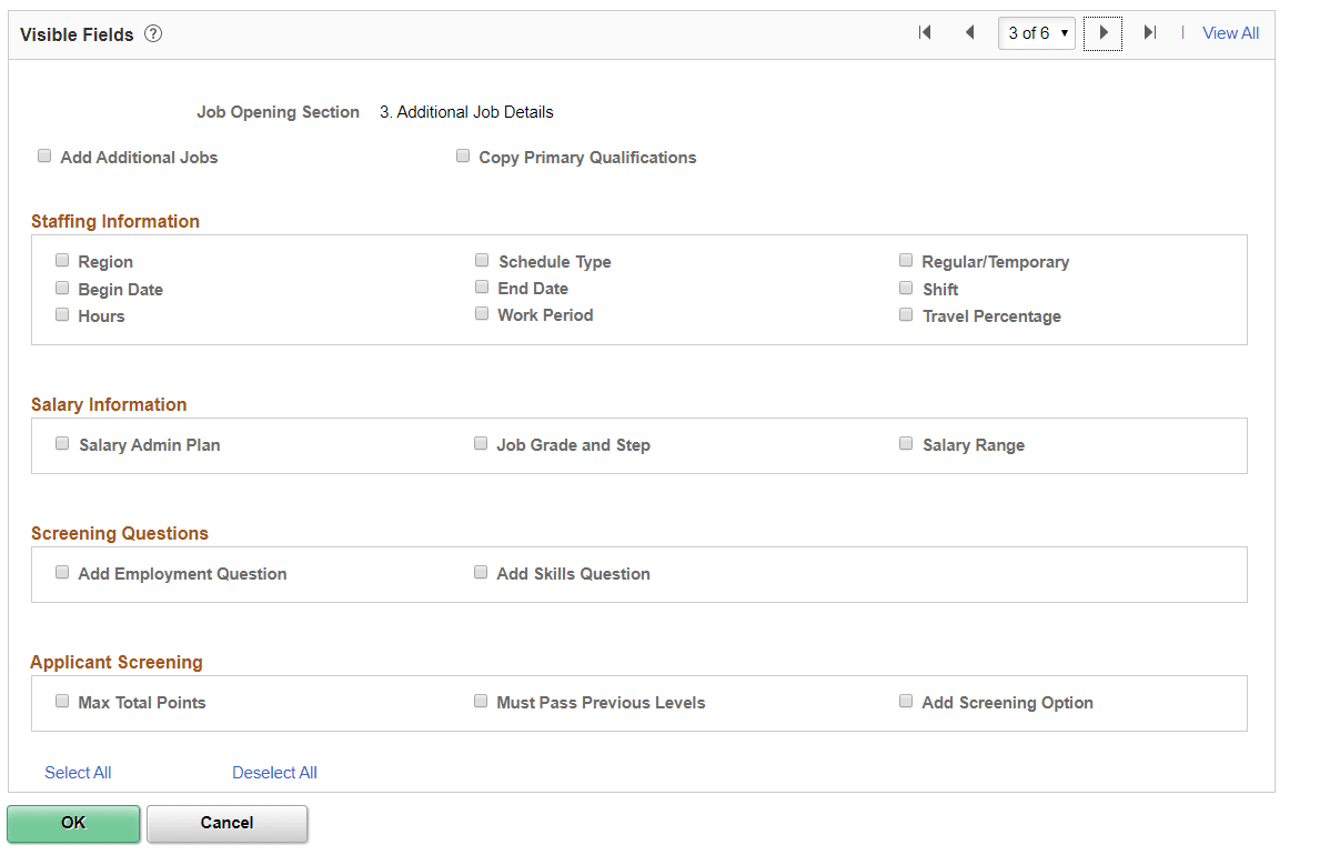

Section 3: Additional Job Details
This section includes check boxes to control the fields and grids from the Staffing Information, Salary Information, Screening Questions, and Applicant Screening group boxes on the job opening page. These check boxes have the following specialized processing:
  • The Job Grade and Step check box controls the following fields: From Grade, From Step,To Grade, and To Step.
  • The Salary Range check box controls the following fields: Salary Range From, Salary Range To, Pay Frequency, and Currency fields. In US Federal implementations, it also controls the PATCOB Code field.
  • (USF) The Competitive Ranking and Non-Competitive Ranking check boxes control all fields in the Competitive and Non-Competitive group boxes in the Applicant Screening section of the job opening.
If the Allow Multiple Jobs/Positions option is activated in the Recruiting Installation component, this section also includes two additional check boxes:
  • Add Additional Jobs controls whether users can add or delete job codes.
  • Copy Primary Qualifications controls access to the Copy Qualifications from Primary Job Code button.
