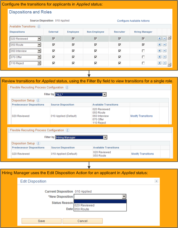

When you set up a recruiting process, you define valid disposition transitions for each recruiting role type. For example, you might allow recruiters, but not hiring managers, to manually move an applicant from the Applied disposition to the Reject disposition. In this example, Applied is called the source disposition, and Reject is called the target disposition.
You can also configure different transition rules for different types of applicants (internal, external, and non-employees).
When you set up valid transitions for a particular role, you cannot have gaps in the process. For example, if hiring mangers cannot manually transition applicants into the Interview disposition, then they also cannot manually transition applicants out of the Interview disposition. Even if you inadvertently configure the process to allow hiring managers to manually transition applicants out of the Interview disposition, the Edit Disposition action will not allow it.
If an applicant’s current disposition does not have any valid transitions for a particular recruiting role type, then users with that role type do not have access to the Edit Disposition action for that applicant. For example, if hiring managers have no valid target dispositions for the Offer source disposition, then hiring managers will not see the Edit Disposition action for applicants in the Offer disposition.
This example illustrates a recruiting process that limits hiring managers to two target dispositions when the source disposition is Applied. First, you see the configuration page for defining valid targets. Next, you see the read-only grid that summarizes available transitions, first for all users and then filtered to show only hiring manager transitions. Finally, you see the Edit Disposition dialog box limiting the hiring manager to the two specified targets.
Example of using a recruiting process to define allowable transitions

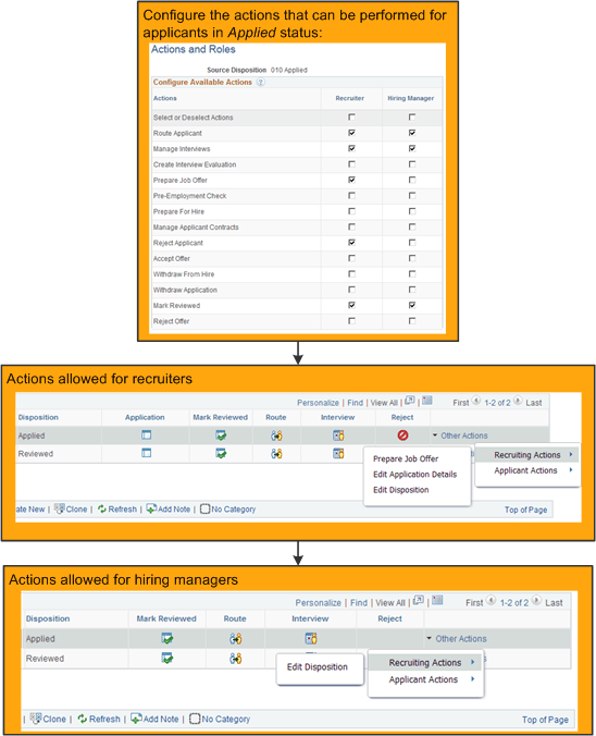

A flexible recruiting process controls action availability based on an applicant’s disposition. For example, if an applicant is in an Offer disposition, a flexible recruiting process could limit recruiters to the Accept Offer and Reject Offer actions, while not allowing hiring managers to perform any actions.
The recruiting process applies to only a subset of actions, including:

This example illustrates the use of a flexible recruiting process to limit the actions that can be performed on applicants in the Applied disposition. The example shows the configuration page for defining valid actions, then shows the results of the configuration for both recruiters and hiring managers. In this example, the Application icon and the Edit Application Details menu command are shown to the recruiter but not to the hiring manager. These page elements are not controlled by the flexible recruiting process. Rather, they are shown only to users who have standard PeopleTools security access to the pages that are accessed through these commands.
Example of using a recruiting process to limit available actions
Note that if an action (such as Reject) is normally performed by clicking an icon, the icon is hidden rather than disabled when the action is not allowed. If a user cannot perform the action for any of the applicants in the grid, the entire column is hidden.

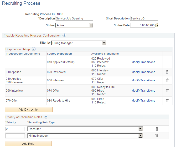

Use the Recruiting Process page (HRS_RP_DEFN) to specify applicant dispositions for which you will configure allowable actions and allowable disposition transitions.
Navigation:
Set Up HCM, and then Product Related, and then Flexible Processes, and then Recruiting Process, and then Recruiting Process
This example illustrates the Recruiting Process page.

Use the Filter By drop-down list box to control the information that appears in the Disposition Setup grid, where you can see the dispositions transitions that the recruiting process allows. Because transitions rules can be different for users with different recruiting role types, filtering by role type helps you see the complete set of transitions allowed for particular types of users.
Select a recruiting role type to view the transitions associated with that role type, or select *ALL* to remove the filter and see all available transitions without regard for which users can perform the transitions.
Disposition Setup
When a user manually changes an applicant’s disposition, the starting disposition is the source disposition, and the newly assigned disposition is the target disposition. To define valid transitions, you list the valid targets for each possible source.
Flexible recruiting processes allow users to move applicants both forward and backward in the recruiting process. This means that the Edit Disposition action lists both predecessor and target dispositions as available options. For example, if Reviewed is a target of Applied, then the Edit Disposition page for applicants who are currently in the Reviewed disposition includes Applied as a possible new disposition, along with the dispositions that are configured as targets of Reviewed.
The Disposition Setup grid displays a row for each source where you have defined valid transitions. The first row is always the disposition that is configured as the system-wide default on the Recruiting Status Area Page. This disposition is assumed to be the usual starting point of your recruiting process, and you cannot delete this row.
