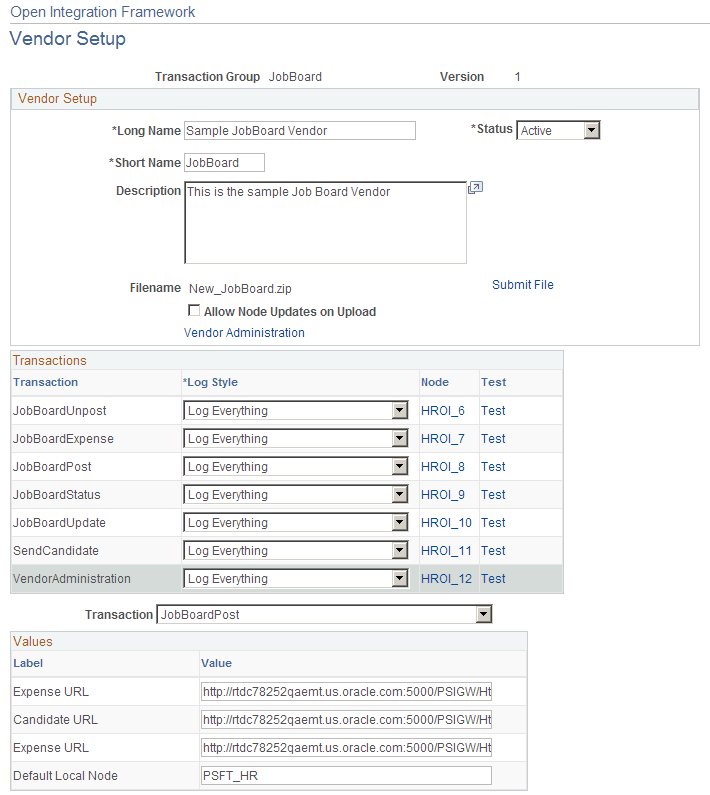

Vendor Setup Page
Use the Vendor Setup page (HRS_VENDOR_FILE) to load a new vendor configuration file, or view and modify details after loading a vendor configuration file.

This example illustrates the Vendor Setup page after loading vendor configuration file.

Vendor Setup Fields
When you access an existing vendor, or after you upload the configuration file for a vendor that you are adding, the page displays vendor setup fields.
The Vendor Setup and Transactions group boxes are automatically populated with the information that is provided in the configuration file. The transactions that appear in the Transactions group box are those that are defined on the Open Integration Framework - Transaction Group Setup page for the transaction group that is associated with the vendor configuration file.
Vendor Setup
Field or Control Description
Status
Indicate whether the vendor is Active or Inactive.
Allow Node Updates on Upload
The node definitions are set up by the process of loading the vendor configuration file. If subsequent loads of the file are necessary (perhaps a customer gets an updated configuration file from the vendor), the Allow Node Updates on Upload check box enables the user to update the node definition or keep allowing the nodes to be updated.
Vendor Administration
Click to access the vendor's administration page. Not all vendors will support this option.
Extended Setup
Click to access the Pre-Employment Vendor Setup page, where you can define settings for pre-employment vendors. This link appears only for vendors in the PreEmployment transaction group, based on the setup in the Extension Configuration group box on the Open Integration Framework - Transaction Group Setup page.
Transactions
Log Style
Defines when to log messages on the Integration Log page. Values are:
Log All: An entry is entered into the integration log every time a message is received from the vendor.
Never Log: An entry is never made to the integration log.
On Error: An entry is made to the integration log only when an error occurs.
Node
Displays the node name that is associated with the vendor's transaction. These node names are dynamically created. Click a node link to access the Connectors page in PeopleTools Integration Broker.
Test
Click to access the Integration Test page, where you can test the integration setup for outgoing messages. The Test links do not apply to incoming transactions.
