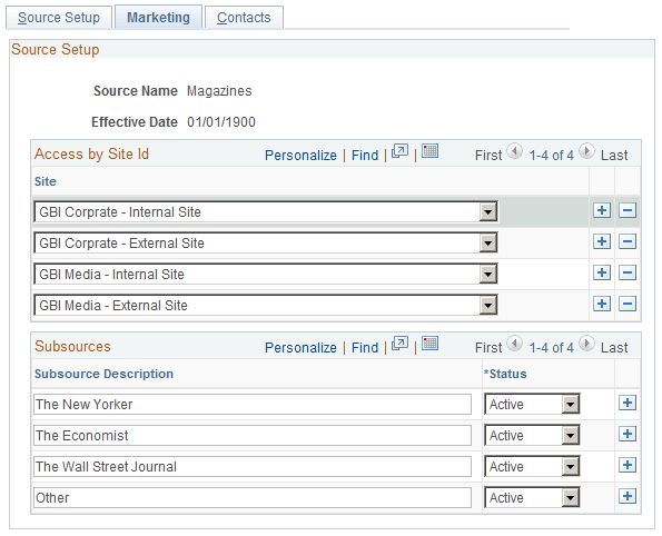

Recruitment Sources - Marketing Page
Use the Recruitment Sources - Marketing page (HRS_SOURCE_MKT) to define sites and subsources for marketing recruitment sources.
This page appears only for recruitment sources with the source type Marketing.
Navigation:
Set Up HCM, and then Product Related, and then Recruiting, and then Recruitment Sources, and then Marketing
This example illustrates the Recruitment Sources - Marketing page.
Access by Site ID
Use this grid to specify which Candidate Gateway sites list this recruitment source as a valid referral source. For example, if you are defining a recruitment source for your internal employee newsletter, you would associate that source with the internal sites used by the employees who receive that newsletter.
Once a source is associated with a site, applicants who apply for jobs on that site can select that source in the How did you find out about us? field in the online application form (if the resume template includes the Referrals section).
Subsources
Use this grid to define subsources for marketing sources. When a user selects a source on the online application pages in Candidate Gateway (or on the Load Resume - Prepare Load Parameters page), the user also can select a subsource from a list of values that you define here. Only active subsources appear as valid options.
