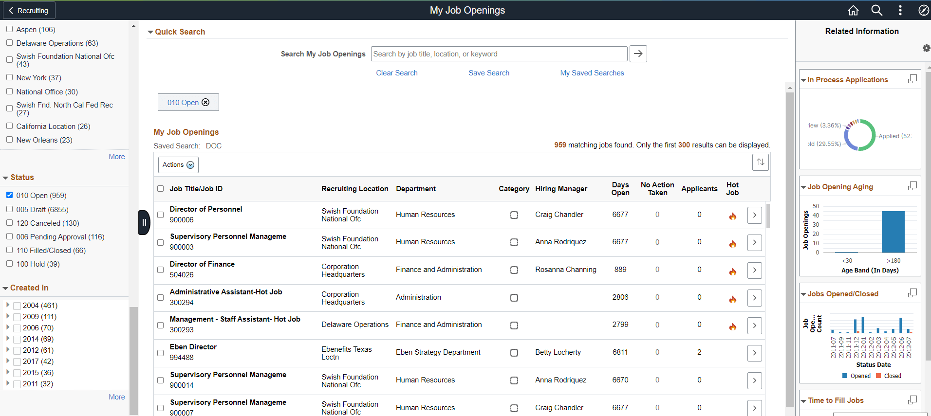

My Job Openings Page
Use the My Job Openings page (HRS_PE_MY_JOBS_FLU) to view a list of job openings for the recruiting user.
Navigation:
Click the My Job Openings tile on the delivered Fluid Recruiting Homepage.
This example illustrates the My Job Openings page.
Left Panel
The left panel lists different facet filters to refine the job openings associated with the Recruitment/Hiring team. Available filters are:
  • My Association: The available filters based on for your association with the job opening are: Created By Me, Hiring Manager, Primary Hiring Manager, Recruiter, Primary Recruiter, and Team Member. Team members include approvers as well as the members of the job opening hiring team. The Hiring Manager filter shows job openings where you are the primary or non-primary hiring manager. Similarly, the Recruiter filter shows job openings where you are the primary or non-primary hiring manager.
  • Department: Use this facet to filter based on the job opening’s department.
  • Hiring Manager: Use this facet to filter based on the job opening’s primary hiring manager. Non-primary hiring managers are not considered.
  • Recruiter: Use this facet to filter based on the job opening’s primary recruiter. Non-primary recruiters are not considered.
  • Job Family: This facet offers hierarchical filtering based first on job family and then, after you select a job family, based on the job codes that are associated with the selected job family.
  • Location: Use this facet to filter based on the job opening’s location.
  • Status: Use this facet to filter based on the job opening status.
  • Created In: This facet offers hierarchical filtering based first on the year that the job opening was created and then, after you select a year, based on the month that the job opening was created.
Select the required filter criteria and search for the job opening.

My Job Openings
This grid displays all job openings for the recruiting user that meet the filter criteria. By default, the My Job Openings list displays the recent Job IDs at the top of the list, except for hot jobs. When there are hot jobs in the list, they are always displayed at the top.
Field or Control Description
Sort Sort button
Use this button to sort job openings based on Job Title, Job ID (the default value), Recruiting Location, Category, Hiring Manager, Days Open, No Action Taken and Applicants.
Job Title/Job ID
Displays the job opening’s primary posting title and the Job Opening ID.
Recruiting Location
The location represents the job opening’s recruiting location rather than its physical location. If a job opening has multiple recruiting locations, the primary location appears.
Department
This displays the department for the job opening.
Category
If job categorization is enabled on the Recruiting Installation – Jobs Page, this column displays the category for the job opening. Categories are a personal organizational tool, and your categorization is not visible to other users.
You can click the Category icon to access the Job Categories modal window and select your categories from there. You can also personalize your job category sort order, status and description by clicking the Personalize Job Categories link in this modal window.
Hiring Manager or Recruiter
This column displays either the job opening’s primary hiring manager or the job opening’s primary recruiter, depending on the roles assigned to the current user.
Days Open
For job openings in an open status, this column displays the number of days since the job opening’s earliest posting date. If the job has never been posted, this field displays the number of days since the job opening was created. If the earliest job posting date (or, if none, the job creation date) is in the future, the system displays 0.
No Action Taken
Displays the number of applicants in the Applied phase. Click this number to access the Manage Job Opening page pre-filtered to show only applicants in this phase.
Applicants
Displays the number of applicants in the Applied phase. To view these applicants, click the job opening to access the Manage Job Opening page, then click the Applied phase on the phase filter to show only applicants in the Applied phase.
Hot JobHot Job
Displays the hot job icon for any jobs that are hot jobs. This column is hidden entirely if none of the job openings are hot jobs.
Chevron
Click the chevron icon to access the Manage Job Opening Page.
