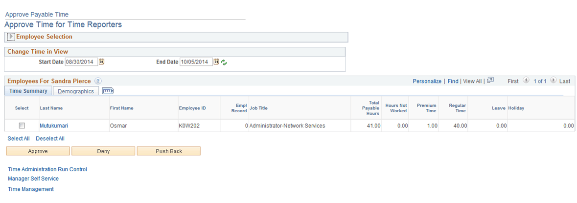

Approve Payable Time - Approve Time for Time Reporters Page
Use the Approve Payable Time - Approve Time for Time Reporters page (TL_MNG_APRV_SRCH ) to approve time for one or more time reporters that are displayed using the Employee Selection Criteria and date range fields.
Navigation:
  • Time and Labor, and then Approve Time, and then Approve Payable Time, and then Approve Payable Time - Approve Time for Time Reporters
  • Manager Self Service, and then Time Management, and then Approve Time and Exceptions, and then Approve Payable Time, and then Approve Payable Time - Approve Time for Time Reporters
This example illustrates the fields and controls on the Approve Payable Time - Approve Time for Time Reporters page. You can find definitions for the fields and controls later on this page.
Time must be processed through Time Administration and have a payable status of Needs Approval.
The Approve Payable Time - Approve Time for Time Reporter page offers manager the capability to refine their search including groups, employee IDs, a certain date range, or many other criteria, or simply to return all the employees for whom they have approval authority and who have payable time that needs approval. After the manager enters the search criteria and clicks the Get Employees button, the result list displays below the Employee Search Criteria and Date fields.
The manager can then select one or more employee rows and click the Approve button to approve the payable time. Alternatively, the manager can click the employee name link to view and approve each employee's payable time entries.
See Understanding Manager Self-Service Components.
Employee Grid
The columns Select, Name and Total Payable Hours are always displayed. The fields selected in the Include in List column on the Manager Search Options page are also displayed.
See Setting Up User Preferences.
Field or Control Description
Select
Select this check box next to the time reporter's name to approve payable time.
Name
Click on the individual time reporter's link to view details of their time entry from the Approve Payable Time page.
Total Payable Hours
Displays the total number of related hours that require approval.
Each row of the grid displays the Total Payable Hours for a time reporter. In Time and Labor, you keep such things as shift differentials and shift bonuses (compensation only hours) separate from the actual hours of effort reported. The actual hours are based on the daily time records that the system has created (that is, compensation only hours are not included). Total hours, (or Total Amount or Total Units) represent all hours (amounts or units) for that day, including compensation only hours, amounts, or units.
Select All, Deselect All
Click Select All to select all the time reporters displayed for approval.
Click Deselect All to deselect all rows.
Approve
Click this button to approve the selected time reporters' payable time.
Deny
Click this button to deny the selected time reporters' payable time.
Push Back
Click this button to push back the selected time reporters' payable time.

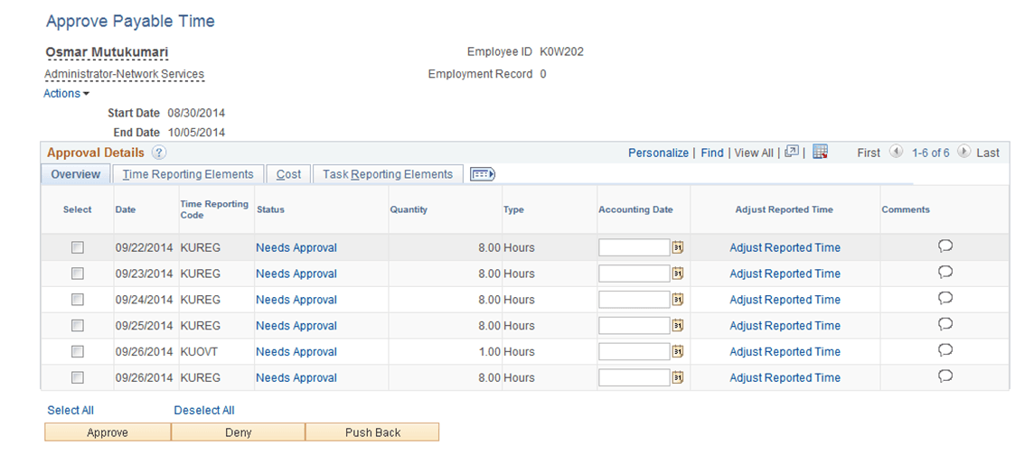

Approve Payable Time Page
Use the Approve Payable Time page (TL_MNG_GRP_APPROVE ) to view and approve separate time entries for an individual time reporter.
Navigation:
On the Approve Payable Time - Approve Time for Time Reporters, click the time reporter's Last Name link to view details of the entry.
This example illustrates the fields and controls on the Approve Payable Time page. You can find definitions for the fields and controls later on this page.
Select the check box in the Select column next to the rows that you want to approve. The system displays all data for the payable time in the appropriate field. If no data exists for the field, it is blank.
Select the Time Reporting Elements, Cost, or Task Reporting Elements tabs to view additional details about the time that needs approval.
Adjust Reported Time
Click this link to display the Timesheet page that enables you to adjust the time reporter's reported time.
Comments
Click the icon in this column to add or view a comment related to an incidence of time. Click the Save button on the Comments page, and then the OK button to confirm the save and display the Approve Payable Time page.
Note: The appearance of the icon in this column changes if a comment is attached to that row.
