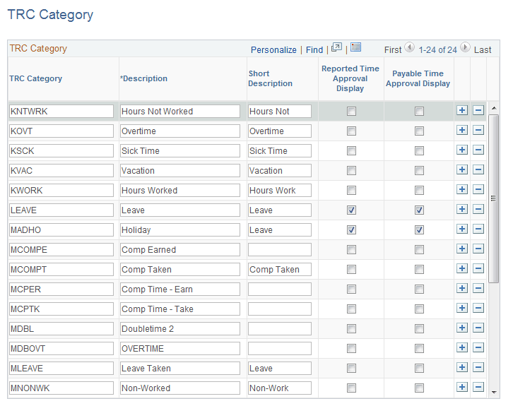

Use the TRC Category page (TL_TRC_CATEGORY) to define TRC Categories.
Navigation:
Set Up HCM, and then Product Related, and then Time and Labor, and then Time Reporting, and then TRC Category, and then TRC Category
This example illustrates the fields and controls on the TRC Category page. You can find definitions for the fields and controls later on this page.
TRC Category page
Field or Control Description
Reported Time Approval Display
Check to display the category on the Reported Time Approval page. You can only check up to 3 (three) categories to display.
Payable Time Approval Display
Check to display the category on the Payable Time Approval page. You can only check up to 3 (three) categories to display.
The Timesheet configuration is still set on the TL Installation table but a note on the TRC Category page lets you know that all categories that have time reported to them will appear on the Timesheet and that you need to go to the TL Installation table to disable.
