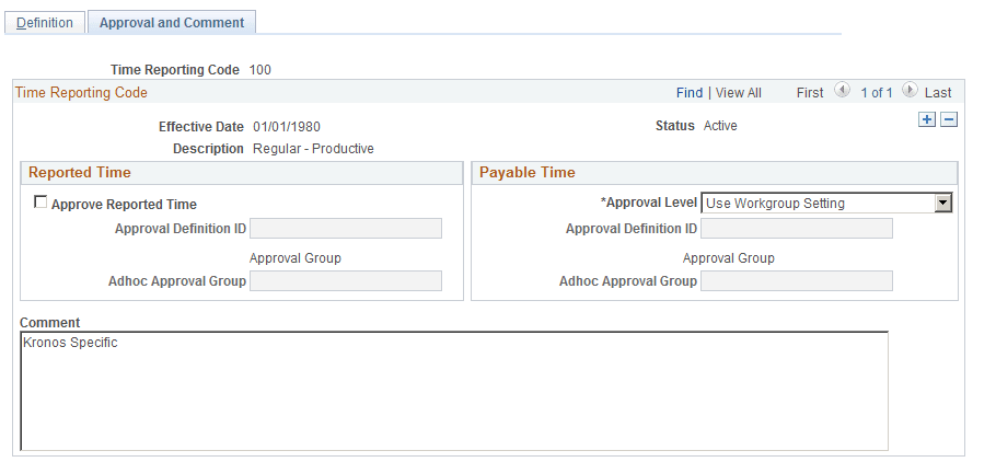

Time Reporting Codes - Approval and Comment Page
TL_TRC_PNL2
Set up compensation and interface options and enter optional comments.

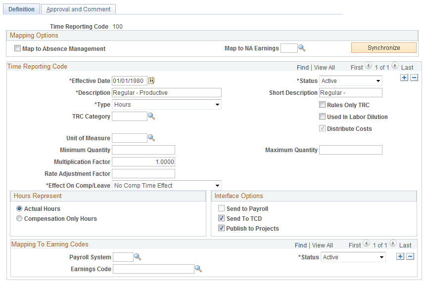

Time Reporting Codes - Definition Page
Use the Time Reporting Codes - Definition page (TL_TRC_PNL1) to define Time Reporting Code attributes and map TRCs to earnings codes.
Navigation:
Set Up HCM, and then Product Related, and then Time and Labor, and then Time Reporting, and then Time Reporting Codes - TRC, and then Definition
This example illustrates the fields and controls on the Time Reporting Code - Definition page. You can find definitions for the fields and controls later on this page.
Before mapping a TRC to a Global Payroll Take code or earnings code, you must have a User Roles Profile that is set up in the Global Payroll system in order to view these codes.
Field or Control Description

Status
Select an Active or Inactive status for this TRC. The default is Active. A row that is synchronized with a NA earnings code always defaults to Active and is unavailable for entry.
Type
Select a TRC Type from the drop-down list. Valid values are Amount, Hours, or Units. If you select a Type of Amounts you cannot enter a rate in the Rate field; also the Rate Adjustment Factor and Multiplication Factor will become unavailable for entry. Only a TRC Type of Hours can be used for Labor Dilution.
Rules Only TRC
Select this check box to denote a TRC as being used only by Rules in Time Administration.
This table provides the valid TRC Type combinations with Earnings Types, Comp Rate Code Types, and TL Quantities.
TRC Category
Use this field to specify whether to group this TRC in a TRC category. For example, the TRC of REG could be assigned to a TRC Category of Time Worked.
Only one category can be assigned to a TRC.
Note: This field only appears if a value of Hours is selected for the Type field. In addition, on the TL Installation table, the Display Reported Hours Summary field must be selected to show TRC Categories on the Approve Payable Time page, and/or the Time Reporting page.
Currency Code
Select the Currency Code for an Amount TRC type. If you change the Currency Code for this TRC, all quantities in payable time from the time of the change associated with this TRC will reflect the new currency code. The Currency Code element only appears and is valid for Amount TRC types.
Used in Labor Dilution
Select the Used in Labor Dilution check box if you want this TRC to be used during Labor Dilution. You must select a TRC Type of Hours: otherwise this check box is unavailable for entry. If you change this field to selected, all time associated with this TRC will be diluted as of the effective date. Time that has already been distributed will not be diluted. If you select this check box, the system also selects the Distribute Costs check box and it will be unavailable for entry.
Unit of Measure
Select a unit of measure if you entered Units in the Type field. The Unit of Measure field needs to be populated if you are integrating with PS Projects and PS EPM, whether it is an Hours or Units type TRC. This field also needs to be populated as it is included with payable time when sent to PS Projects and PS EPM, for further rate processing in these other products.
Distribute Costs
Select this check box if the TRC will participate in the Labor Distribution process when costs are returned from a payroll system. During the synchronize process with a NA earnings code, the value of this field will default from the Add to Gross option on the NA earnings code. You can change this value after the sync process. In most cases, earnings add to gross pay. However, certain types of earnings may not. One example is an earnings that is not a monetary payment, such as the value of a company-supplied automobile. Because the company supplies the employee with a car and not the money to buy one, these earnings should not add to gross.
Minimum Quantity
Use this field to define your limits for time entry for any TRC type. For example, if you set the value in this field to 4, and a user reports a value of 2, the system will generate an exception stating that the amount is below the minimum for this TRC. This field should not be used if the TRC is synchronized with a Flat Amount NA earnings code.
Maximum Quantity
Use this field to define your maximum limits for time entry for any TRC type. For example, if you set the maximum to 8, and a user reports 10, the system will generate an exception stating that the amount is above the maximum for this TRC. This element should not be used if the TRC is synchronized with a Flat Amount NA earnings code.
Use this field to calculate hourly earnings, such as overtime or double time, for which the earnings are multiplied by a specific number or factor, such as 1.5 for overtime, 2.0 for double time, and so on. If you change the value in this element, the system will display a message indicating that this change may invalidate estimates that are already calculated. This element is factored into the calculation of estimated gross for Hours and Units TRC types.
Use this field to establish a dollar amount to apply to adjustments in pay rates. For example, if your union negotiated a $0.30 per hour cost of living adjustment, you would enter 0.3 in this field for any applicable earnings, such as regular, overtime, vacation, and sick. Any employee getting any one of these types of earnings will be paid $0.30 per hour, in addition to the compensation rate specified on the job record. This element is factored into the calculation of estimated gross for Hours and Units TRC types.
Flat Amount
This field only displays if you are synchronizing your TRC to a NA earnings code with a Flat Amount payment type. This is to assist you in knowing how the earnings will be paid if your are using NA Payroll. If you report a quantity that differs from the defined Flat Amount, you can include a delivered rule in your rule program that will replace it with the defined Flat Amount on the TRC.
The system handles this field differently based on your synchronize selections. See the table under Synchronizing TRCs With NA Earnings Codes for a description of these differences.
Rate
This field only displays if you are synchronizing your TRC to a NA earnings code with a Unit/Override payment type. This is to assist you in knowing how the earnings will be paid if you are using NA Payroll. If you report an Override Rate that differs from the defined Rate, you can include a delivered rule in your rule program that will replace the Override Rate with the defined rate on the TRC.
This element is factored into the calculation of estimated gross for Hours and Units type TRCs.
The system handles this field differently depending on your Sync elections. See the table under Synchronizing your TRCs With NA Earnings Codes for a description of these differences.
Effect on Comp/Leave
Valid options are No Comp Time Effect, Comp Time Earned, Comp Time Taken, Leave Taken and Avoid Replacing by Rules:
  • Select Comp Time Earned if you want this TRC to be used for earnings for comp time that are in lieu of overtime. You should map your Comp Time Earned TRC to a NA earnings code that does not add to gross pay.
  • Select Comp Time Taken if you chose to map to a NA earnings code that adds to gross pay.
    Note: Comp Time Earned and Comp Time Taken TRCs can be associated to a Compensatory Time Off plan in order for them to be displayed in the Weekly reporting pages. They must exist in the time reporter's TRC program and assigned Comp Plan in order for compensatory time off to be validated correctly.
  • Select Leave Taken for TRCs such as vacation, sick, or leave time. In order for the system to process Leave Time correctly, make sure you map the Leave Taken TRC to a NA Earnings code that has one of these payment types: Either Hours or Amounts, Hours Only, or Both Hours and Amounts. You must ensure that your NA earnings code is associated to a Leave Plan type and you have selected the Taken check box under the Add to Accrual Balance section of the earnings code setup. Also make sure the time reporter is assigned to a Leave Plan type of Sick, Vacation, or whatever Leave Plan type you want to use, as well as having the association to a specific leave plan.
  • Comp Time Earned, Comp Time Taken, or Leave Taken TRCs must have a TRC Type of Hours. You cannot change these values if the TRC is attached to an active comp time plan. If the time reporter enters a negative amount for Comp Time Earned or Comp Time Taken, the system considers it an adjustment. If the Time Reporter enters a negative amount for Comp Time Taken, the system creates a refund for the time reporter's balance. If the time reporter enters a negative amount for Comp Time Earned, the system will deduct the amount from the time reporter's balance.
  • The Avoid Replacing by Rules value gives users control over TRCs that should or should not be reduced as a result of daily or weekly overtime rules. Users need to change the TRCs eligible for rules processing but not eligible for reduction as a result of replacing rules (overtime, holiday , jury duty and so).
Note: If the TRC is an absence TRC, then the Effect on Comp/Leave field is set to None, as absences reported in Absence Management are not validated.
Hours Represent
Actual Hours
Select this option to specify that the reported hours represent actual hours worked.
Compensation Only Hours
Select this option to specify that the reported hours represent compensation only hours. For example, in administering overtime, you may define a rule stipulating that an employee is entitled to time and a half for all hours worked beyond eight. So, if employees work ten hours, they get a premium for the 2 extra hours worked—the premium being the "half" of "time and a half." In this scenario, you want to be able to report the premium hours as compensation only hours. For Units and Amount TRCs, select this option.
These options provide information only for the time that is reported and are not used in rules processing. You can use these options for reporting purposes.
Interface Options
Send to Payroll
The system selects this check box if any earnings code is mapped to the TRC; if one is not, the system clears it. The system only extracts payable time for a pay system that has the Send to Payroll check box selected.
The system uses this flag to determine what time should be closed that is not going to a payroll system. Time Administration sets the time to a Needs Approval payable time status.
See Workgroup - Definition Page.
If the TRC is synchronized with a NA earnings code and you decide to inactivate or delete a row on the NA earnings code, we recommend that you re-synchronize the TRC so that the attributes such as this flag are kept correctly synchronized.
Send to TCD
Select this flag if you want this TRC sent to your Time Collection Device (TCD). You attach a TRC Program to a TCD and if the TRC is part of that TRC Program, it will get sent to your TCD.
Publish to Project Costing
Select this field if you want your TRC sent to the Project Costing application.
Mapping TRCs to Earning Codes
Access the Mapping to Earning Codes group box.
Payroll System
Select the Payroll System from which you want to select an earnings code and ultimately map to the TRC. If you entered a value in the Map to NA Earnings Code field and synchronized, the system automatically populates this element. You can choose to map this TRC to several payroll systems by inserting a new row and entering the appropriate data. The values for the payroll system default from the values you set up on the Pay System Options page. You don't have to save the page and return to establish a TRC relationship with multiple payroll systems.
Earnings Code
If you entered a value in the Map to NA Earnings Code field and synchronized, the system automatically populates this field, making it unavailable for entry. The values displayed in the drop-down list depend on the Payroll System that you have selected. If you chose NA, the list comes from the Payroll for North America Earnings Code table, if you selected GP, the values come from the Global Payroll Earnings Code table.
Note: When you manually map a TRC to a GP code, we only display active Earnings and Take codes. If you need to inactivate a Pin code on the payroll side after mapping a TRC, you need to look at the TRCs to which the code is attached and inactivate the mapping here. The same is true if you manually map a TRC to a NA earnings code.
You can also use this element to establish a TRC that calculates Estimated Gross a different way than how the NA earnings code may be paid. In this case, you would not use the synchronize feature for mapping the TRC to a NA earnings code.
Status
Select a Status for the earnings code mapped to this TRC. Valid values are Active and Inactive. If you entered a value in the Map to NA Earnings Code field and synchronized, the system automatically populates this field, making it unavailable for entry. If you manually choose a payroll system and earnings code, the system populates this field with the status of the earnings code, which you can change, if necessary. If you change the status to Inactive, you are inactivating the relationship between the TRC and earnings code. You are not inactivating the TRC itself.
If the status of the earnings code mapped to the TRC changes, the system automatically displays the changed status of the earnings code in this field for TRCs synchronized with NA Payroll earnings codes. You have to manually change the status for TRCs mapped to Global Payroll or other pay systems.
Use the Time Reporting Codes - Approval and Comment page (TL_TRC_PNL2) to set up compensation and interface options and enter optional comments.
Navigation:
Set Up HCM, and then Product Related, and then Time and Labor, and then Time Reporting, and then Time Reporting Codes - TRC, and then Approval and Comment
This example illustrates the fields and controls on the Time Reporting Codes - Approval and Comment page. You can find definitions for the fields and controls later on this page.
Approve Reported Time
Select this check box if a manager's approval is required for reported time. Leave the check box clear if you do not want a manager to approve reported time.
The Approve Reported Time feature is another option for approval of time. If selected, it requires that a manager approve the actual time that was reported versus payable time that has been processed by the Time Administration process.
If you have Approve Reported Time selected, then when reported time is submitted, it will require approval before the Time Administration process selects the time, processes it, and generates payable time. If time is not approved, time will not be selected and run by the Time Administration process, and payable time will not be generated.
Approval Level
Use this field to indicate if time needs approval. Valid values are
Both, and None
Payable Time, and Rule Template.
Note: You can choose to use a based model for approving payable time or implement the Approval Framework for payable time. You select which option the system should use on the Configurations page of the Time and Labor Installation table. If you select the Retain Basic (non-AWE) model option on the Configurations page, the Payable Time group box will not display the Approval Definition ID and Adhoc Approval Group fields.
Select the approval definition created for Time and Labor approvals. The definition ID identifies the appropriate approval definition. Each approval process ID can have one or more definition IDs for an approval transaction. The definition ID, with the other elements on the Setup Process Definitions page, enables the Approval Framework to determine which approval process ID to initiate, and determines the stage, path, and steps the approval process uses. Time and Labor delivers these definition IDs:
  • TLByDeptManager
  • TLByPosnDeptMgr
  • TLByPosnSupervisor
  • TLByPosMgmt
  • TLBySupervisorID
  • TLGroupSingleStageALL
  • TLGroupMultiStageSOME
  • TLGroupMultiStageALL
Approval Group
Click to display the TL Approval Groups page. This link is available when the selected Approval Definition ID requires a Time and Labor User List.
Select a group ID that is set up for approvals.
Comment
Enter comments to describe details about the TRC when used in reporting time. For example, you may want to record information for this TRC about why an employee was absent, or you may want to include specific information about meetings.
Approval selections made on the TRC page override the workgroup selection, when an employee has reported or payable time against a TRC where approvals are on.
