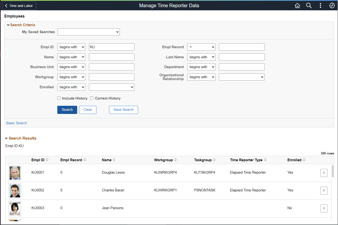

Select Manage Time Reporter Data tile to open Search Criteria Page.
The search Criteria page allows you to search an enrolled employee in Time and Labor.
When you select the Manage Time Reporter tile, the system displays the configurable Manage - Search Criteria page (EOSF_SRCH_FL) to search for job records using fluid.
The page first appears in the Advanced Search mode, where you can use multiple search fields and save your searches, or you can switch to the Basic Search, where you can use the Search By field to retrieve data. Administrators responsible for creating search configurations can modify these options according to the needs of your organization.

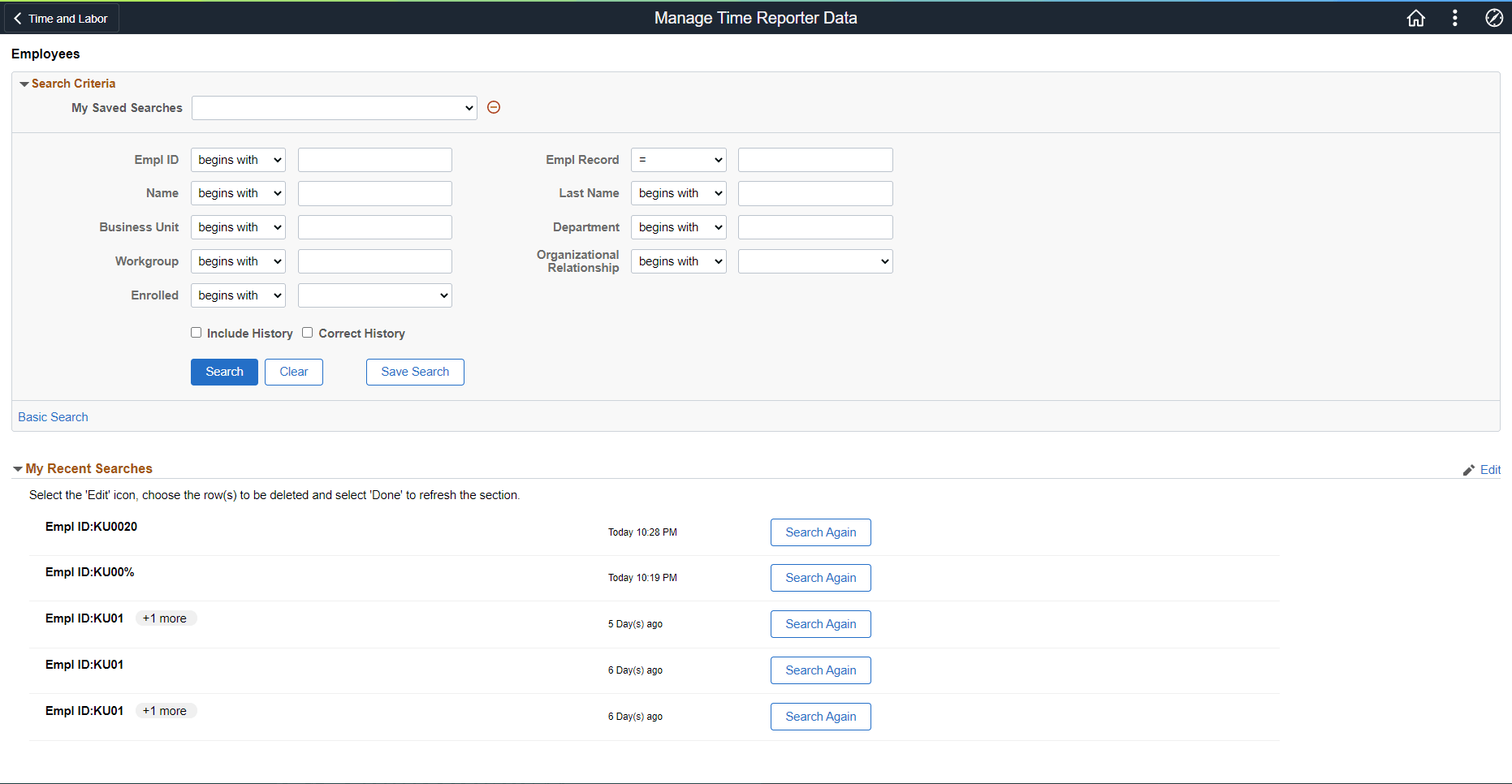

This example illustrates the Search Criteria page and recent searches.
This example illustrates the Manage Job - Search Criteria page showing search results.

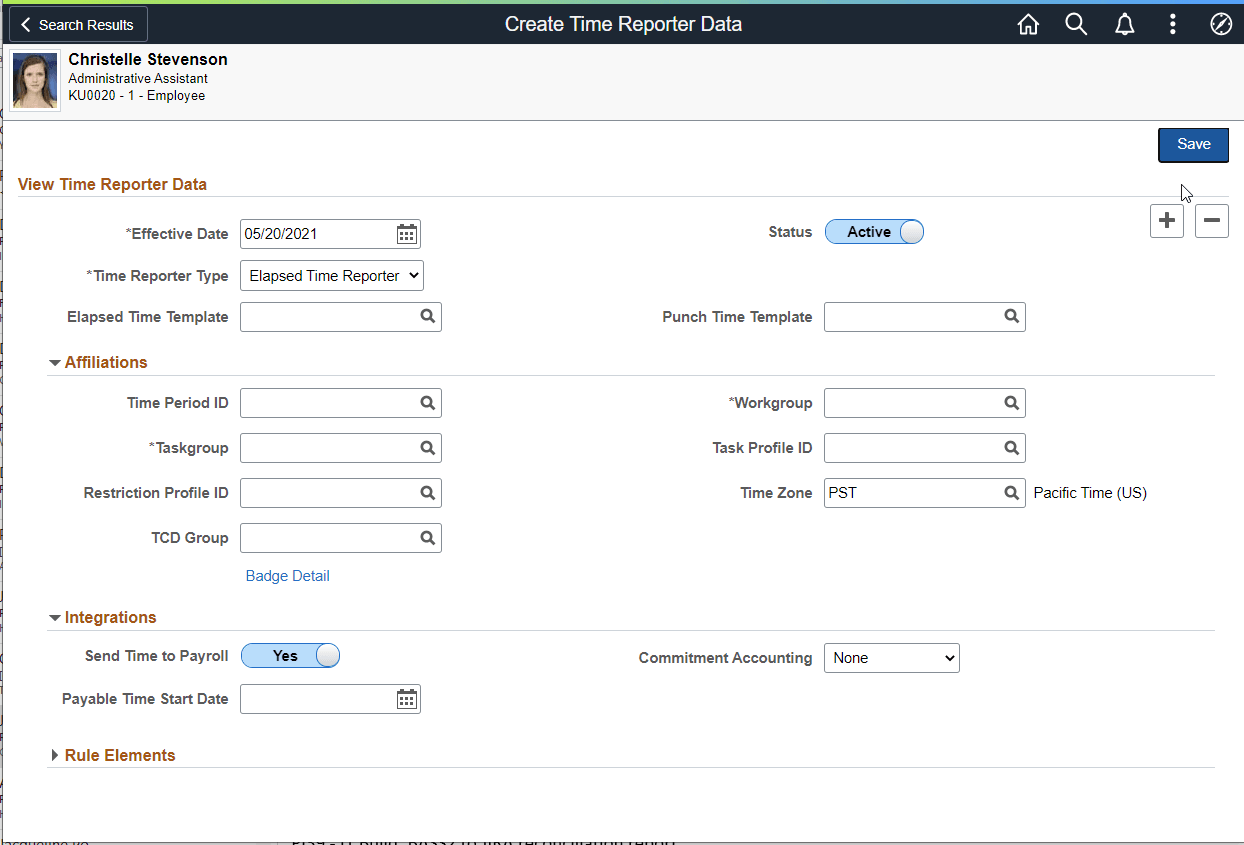

Create Time Reporter Data Page
Use the Create Time Reporter Data page to enroll a time reporter into the Time and Labor system.
Navigation:
Select the searched employee as per the enrollment status for either to create or modify the enrollment data.
Select the employees with enrollment status of No from the results grid. The assisting chevron navigates you to the Create Time Reporter Data page.
This example illustrates the fields and controls on the Create Time Reporter Data page. You can find definitions for the fields and controls later on this page.
Use the Maintain Time Reporter Data page to make changes to data entered on the Create Time Reporter Data page.
For employees already enrolled in Time and Labor, you can select Yes assisted chevron on the search results grid to navigate to the Maintain Time Reporter Data page.

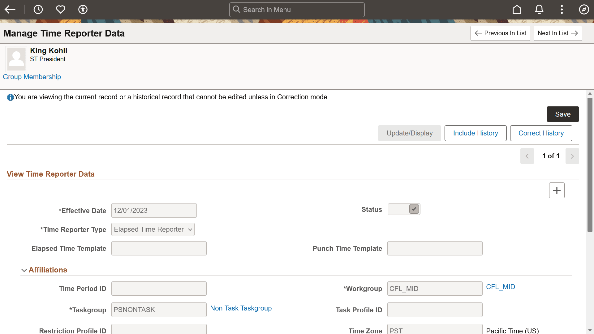

Manage Time Reporter Data Page
Use the Time Reporter Data page (TL_EMPDATA_M_FL) to update enrollment information for time reporters in Time and Labor.
Navigation:
Select the employee search result with enrollment status Yes to modify the enrollment data.
For employees already enrolled in Time and Labor, selecting the chevron on the search results grid navigates you to the Maintain Time Reporter Data page
This example illustrates the fields and controls on the Manage Time Reporter Data page. You can find definitions for the fields and controls later on this page.
