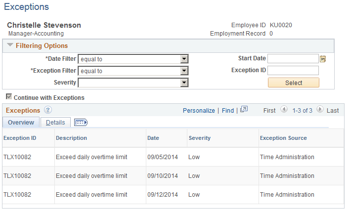

Exceptions Page
Use the Exceptions page (TL_EE_EXCEPTIONS) to view exceptions using this display-only page.
Navigation:
Self Service, and then Time Reporting, and then View Time, and then Exceptions, and then Exceptions
This example illustrates the fields and controls on the Exceptions page.
Exceptions page
Field or Control Description
Filtering Options
Expand this grid to further control which exceptions the system displays.
Date Filter and Start Date
Select a date filter for this exception: between, equal to, greater than, or less than, then enter a date.
Exception Filter and Exception ID
Select an exception ID filter for this exception: equal to, greater than, less than, like, not equal to, or not like, and then enter the exception ID.
Severity
Select a severity level filter for this exception: High, Low, or Medium.
Exception ID
Displays the Exception ID code that was delivered with the system or that you defined using the Define Exceptions page. Click the Details tab to view the Exception Information details of the exception.
Description
Displays the description of the exception.
Date
Displays the date of the reported time that caused the exception.
Severity
Displays the severity of the exception: High, Medium, and Low.
