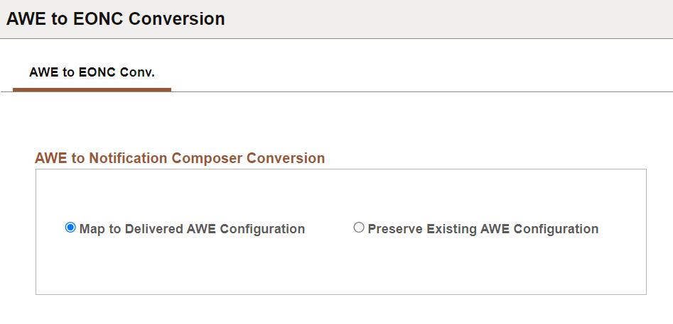

AWE To NC Conversion Page (AWE Notifications)
Use the AWE To NC Conversion page (EONC_AWE_RUN) to specify the conversion method for your existing AWE notifications. To convert existing AWE notifications, start by applying Notification Composer updates through Change Assistant. The change package process automatically directs you to this page. You do not need to access this page through the menu path.
Navigation:
Enterprise Components, and then Notification Composer, and then AWE to NC Conversion, and then AWE to NC Conversion
This example illustrates the fields and controls on the AWE To NC Conversion page.
AWE to NC Conversion page
Field or Control Description
Map to Delivered AWE Configuration
Select this option to map your existing Approval Workflow Engine notification events to PeopleSoft delivered Notification Composer events and related system data.
Preserve Existing AWE Configuration
Select this option to maintain your existing AWE configuration, including custom-built and modified AWE notifications. In this scenario, a new Notification Composer configuration is created and the new Notification Composer data is linked to the existing AWE configuration.
Both conversion methods migrate converted AWE notifications and Notification Composer configuration. The DataMover script EONC_IMPORT_MTP.DMS must execute in order to complete the conversion process. This step imports the converted data (which was exported from the target during Initial Pass) in the Subsequent and Move to Production passes.
It is important to include all AWE notification composer updates in your change package to ensure that all the AWE configuration is properly converted.
The conversion process only needs to be completed once. After successfully completing the conversion process, you do not need to perform it again. You do not need to return to this page after applying the change package.
This page does not retain the conversion selection you made while applying the change package. Do not use the page for this purpose after applying the change package.

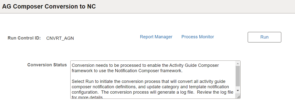

AG Composer Conversion to NC page (Activity Guide Composer Notifications)
Use the AG Composer Conversion to NC page (AGC_CNVTONC) to convert your existing Activity Guide Composer notifications to Notification Composer.
Navigation:
Enterprise Components, and then Activity Guide Composer, and then Activity Guide Utilities, and then AG Composer Conversion to NC, and then AG Composer Conversion to NC
This example illustrates the fields and controls on the AG Composer Conversion to NC page.
Click Run to initiate the Activity Guide Composer notification conversion process.
The conversion process:
  • Enables Notification Composer for Activity Guide Composer on the AG Composer Installation Table Page (sets the AGC_EONC_INSTALL flag to Yes in the AGC_INSTALL table).
  • Generates a Notification ID and corresponding Notification Event for existing notification text IDs that are defined in the AGC_CAT_NOT_DEFN table.
  • Generates a log you can use to review conversion details.
