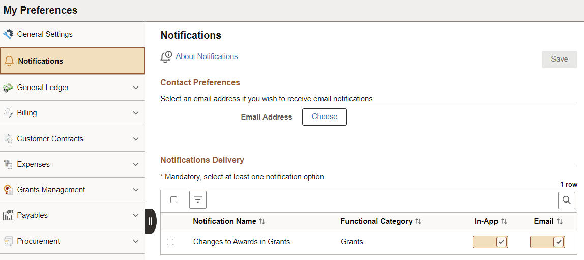

My Preferences - Notifications Page
Use the My Preferences - Notifications page (PTPN_USER_PREF) to select contact preferences such as email address, and notification delivery preferences for yourself.
Navigation:
My Preferences, and then Notifications
This example illustrates the fields and controls on the My Preferences - Notifications page.
My Preferences - Notifications (MYOUNG/MYOUNG)
Contact Preferences
Field or Control Description
Choose
Select this button to access the Email Address page where you can select an email address for notifications.
Email addresses are sourced from the User Profile - General page (PeopleTools, and then Security, and then User Profiles, and then User Profiles, and then General.
Notifications Delivery
Use this section to view which notifications you receive, and determine the method you wish to receive each notification.
Select (check box)
Select to display the Action button where you can Enable or Disable the Email, In-App, or Text options in bulk.
Notification Name and Functional Category
Displays the information that is determined on the Define Notification Event Page.
In-App, Email, Text
Select the method(s) that you would like to receive a notification for each Notification Name.
The methods that appear on this page default from the Notification Administration - Global Settings page.

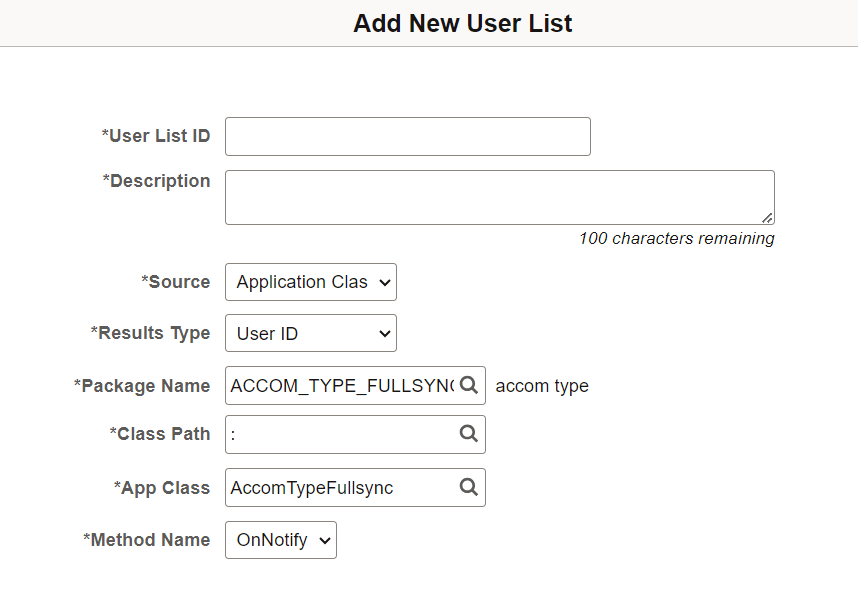

Add New User List Page
Use the Add New User List page (EONC_UL_ADD_SCF) to create user lists that can be used to define notification recipients. Some fields on the page are generated dynamically based on the Source field value.
Navigation:
Select the Add User List button on the Define User List page.
This example illustrates the fields and controls on the Add New User List page.
User List ID and Description
Enter a short and long description for the user list.
Source
Select a source from which you will create the user list. Supported sources are:
  • Application Class
  • Role
  • Role Query
  • SQL Definition
When you select a source value, the fields on the page change dynamically. See the sections that follow to view the additional fields that appear with each Source option.
Results Type
Select a results type for the user list. The results type determines the type of contact information the source returns:
  • Email Address
  • Phone Number
  • User ID
Note: If you select Role or Role Query from the Source field, only User ID result type can be used.
Source: Application Class
The page displays these fields when you select Application Class for the Source value:
Package Name
Enter the package (container) associated with the PeopleTools Application Class that is the source for the user list.
Class Path
Enter the directory path that defines the location of the PeopleTools Application Class that is the source for the user list.
App Class (Application Class)
Enter the PeopleTools Application Class to be used as a source for the user list.
Method Name
Enter the method (function) associated with the PeopleTools Application Class that has the logic to identify the recipients.

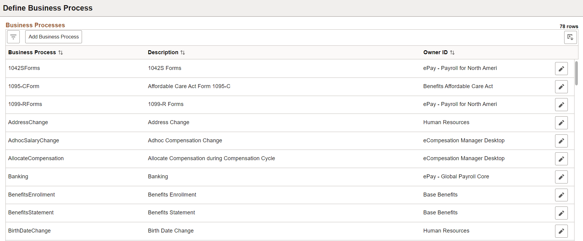

Define Business Processes Page
Use the Define Business Process page (EONC_BUS_PROC_FL) to maintain business process definitions and add new processes for Notification Composer. Business processes represent logical grouping of Notification Events.
Navigation:
Enterprise Components, and then Notification Composer, and then Define Business Process, and then Define Business Process
This example illustrates the fields and controls on the Define Business Processes page.
Filter button (Business Process page)
Select this button to access the Filters page and enter parameters used to filter the list by a given business process, description, or object owner ID.
Add Business Process
Select this button to access the Add Business Process Page and add additional business processes for your Notification Composer configuration.
Edit Business Process button
Select this button to access the Edit Business Process page (EONC_BP_EDIT_SCF) and edit an existing business process definition.
Note: The Edit Business Process page and Add Business Process Page layouts are almost identical. The only difference is that the Edit Business Process page also includes the last updated date and time, and updated by information of the business process.
Delete
Select this button to delete the business process.
This button is available only for those business processes you created. You cannot delete a delivered system data event.

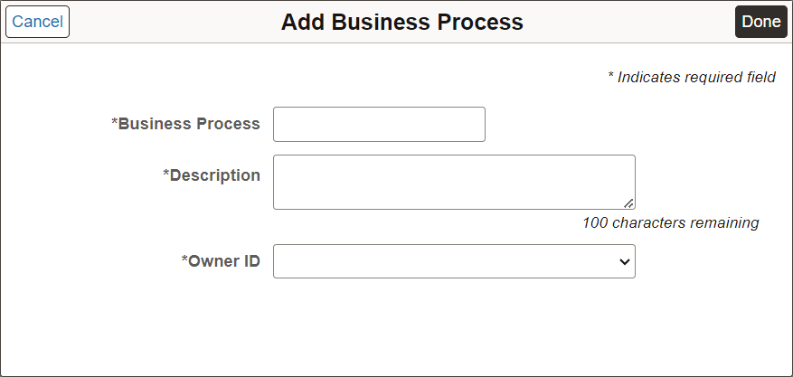

Use the Add Business Process page (EONC_BP_ADD_SCF) to add additional business processes for your Notification Composer configuration. Business processes represent logical grouping of Notification Events.
Navigation:
Select the Add Business Process button on the Define Business Processes Page.
This example illustrates the fields and controls on the Add Business Process page.
Business Process and Description
Enter a short and long description for the business process.
Owner ID
Enter the application owner for the business process.
Done
Select this button to add and save the business process.
See the Define Notification Event Page.

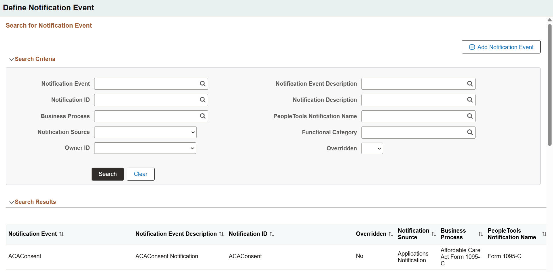

Use the Define Notification Event page (EONC_XREF_DEFN_FL) to manage existing notification events and create new events. Notification Events are events that occur within the context of a PeopleSoft application that trigger notifications, such as hiring an employee or adopting a baby. Notification Events map to theNotification ID, PeopleTools Notification Name, Functional Category, and Business Process.
Navigation:
Enterprise Components, and then Notification Composer, and then Define Notification Event, and then Define Notification Event
This example illustrates the fields and controls on the Define Notification Event page.
Add Notification Event
Select this button to access the Add Notification Event Page and create a new notification event.
Search Criteria
Enter search criteria to find existing Notification Events. You can search by Notification ID, Business Process, Owner ID, PeopleTools Notification Name, and so forth.
Search Results
The Search Results displays existing Notification Events based on your search criteria. For an understanding of each column, see field definitions for the Add Notification Event Page.

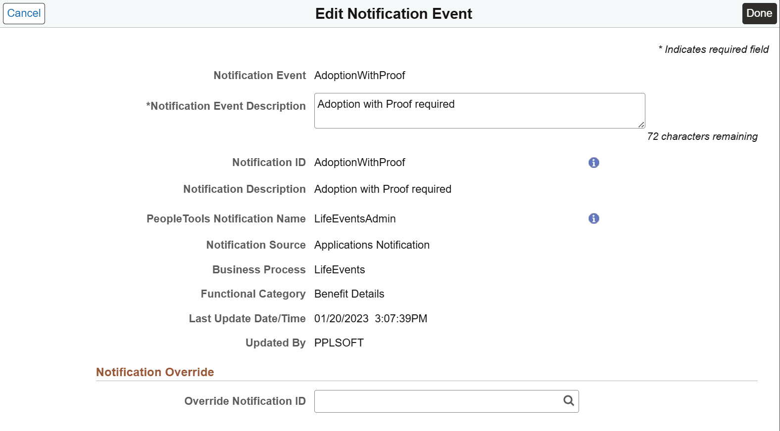

Overridden
Indicates whether the delivered Notification ID has been overridden with a new value.
You can override the delivered Notification ID using the Edit Notification Event Page.
Edit Notification Event button
Select this button to access the Edit Notification Event Page and edit an existing notification event.
Delete
Select this button to delete the Notification Event.
This button is available only for those notification events you created. You cannot delete a delivered system data event.

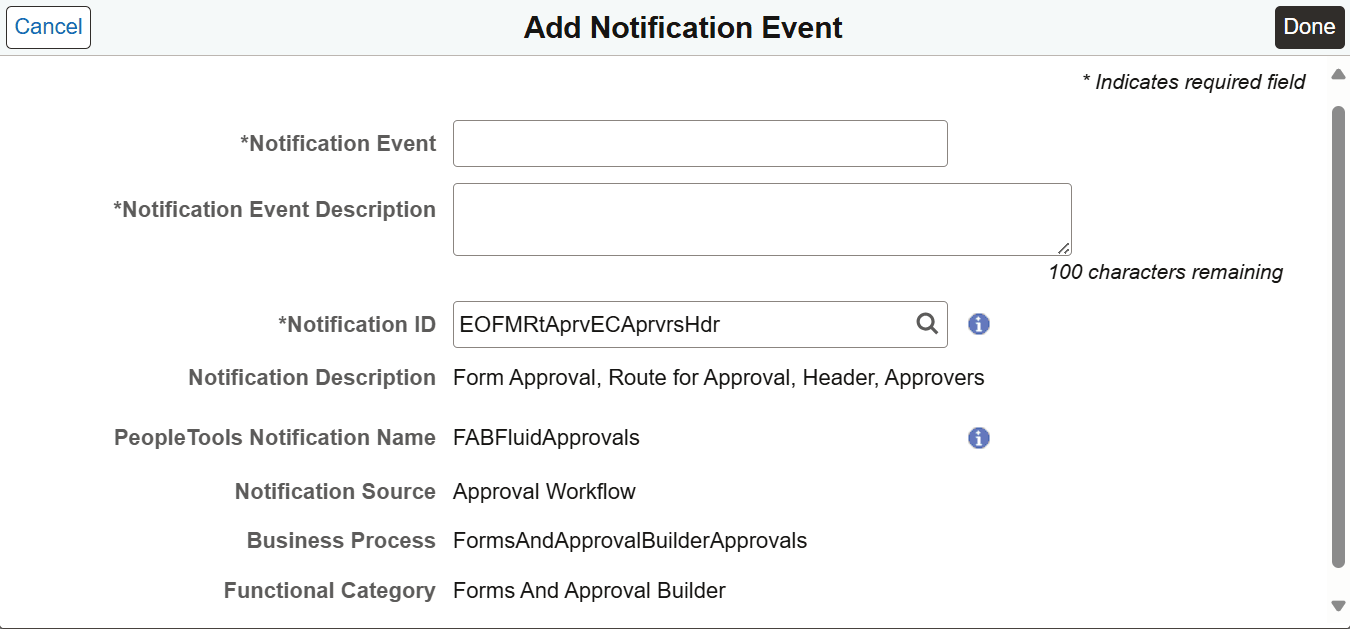

Use the Add Notification Event page (EONC_XREF_ADD_SCF) to create a notification event. Notification Events are events that occur within the context of a PeopleSoft application that trigger notifications, such as hiring an employee or adopting a baby. Notification Events map to the Notification ID.
Navigation:
Select the Add Notification Event button on the Define Notification Event page.
This example illustrates the fields and controls on the Add Notification Event page.
Notification Event
Enter the notification event. This information is used as the Notification Event ID.
Notification Event Description
Enter a description for the notification event.
Notification ID
Enter a Notification ID for the event. The Notification ID helps identify the corresponding PeopleTools Notification, Notification Source, Business Process, and Functional Category.
After you enter the Notification ID, the corresponding PeopleTools Notification and Business Process fields display below.
You can select the adjacent blue Information icon to access the Notification Details page and view notification details, such as in-app, email, and text.
See Notification Details Page.
Notification Description
Displays the description of the notification.
Displays the PeopleTools notification name associated with this event. PeopleTools notification name is defined within PeopleTools Push Notification Framework.
You can select the adjacent blue Information icon to access the PeopleTools Notification Name Details page and view details specific to the PeopleTools notification name, such as delivery channel preferences and personalization authorization.
Notification Source
Displays the Notification Source associated with this event.
Business Process
Displays the Business Process associated with this event.
Business process is a logical grouping of Notification Events.
Functional Category
Displays the Functional Category associated with the PeopleTools Notification.
Functional category is defined within PeopleTools Push Notification Framework and represents a logical grouping of PeopleTools notification name.
Use the Edit Notification Event page (EONC_XREF_EDIT_SCF) to modify an existing notification event.
Navigation:
Select the Edit Notification Event button on the Define Notification Event page.
This example illustrates the fields and controls on the Edit Notification Event page.
Enter an updated description for the notification event if needed.
Notification ID
Use this field to specify a different notification ID for the associate notification event, if desired.
Note: This field is editable starting with HCM Update Image 55.
This field is editable for notifications that are created by customers, or those that were converted to use Notification Composer using the AWE to NC Conversion page.
After selecting a different notification ID, the rest of the field values are updated and displayed on the page accordingly.
This field is not editable for Oracle-delivered notifications.
Override Notification ID
Enter a different notification ID to use for the associated notification, if desired. Use this field to override IDs for Oracle-delivered notifications. For example, if you have cloned and modified a delivered notification ID, use the Override Notification ID field to map to the cloned notification ID.
Note that you can also use this field to specify different notification IDs for notifications created by customers or converted to use Notification Composer. When specified, the override notification ID (not the original notification ID) will be the used at runtime.
Use the blue Information icons to access notification details.
