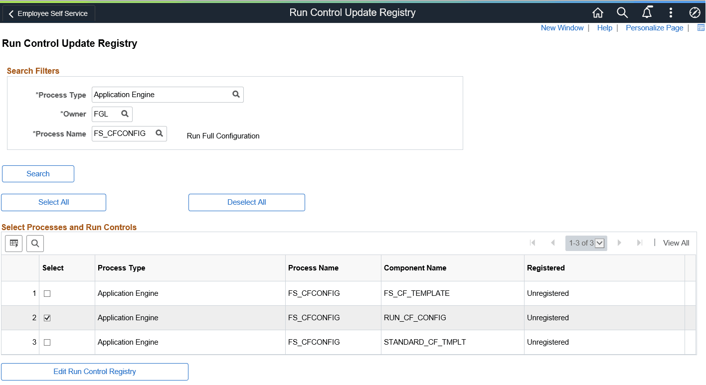

Run Control Update Registry Page
Use the Run Control Update Registry page (EORC_RCCMPS) for administrators to register the Run Controls that can be updated by the users.
Navigation:
Enterprise Components, and then Run Control Registry , and then Run Control Update Registry
This example illustrates the fields and controls on the Run Control Update Registry page.
Field or Control Description
Search Filters
Use the search filters to find the required run controls that you want to register for the Run Control Date Update task.
Process Type
Choose the relevant Process Type .
Owner
Choose the Object Owner.
Process name
Choose the Process name.
Click Search to list the relevant run controls based on the user’s search filters.
Select Processes and Run Controls
Select All
Select all the search results.
Deselect All
Deselect all the search results.
Grid Action menu
The Grid Action Menu provides three options that the user can perform on the search results:
  • Personalize the column and sort order of the search result grid.
  • Zoom or display in a popup page the selected processes and run controls.
  • Download the selected processes and run controls table to and Excel sheet.
Search
Search a particular text in the search result.
Select
Select the required Run Controls from the search result.
Process Type
Displays the Process Type of the Run Controls.
Process Name
Displays the Process Name of the Run Controls.
Component name
Displays the Component Name of the Run Controls.
Registered
Indicates whether the Run Control has been registered for the date update task.

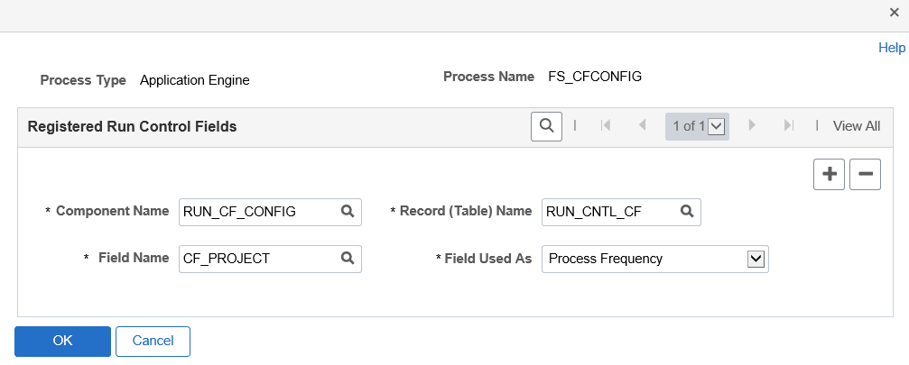

Edit Run Control Registry Page
Use the Edit Run Control Registry page to specify the fields in the Run Control that are registered for Run Control Date Update.
Navigation:
On the Run Control Update Registry page, select the Edit Run Control Registry button.
This example illustrates the fields and controls on the Edit Run Control Registry page.
Register Run Control Fields
Component Name
Choose the Run Control Component Name from the parent page.
Record (Table) Name
Choose the table name with the fields to be updated .
Field Name
Choose the field Name in the table that needs to be updated.
Field Used As
The list of page fields that the field can be used as.
Use the + or - buttons to add or remove fields to be registered for the run control date update task.
System data of registered run control fields cannot be edited.
Records that are owned by PeopleTools are not available to register.
Once done, Click Save on the Run Control Update Registry Page to register the Run Control.
Click the Notify Button to notify selected users about the registration.

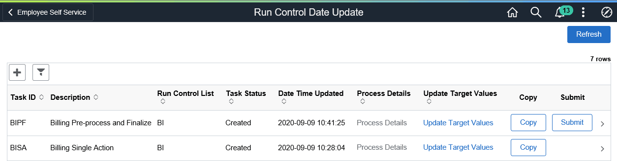

Run Control Date Update Page
Use the Run Control Date update page (EORC_TASKMAIN_FL) to view the existing list of Run Control Date Update tasks or to create, edit and manage an existing task.
Navigation:
The Run Control Date Update page is delivered as a tile that can be added to a home page or dashboard. To access the tile, browse to:
Personalize Homepage > Add Tile> Run Control management> Run Control Date Upd.
Once the tile is available on the home page, click the tile to access the Run Control Date Update page.
This example illustrates the fields and controls on the Run Control Date Update page.
Add button
Click the Add button to add a new Run Control Date Update task.
Filter button
Click the filter button to filter the existing task list.
Task ID
List of Task IDs that are available.
Description
Task Description
Run Control List
Run Controls that are associated with the Task ID.
Task Status
Status of the task.
Date Time updated
Last updated date and time of the task.
Process Details
The processing details of the task.
Update Target Field Values
This link delivers a pop-up page where the run control dates for the task can be updated.
See also Define New Values Page.
Copy
Copy an existing Task ID to create a new task.
Submit
Submit the task for processing.

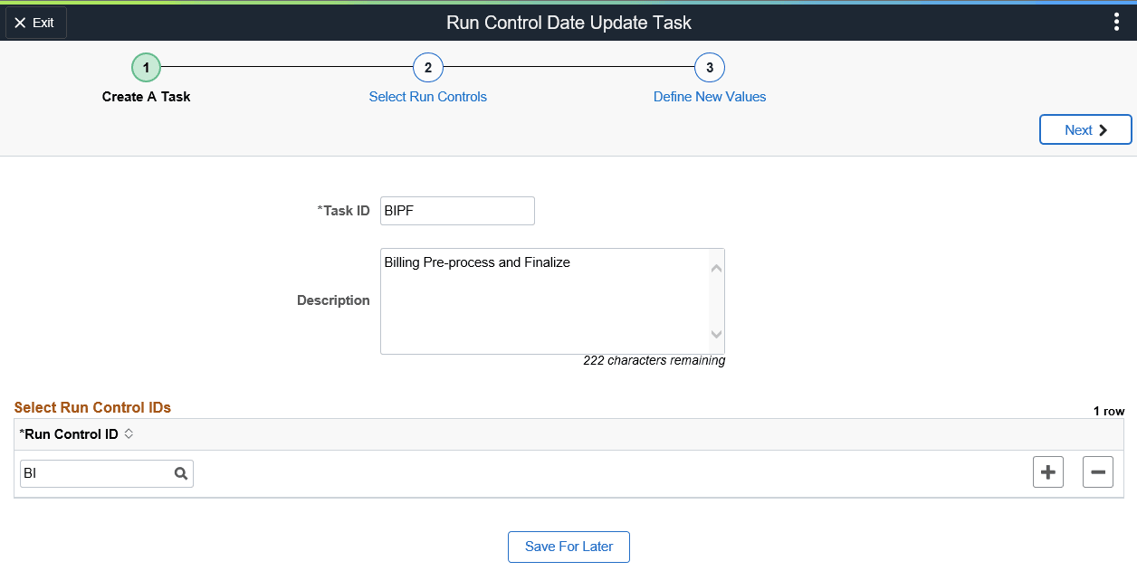

Create A Task Page
Use the Create A task page (EORC_UPD_STEP1_FL) to create a new Run Control Date Update task.
Navigation:
Click the Add (+) button on the Run Control Date Update Task page. This starts a three-step activity guide to create the task.
This example illustrates the fields and controls on the Create A Task page.
Run Control Update Task - Create
Task ID
Enter a unique name for your task. Task ID should not contain spaces.
Description
Enter a short user-friendly description for the task.
Select Run Control IDs
Select all the Run Control IDs that need to be grouped under this task. Only run controls that were registered using the Run Control Update Registry Page are available for selection.
Save For Later
Save the task as draft. The user can revisit the this page to continue with the creation of the task.
Click the Next button to proceed to the next page in the activity guide.

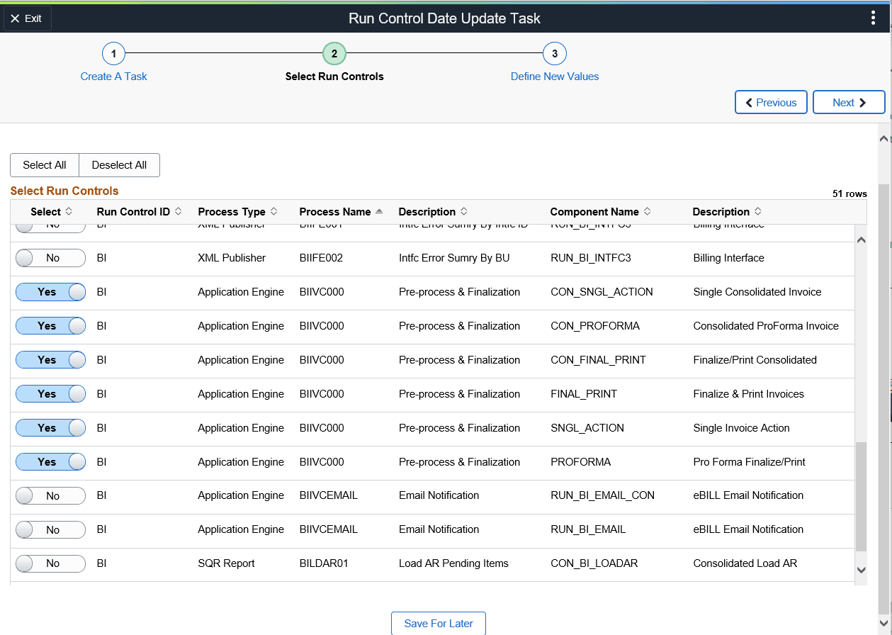

Select Run Controls Page
Use the Select Run Controls page (EORC_UPD_STEP2_FL) to update the Run Control components.
This example illustrates the fields and controls on the Select Run Controls page.
Run Control Update Task - Select
Select All
Select all the components for the update task.
Deselect All
Deselect all the components for the update task.
Select
Select the required components from the list for the update task.
Save For Later
Click the Next button to proceed to the next page in the activity guide. Click Previous to go to the previous step in the activity guide.
If a run control record is shared between components, then the updated values are reflected in all components that share the common record.

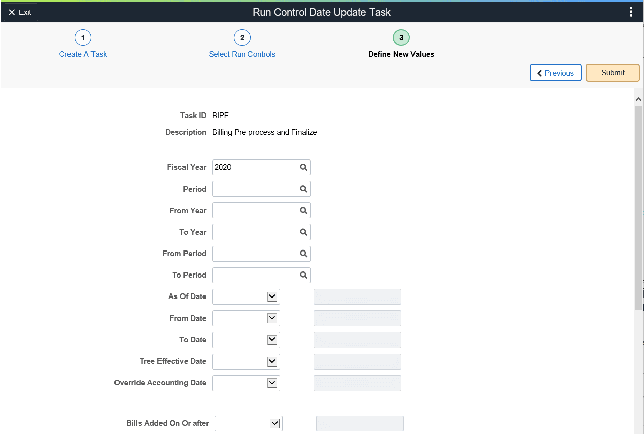

Use the Define New values page (EORC_UPD_STEP3_FL) to define the new run control for the task.
This example illustrates the fields and controls on the Define New Values page.
Run Control Update Task - Define
Use the Submit button to submit the task for processing.
