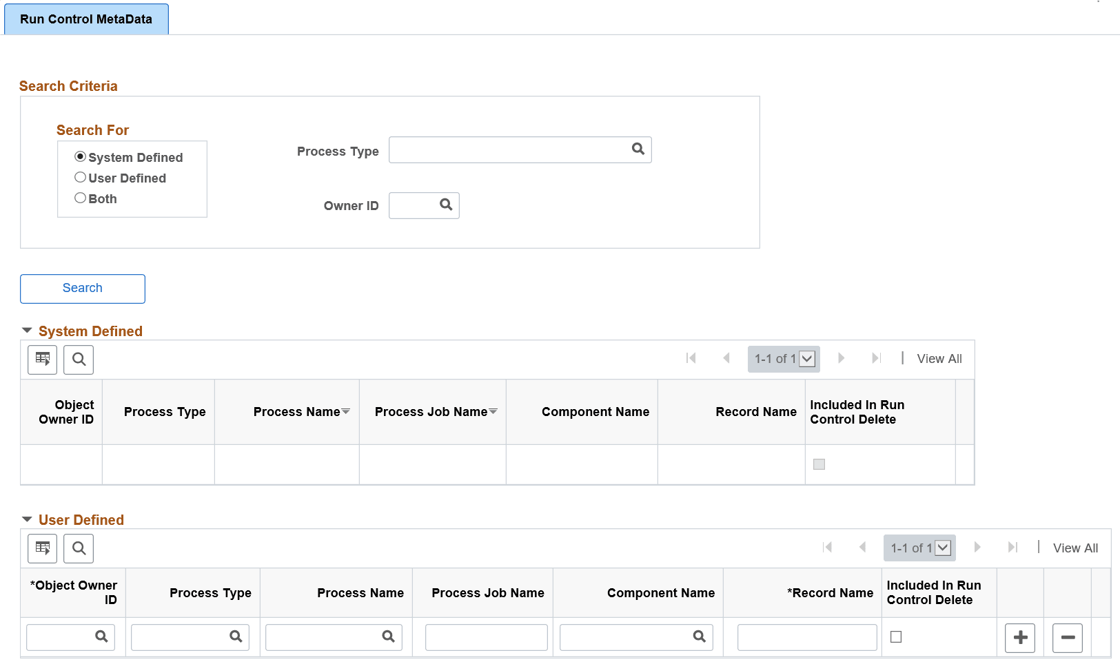

Run Control Delete Metadata Page
Use the Run Control Delete Metadata page (EORD_METADATA) to review and register run control tables for the Run Control Delete process.
Navigation:
Enterprise Components, and then Run Control Management, and then Run Control Delete Metadata
This example illustrates the fields and controls on the Run Control Delete Metadata Page. You can find definitions for the fields and controls later on this page.
Run Control Metadata
Oracle PeopleSoft delivers all applicable run control tables as system data. You can register any custom process/run control pages in the User Defined section on this page. You can also search for system-defined or user-defined run control metadata. System data can only be reviewed, but not deleted on this page.
Field or Control Description
Search For
Select from the given three options to search the metadata:
  • System Defined
  • User Defined
  • Both
Process Type
Select required Process type from the prompt to search for system defined or user defined run control data.
Owner ID
Select Owner ID to search based on the Owner ID/Product ID.
Included In Run Control Delete
Select to include the record in the Run Control Delete process.

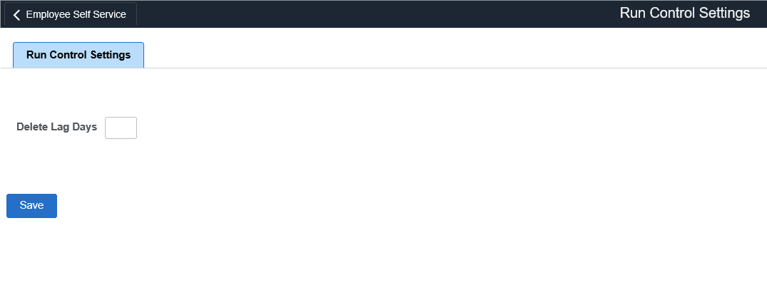

Run Control Settings Page
Use the Run Control Settings page (EORD_DAYS) to set the delete lag days for the Run Control Delete process.
Based on the value given in this field, the run control data will be available for deletion.
Navigation:
Enterprise Components, and then Run Control Registry, and then Run Control Settings
This example illustrates the fields and controls on the Run Control Settings page. You can find definitions for the fields and controls later on this page.
Delete Lag Days
Enter the number of days based on which the run control data will be available for deletion. For example, if this field is set to a value of 30 then only those run control IDs, which are atleast 30 days old will be eligible for deletion. If this field is left blank, or zero is entered as the value then all run control data will be eligible for deletion.

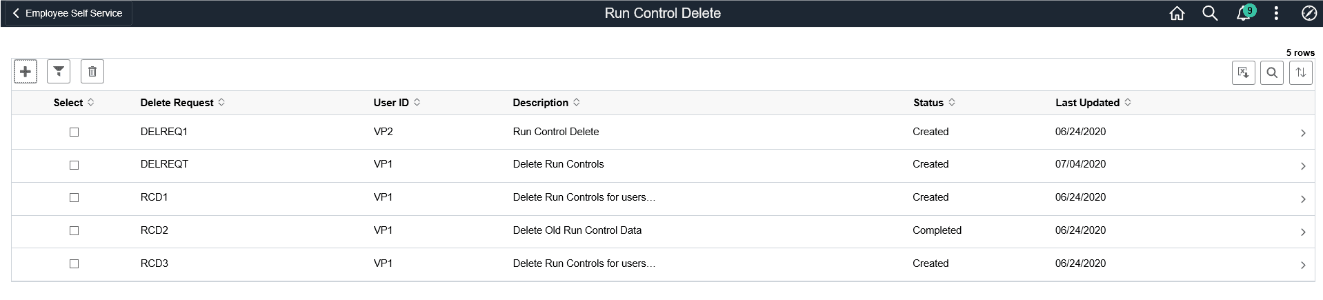

Run Control Delete Page
Use the Run Control Delete page (EORD_TASKMAIN_FL) to view existing run control delete requests and take appropriate action.
Navigation:
Personalize Homepage, and then Add Tile, and then Run Control Management, and then Run Control Delete
Tile can be placed on any PeopleSoft Fluid Home page. For additional information about how to add a tile to a PeopleSoft Fluid Home page, see PeopleTools: Application User’s Guide, “Working With PeopleSoft Fluid User Interface”, Working With Fluid Homepages, Managing Tiles, Adding Tiles to a Fluid Homepage.
Select the Run Control Delete tile.
This example illustrates the fields and controls on the Run Control Delete page. You can find definitions for the fields and controls later on this page.
Users can add new requests. They can review/update delete requests created only by them. Users can click individual rows displayed on the page to view summary of the selected delete request in the Delete Request Summary page. Administrators can view delete requests submitted by all users, and filter displayed data.
Add iconAdd
Click to select User IDs to delete corresponding run control data.
Filter iconFilter
Click to select criteria for filtering the displayed run control delete requests. Results can be filtered by Delete Request, User ID, or Status.
Delete iconDelete
Click to delete selected run control delete requests.
Excel iconDownload to Excel Delete Requests
Click to download the displayed delete requests in to an Excel file.
Search iconSearch
Select to search for specific delete requests.
Sort iconSort
Select to sort the displayed delete requests.
Select
Select the check box to delete required run control delete requests.
Delete Request
Displays the unique delete request name.
User ID
Displays the User IDs of all users who have created delete requests. This column is visible only to the administrator.
Description
Displays the delete request details.
Status
Displays the status of the delete requests. Status values are:
  • Created — created delete request.
  • Submitted — submitted for processing.
  • Completed — completed processing.
Last Updated
Displays the date when the delete request was last updated.

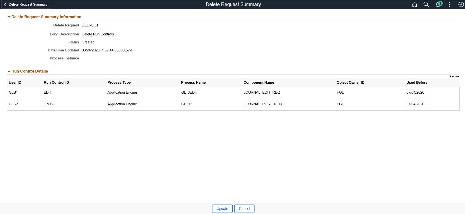

Delete Request Summary Page
Use the Delete Request Summary page (EORD_DS_SUM_FL) to view run control details for the selected delete request.
Navigation:
Select any delete request to view its summary information.
This example illustrates the fields and controls on the Delete Request Summary page. You can find definitions for the fields and controls later on this page.
Update
Click to update the selected delete request details. This link is applicable only when the delete request is created. It does not appear when the request is submitted for processing or completed.
Cancel
Click to cancel and return to the Run Control Delete page.

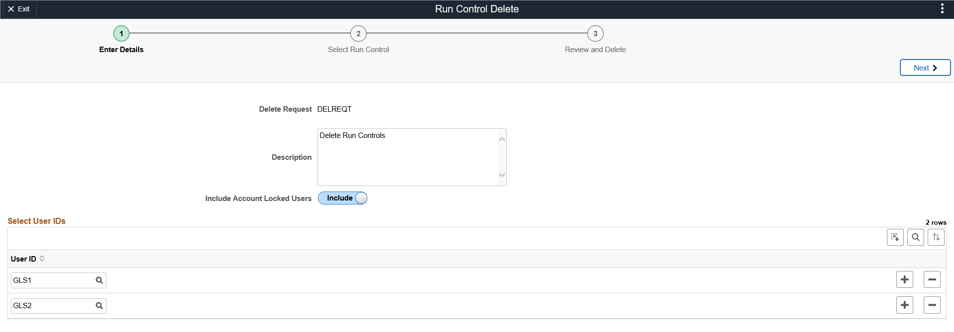

Enter Details Page
Use the Enter Details page (EORD_DSET_FL) to enter details for the run control delete request.
You can add User IDs for which the run control data needs to be deleted.
Navigation:
Click the Run Control Delete Tile. Select the Add icon.
This example illustrates the fields and controls on the Enter Details page. You can find definitions for the fields and controls later on this page.
Enter Details page
Delete Request
Enter an unique delete request name.
Include Account Locked Users
Select Include to include locked users in the delete run control data process. Select Exclude to exclude locked users. This field is visible only for administrators.
User ID
Select User IDs to include for deleting run control data. This field is available only for administrators. Only five users can be added.
Next
Click to navigate to the next step in the activity guide.

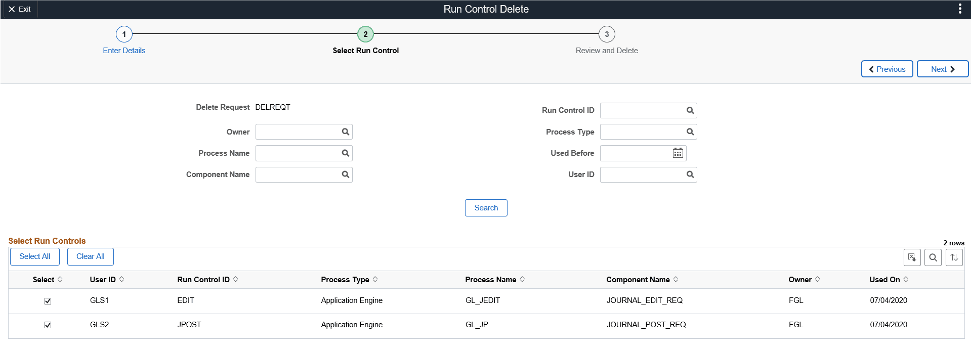

Select Run Control Page
Use the Select Run Control page (EORD_DSET2_FL) to select run control components for which the run control data needs to be deleted.
For better performance, the number of distinct run control IDs fetched for a delete request is limited to 300.
Navigation:
From the Enter Details page, select the Next button.
This example illustrates the fields and controls on the Select Run Control page. You can find definitions for the fields and controls later on this page.
Run Control ID
Select Run Control IDs that are applicable to the selected User ID (in case of administrator) or User ID of the current user.
Process Type
Select process types.
Process Name
Select process names that are applicable to the selected Process Type. Process Name can be selected only after selecting a Process Type.
User ID
Select an User ID for which the run control has to be deleted. This field is visible only to administrators.
Search
Click to search for required run control data after entering details in any of the search fields.
Select
Select run control components for deletion.
Note: Based on the value set in the Run Control Settings page, the run control data is selected for deletion. If no value is specified then all the run control data is deleted.
Next
Click to navigate to the next step in the activity guide. You have to select at least one row from the displayed run control data to proceed to the next step.

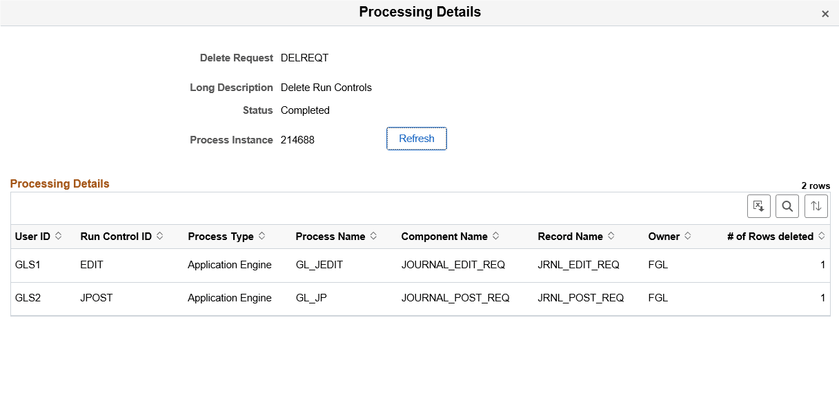

Processing Details Page
Use the Processing Details page (EORD_PRCD_FL_SCF) to review processing details for the deleted run control data.
Navigation:
From the Run Control Delete: Review and Delete page, select the Submit button.
This example illustrates the fields and controls on the Processing Details page. You can find definitions for the fields and controls later on this page.
Refresh
Click to view the updated status of the delete request once the request is submitted for processing.
If the number of rows selected for deletion are less than or equal to150 then the processing is performed online, and user can review the processing details once it is submitted. If the number of rows are greater than150 then the processing is performed in batch mode. The delete request is in Submitted status until the processing is complete.
When closing this page, the system exits the activity guide and navigates to the Run Control Delete page.
