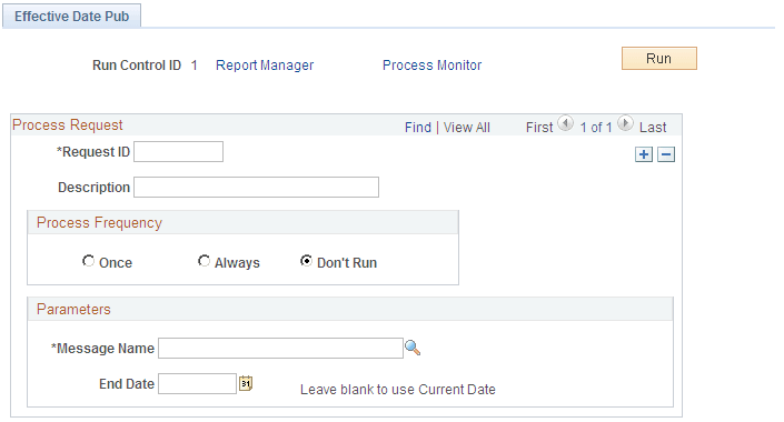

Effective Date Pub Page
Use the Effective Date Pub page (EO_EFFDATAPUB) to run the Effective Date Publish utility.

This example illustrates the fields and controls on the Effective Date Pub page. You can find definitions for the fields and controls later on this page.
Field or Control Description
Message Name
Select the current incremental message to publish.
End Date
Select the latest effective date to process from the delay table.
Run
Click to run this request.
The Application Engine program uses the trigger records in the delay table and the end date parameter from the run control component to publish a current effective incremental message that contains all future-dated rows that are effective. This ensures that third-party systems that cannot manage future-dated records always receive currently active data on that data's effective date, even if that information was previously updated on the PeopleSoft system.
