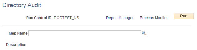

Directory Audit Page
Use the Directory Audit page (EO_RUNCTL_DS_AUDIT) to run the Directory Audit process.
Navigation:
Enterprise Components, and then Directory Interface, and then Run Directory Audit
This example illustrates the fields and controls on the Directory Audit page. You can find definitions for the fields and controls later on this page.
Use this page to run the process to ensure that your directory database has the same data as your PeopleSoft database.
The Directory Audit process compares the data in the directory to the data in the PeopleSoft database identified in the selected map and creates an LDAP Data Interchange Format (LDIF) file containing any discrepancies using the PeopleSoft system as the authority. You can then use the LDIF file to update the directory.
For PeopleSoft HCM customers only, an alternative process named DSMAPINPUT FullSync Audit is available that you can use in place of the Directory Audit process. This new process does not replace the Directory Audit process; it is provided as an alternative to audit the data if performance becomes an issue.
See PeopleSoft HCM: Application Fundamentals
Field or Control Description
Map Name
Select the name of the map that the audit should be run against.

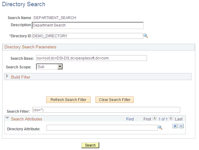

Directory Search Page
Use the Directory Search page (EO_DSSRCHDIRECTORY) to define search parameters to query the directory.
The page saves the search parameters for future use.
Navigation:
Enterprise Components, and then Directory Interface, and then Search Directory
This example illustrates the fields and controls on the Directory Search page. You can find definitions for the fields and controls later on this page.
Use this page to define search parameters to query the directory and view the results. Search results are displayed on the Search Results page as they appear in the directory.
Search Name
Enter the search name. The system saves the search parameters that you enter on this page and stores them under this name for future use.
Directory Search Parameters
Search Base
Select the directory entry that is the search base for this search. The search base is the entry in the directory information tree at which the search begins querying.
Search Scope
Select from:
Base: The query searches only the value in the Search Base field.
One: The query searches only the entries one level down from the value in the Search Base field.
Sub: The query searches the value in the Search Base field and all entries beneath it.
Build Filter
Use the fields in the Build Filter group box to create an attribute-specific filter. For example, if you want data on a single person, enter the attribute name Person, the operation =, and the person’s name in the Value field. You can construct multiple filters.
Use parentheses to separate filter statements.
Attribute Name
Enter the name of the attribute data to which you want to filter.
Operation
Select an operator to determine how to filter the data.
Value
Select a value to compare against when filtering.
And/Or
Select from:
  • And: A search must meet the criteria of multiple statements.
  • END: This value marks the end of a query. This value applies parentheses appropriately.
  • NoOp: No operator is used.
  • OR: A search must meet the criteria of one of multiple statements.
Search Filter
You can narrow the search (for example, instruct the system to search for all attributes but one) by entering a search filter. Enter the search filter using standard LDAP protocol.
You can specify one or more attributes to search for. To search all attributes, enter an asterisk ( * ).
For more information about the LDAP protocol, see your directory documentation.
Search Attributes
Directory Attribute
Select the attributes to search for.
Leave this field blank to search all attributes.
