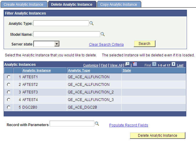

Use the Delete Analytic Instance page (PTACEDELINST) to specify search criteria to filter the display of returned analytic instances based on a combination of analytic type, model name, and server state; and then unload the selected analytic instance and delete the data associated with it.
Navigation:
PeopleTools, and then Utilities, and then Administration, and then Maintain Analytic Instances, and then Delete Analytic Instance
This example illustrates the fields and controls on the Delete Analytic Instance page. Definitions for the fields and controls appear following the example.
Field or Control Description
Analytic Type
Look up and select the analytic type upon which the analytic instance is based.
Model Name
Look up and select the analytic model upon which the analytic instance is based.
Server State
Select one of the following:
  • Idle
  • Loading
  • Executing
  • Terminating
See Administering Analytic Servers.
Clear Search Criteria
Click to delete any current search criteria so you can begin a search from scratch.
Search
Click to display all analytic instances that meet the specified search criteria.
Select one of the displayed analytic instances to delete.
Record with Parameters
Look up and select parameters to be passed to the application class method. Click the lookup button to display a list of records. Select a record, the first row of which will consist of parameters that you want to pass to the application class method. Selecting any record generates a populated, standalone record.
Populate Record Fields
Displays a secondary page that lets you populate the fields of the standalone record; the values of these fields will serve as parameters passed into the App Class Method.
Unload the selected analytic instance and delete the data associated with it.
