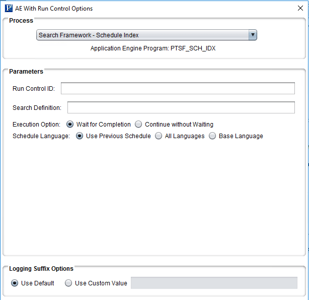

Setting Search Framework Options for AE With Run Control
Search Framework- Schedule Index is used to schedule a build for the search index.
This example illustrates the fields and controls on the AE With Run Control Options page with Search Framework-Schedule Index selected. You can find definitions for the fields and controls later on this page.
AE With Run Control Options Showing Search Framework-Schedule Index
Field or Control Description
Run Control ID
Enter the run control id.
Search Definition
Enter the Search definition.
Execution Option
Select whether to Wait for Completion or Continue without waiting.
Schedule Language
Select the schedule language.
Logging Suffix Options
Select whether to use the default log name or enter a custom suffix value for the log file name.
The suffix is used to create a unique output log file name for the step.
