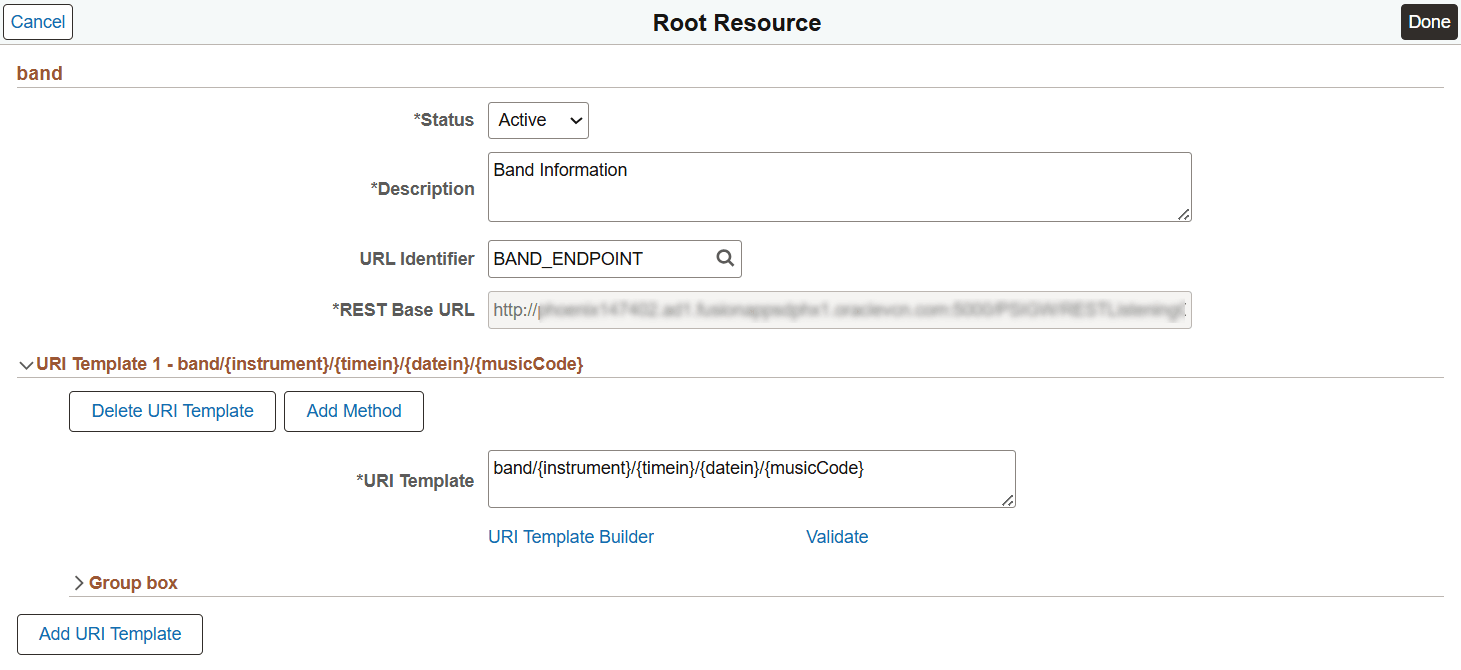

Adding Method to the URI Template for Consumer Application Service
Once the URI Template is defined, it is added to the Root Resource page. Select the root resource from the Application Service page.
This example illustrates the fields and controls on the Root Resource page with URI Template. You can find definitions for the fields and controls later on this page.
Field or Control Description
Delete URI Template
Select to delete the URI template.
Add Method
Select to add the method.
URI Template Builder
Select to modify the existing URI template.
Add URI Template
Select to add another URI template.

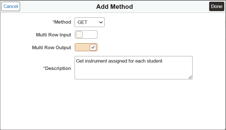

Adding Method
Select the Add Method button.
This example illustrates the fields and controls on the Add Method page for Consumer Application Service. You can find definitions for the fields and controls later on this page.
REST Method
Select type of HTTP method.
Multi Row Input
If you have multiple rows of input, select Yes, otherwise select No.
Multi Row Output
If you have multiple rows of output, select Yes, otherwise select No.
Description
Description of the method implementation.
REST Methods
REST methods determine the HTTP method for manipulating the resources defined in the Application Service.
HTTP Method Description
GET
Use to retrieve a representation of a resource.
GET is a safe and idempotent method. It must not be used to change a resource, create a resource or delete a resource.
Note: If you want to invoke the HEAD method for a consumer Application Service, use the GET method. See Using the GET Method to Invoke HEAD.
POST
Use to create new resource to an existing URL.
PUT
Use to create a new resource to a new URL, or modify an existing resource to an existing URL.
PUT requests are idempotent. That is, calling the same PUT request multiple times will always produce the same result.
PATCH
Use to update a portion of a document resource.
DELETE
Use against a singular resource to delete a document resource. DELETE doesn’t need a request body (Input parameters are optional). DELETE is not safe, but it must be idempotent.
Note: DELETE without a request body will be flagged in OpenAPI 3.0 as an error. The specification does not explicitly allow or disallow it.

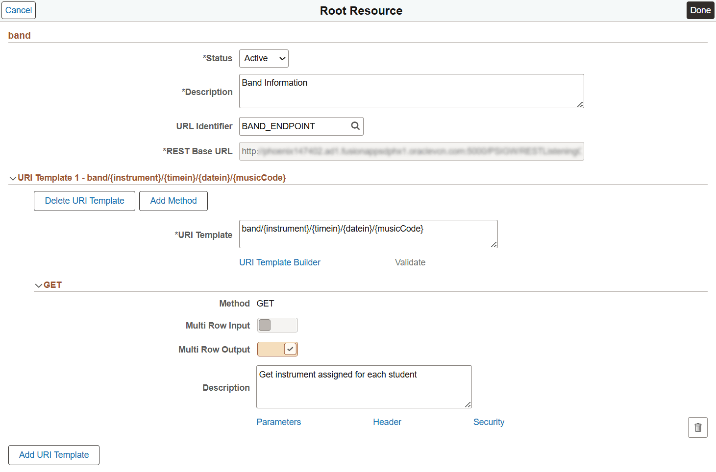

Root Resource with URI Template Defined
After you add a method to the URI template, you can expand the URI Template.
This example illustrates the fields and controls on the Root Resource with URI Template Method for Consumer Application Service. You can find definitions for the fields and controls later on this page.
For the expanded method the following links are available.
Parameters
Select this link to maintain the available input and output parameters.
See Adding Input and Output Parameters.
Header
Optionally headers can be assigned for the Request or Response. Selection of the Headers link will bring up the Headers page. These headers will be part of the Open API documentation for the 3rd party to set (Request) or read (Response).
See Defining Headers.
Security
Select this link to set the security for this method. See Setting Security Details
