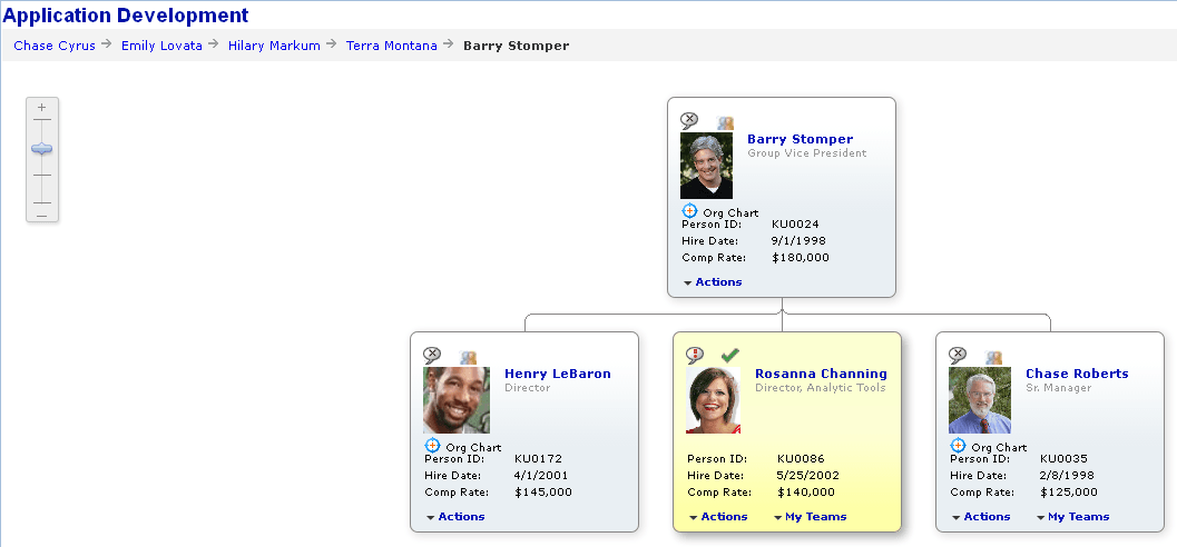

When zoom schemas are implemented for an organization chart, the chart displays a zoom control that enables a user to select a schema level.
The following example shows an organization chart with a zoom control and four schemas defined. The chart in this example displays schema level 3.
Example of an organization chart displaying schema level 3
The chart in the following example displays schema level 1, which displays less data on each node, allowing the chart to display more nodes in the same area.
