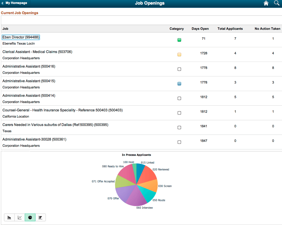

  6. Return to the application fluid page Job Openings.
    This example shows the rendered application fluid page Job Openings after the chart and the search options were inserted into the application page.
