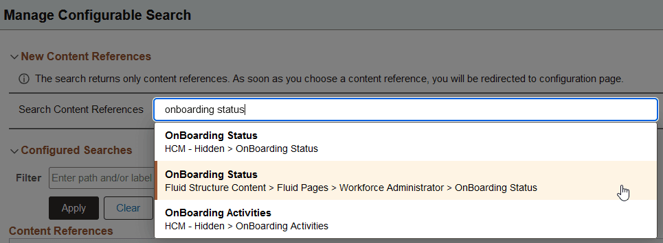

  1. From the menu in the browser, select PeopleTools, then Utilities, and then Manage Configurable Search.
  2. In the Content Reference field, enter the content reference name of the component.
    In this example, onboarding status was entered.
    Searching for a CREF on the Manage Configurable Search Page
  3. Select the content reference.
    In this example, the OnBoarding Status content reference definition in the Fluid Structure Content folder was selected.
