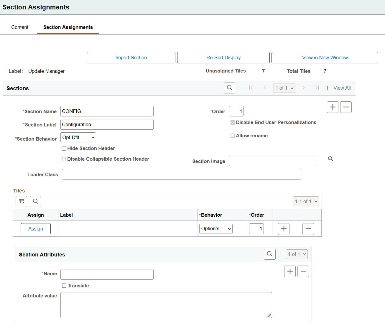

On the Tab Content page, select the Section Assignments tab.
This example illustrates the fields and controls on the Section Assignments page for dashboards. You can find definitions for the fields and controls later on this page.
Section Assignments page for Dashboard
Field or Control Description

Section Name
Enter a unique ID for the section definition. It should be unique within a dashboard.
The value that you specify in the Name field can consist of up to 30 letters, digits, and underscores ( _ ). It cannot contain any spaces and cannot begin with a digit.
Section Label
Enter a label for the section. The label is visible to all users who can view this section.
Section Behavior

Loader Class
Enter the full local path of the application class used to load tiles dynamically in the associated section. It is an extension to the base class PTNUI:Dynamic:DynamicLoader.
For more information, see PeopleCode API Reference: DynamicLoader Class Methods.
Order
Enter a value to designate the order of the sections when multiple sections are defined on a homepage.
The order number determines the sequence in which the sections appear on a homepage. The section with the lowest order number appears first. If any order numbers are identical, then the sequence is alphanumeric.

Tiles
The Tiles grid appears after you create a section, which enables you to assign tiles for the section.
Rules for assigning tiles to a section:
  • A tile can appear only once on a dashboard.
  • Ensure that the tiles with the Req-Fix behavior are grouped together at the beginning of the section.
  • Empty-section tile must be assigned the Req-Fix behavior and should be placed as the first tile in a section. See Configuring Tiles for an Empty Section.
Assign
Clicking the Assign button displays the Tile Assignment page where you can select tiles to insert into the section.
