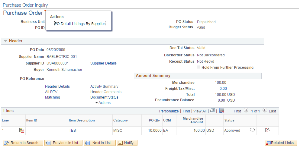

This example illustrate a self-service schedule on the Purchase Order page.
Purchase Order Inquiry page
In this example, the PO Detail Listings By Supplier self-service schedule is mapped to the Purchase Order Inquiry page. The related action link is available on this page.
To schedule a process,
  1. Select the related action link and then right-click the PO Detail Listings By Supplier link.
  2. In the Additional Parameters for PO Detail Listings By Supplier dialog box, which contains the fields with modifiable parameters, enter the essential information and click the OK button.

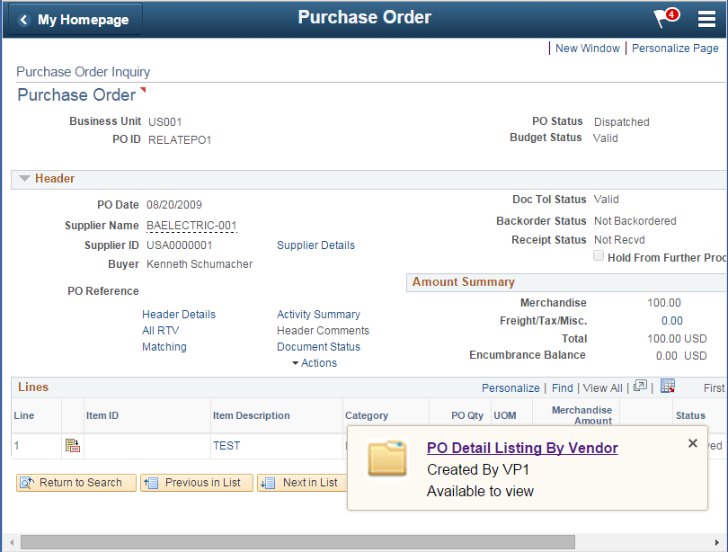

    The application validates the credential of the user and accordingly executes the process. At every process execution, a new run control ID is automatically created for the user.
  3. On successful authentication, a link to the report is generated if available. Click the link to access the report directly.
    This example illustrates the pop up notification window on the Purchase Order Inquiry page.
    Purchase Order Details Listing Report completion Pop-up Notification
    To display notification messages, you must configure the Push Notification configuration. For more information about push notification configuration, see Fluid User Interface Developer’s Guide: Configuring the System for Push Notifications.
  4. Click the PO Detail Listing By Vendor link on the pop-up window to view the report.
