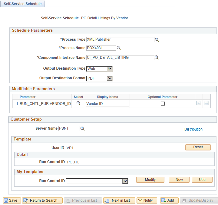

This example illustrates a Self-Service Schedule PO Detail Listing By Vendor page. You can find the definition for the fields and controls in the Customer Setup section later on this page.
Self-Service Schedule - PO Detail Listing By Vendor page
Field or Control Description
Server Name
Enter the server name to execute the schedule on the specified Server.
Note: If this field is left blank, the default Process Scheduler Server assignment takes place.
Distribution
Click this link to specify the distribution details. Use the Distribution Detail page to specify the users who would receive the process status notification with link to generated reports and other status information.
See Defining Distribution Lists and Setting Report Distribution
User ID
Specify the user associated with the selected run control ID.
Reset
Click this to reset the parameters in the customers setup section. This removes the run control template that is associated to this self-service schedule.
Note: The run control is not deleted.
Detail
Displays the selected run control ID that is used as a template.
Run Control ID
Select an existing run control ID.
My Template
Allows users to set the run control.
Modify
Allows editing of the Run Control. It opens up the Run Control page for editing the Run Control.
New
Allows creation of a new run control.
Use
Sets the Run Control Id selected in the Drop-down as the Current Active Template.
