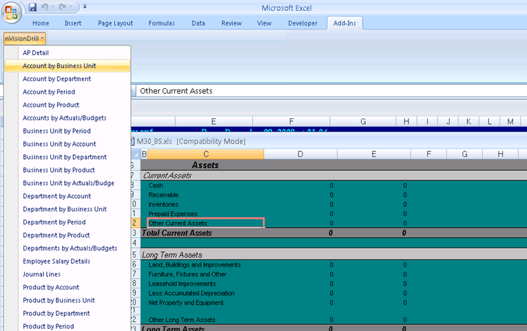

Performing nVision Drilldowns Using nVisionDrill VSTO Add-in
To perform nVision drilldown on an Excel report using the nVisionDrill VSTO add-in:
  1. Generate the parent report to perform the drilldown.
  2. Open the parent report from the nVision Instance folder.
  3. Highlight the field that you want to drill on for an Excel report.
  4. Expand the Add-ins tab in the Ribbon bar to view the nVisionDrill VSTO menu.
    The nVisionDrill VSTO menu appears under the Add-ins tab only if nVisionDrill add-in was successfully installed.
  5. With a drillable cell in the report selected, click the nVisionDrill VSTO menu.
    A login page appears.
    For nVision drilldown to work in VSTO mode, SSL configuration is required. This means that the URL should have https instead of http. Drilldown can be done on those reports that are previously generated using the https url.

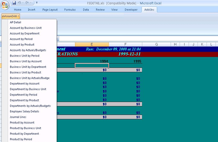

  6. Enter a valid PeopleSoft user ID and password.
    If the entered ID and password are valid, a list of drilldown layouts appears.
    This example shows the list of drilldown layouts from within the nVisionDrill menu.
    List of drilldown layouts from within the nVisionDrill menu
    When you click the nVisionDrill menu, the status of the Process Scheduler server appears to inform you whether the Process Scheduler server is running. If the Process Scheduler server is down, a message appears warning: Process Scheduler is down. nVision Drilldown is not possible at this time.
  7. Select an appropriate layout option from the layout list.
    The status bar displays the message: nVision drilldown has been submitted.
    The nVisionDrill runs and a Save As dialog box appears.
    If the selected cell is not drillable, you receive a warning message that says: nVision drilldown ran to Error. Check Server log for more details.
