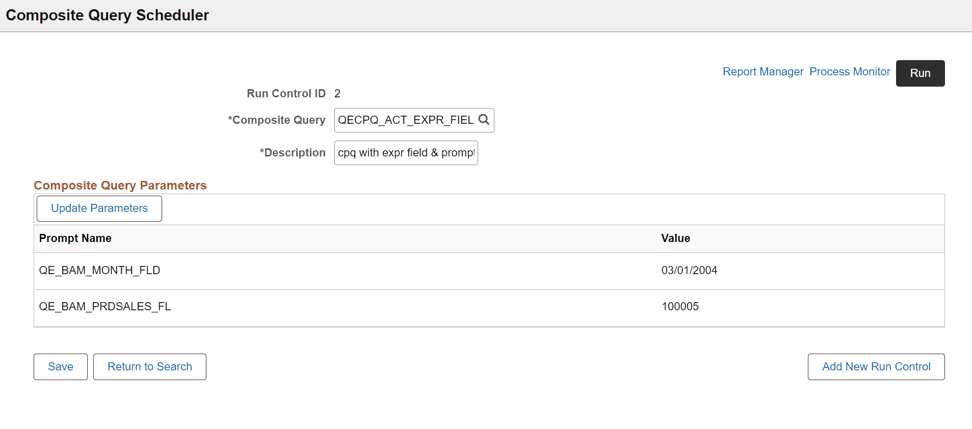

This example illustrates sample values of fields and controls displayed on the Composite Query Scheduler page after selecting the Run Control ID. Definitions for the fields and controls appear following the example.
Composite Query Scheduler page on selecting the Run Control ID
Field or Control Description
Report Manager
Click to access the Report Manager page to view the report content after the output file is posted and the output destination is set to Web or Window. The final output file is posted to the Report Manager repository for web access by authorized users. See Process Scheduler: Administering Report Manager
Process Monitor
Click to access the Process Monitor page and check the progress of your request. See Process Scheduler: Understanding Process Monitor, Process Scheduler: Viewing the Status of Processes
Run
Click to access the Process Scheduler Request page, where you can specify variables, such as where a process runs and in what format the process output is generated. The values for output type and output format appear by default per the report definition and can be changed if the report definition allows it. The process instance gets displayed on Composite Query Scheduler page once the process is scheduled.
Run Control ID
The selected run control ID that is used to schedule a composite query.
Composite Query
Enter or search for a composite query.
Description
Auto-filled description of the composite query.
Update Parameters
Click to update the runtime prompt values of composite query. SeeProcess Scheduler: Submitting Process Requests
Save
Click to save the changes made to the composite query parameters.
Return to Search
Click to return to the Composite Query Scheduler page displaying the existing run controls.
Add New Run Control
Click to add a new run control.
