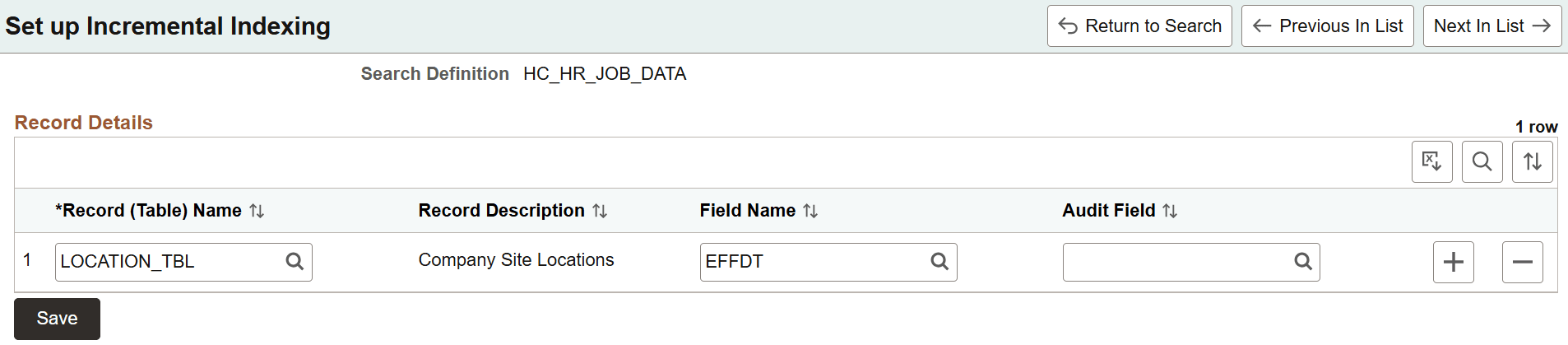

Using the Set up Incremental Indexing Page
Use the Set up Incremental Indexing page to configure incremental indexing for a specific search definition that has a date or datetime field and to specify any additional information required for incremental indexing of the search definition.
Access the Set up Incremental Indexing page by selecting PeopleTools, and then Search Framework, and then Automated Incremental Indexing, and then Set up Incremental Indexing.
The search page displays search definitions with the source type as query and connected query from the default search instance.
The search page also provides a comprehensive view of the Incremental Active status retrieved from the Configure Incremental Schedule page, enabling you to take the necessary action on a search definition.
Select a search definition to view or modify the Incremental Indexing information.
This example illustrates the fields and controls on the Set up Incremental Indexing page. You can find definitions for the fields and controls later on this page.
Field or Control Description
Record (Table) Name
Select the table where a change in data need to initiate incremental indexing.
Record Description
Displays the description of the selected record.
Field Name
Select the date or datetime field that needs to be monitored to identify the change in data in the table.
Audit Field
Select the date or datetime field that acts as an audit field in the table in case a current effective date data undergoes a change or any other specific use cases where only an audit field update happens.
This is an optional field.

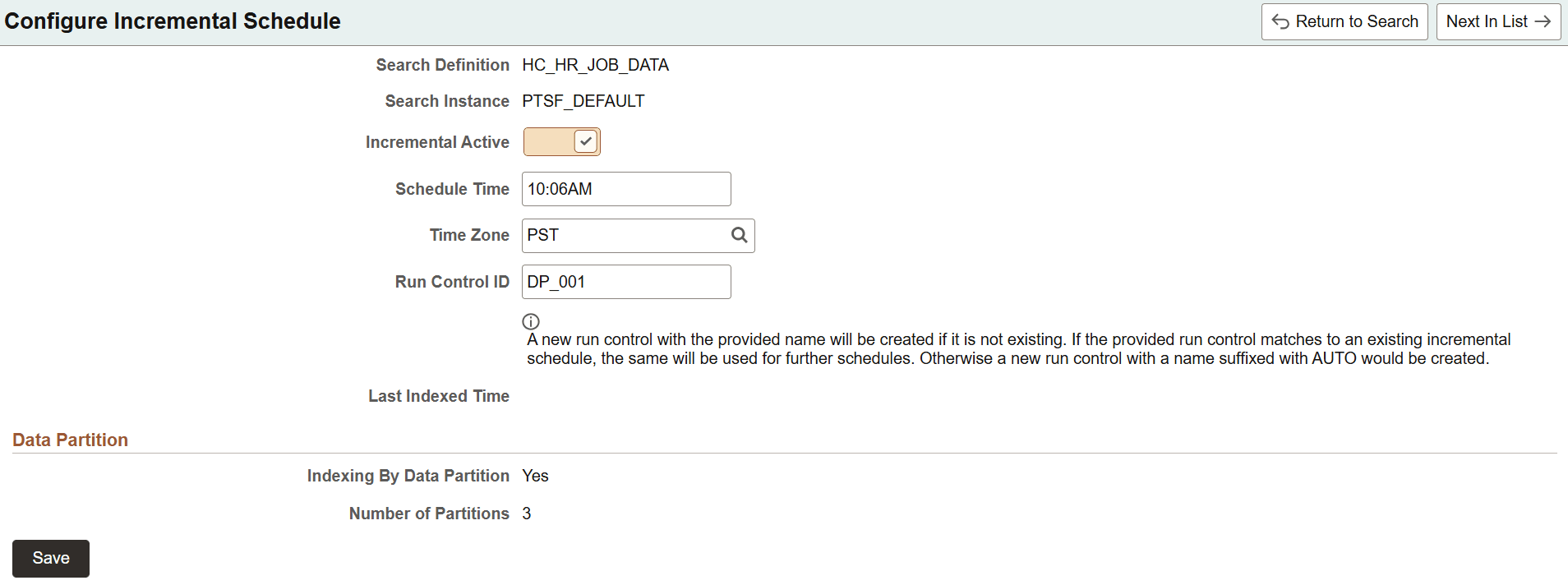

Using the Configure Incremental Schedule Page
Use the Configure Incremental Schedule page to activate or deactivate incremental indexing for a specific search definition and to specify any additional information required for scheduling incremental indexing of the search definition.
Access the Configure Incremental Schedule page by selecting PeopleTools, and then Search Framework, and then Automated Incremental Indexing, and then Configure Incremental Schedule.
The search page displays search definitions as well as their schedule and last scheduled time status, enabling you to take necessary action on search definitions.
This example illustrates the fields and controls on the Configure Incremental Schedule page. You can find definitions for the fields and controls later on this page.
Search Definition
Displays the search definition’s name.
Search Instance
Displays the search instance's name.
Incremental Active
Enable the Incremental Active button to schedule incremental indexing at the specified time.
Schedule Time
Specify the time for initiating incremental indexing.
Time Zone
Select the preferred execution time zone.
Run Control ID
By default the last run control from a successful indexing is displayed. However, you can provide a run control of your choice. If the given run control doesn't exist, the system automatically creates a new incremental run control.
Last Indexed Time
Displays the date and time when the index was scheduled successfully.
Index By Data Partition
Displays whether the Search Framework partitions the application data using the Index By Data Partition option.
This field is populated when data partition run control is available.
Number of Partitions
Displays the number of partitions.
This field is populated when data partition indexing is enabled in the search definition.

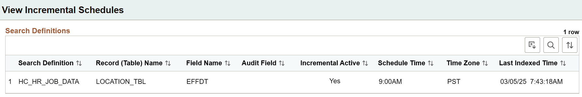

Using the View Incremental Schedules Page
Use the View Incremental Schedules page to view the data related to incremental indexing. This page provides a comprehensive view of the information retrieved from the Set up Incremental Indexing and Configure Incremental Schedule pages.
Access the View Incremental Schedules page by selecting PeopleTools, and then Search Framework, and then Automated Incremental Indexing, and then View Incremental Schedules.
This example illustrates the fields and controls on the View Incremental Schedules page.
