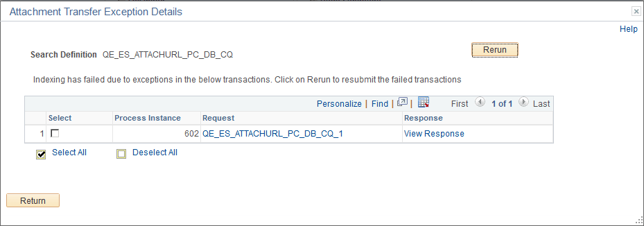

Viewing the Exception Details in Attachment Processing
In the Previous schedule details section, select the Error link to view the details of exceptions with respect to attachment processing.
This example illustrates the fields and controls on the Attachment Transfer Exception Details page. You can find definitions for the fields and controls later on this page.
| Field or Control | Description |
Process Instance |
The process instance ID of the PTSF_GENFEED Application Engine program that is causing the exception. |
Request |
The request sent by the PTSF_GENFEED Application Engine program to the search engine. |
Response |
The response received by the PTSF_GENFEED Application Engine program from the search engine. |
Rerun |
Use the Rerun button to resubmit the selected transactions to the search engine. In the case where the maximum exceptions limit is not reached, when you select the Rerun button, the transactions are directly submitted to the search engine without re-execution of the PTSF_GENFEED Application Engine program. In the case where the maximum exceptions limit is reached, the Rerun button acts as a re-submit of the PTSF_GENFEED Application Engine program. |
