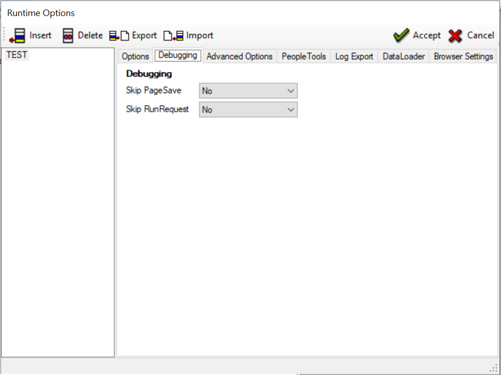

Use the Debugging tab to specify how PTF should manage page saves and run requests during test runtime.
This example illustrates the fields and controls on the Runtime Options dialog - Debugging tab. You can find definitions for the fields and controls later on this page.
Runtime Options dialog- Debugging tab
The following fields are on the Debugging tab:
Term Definition
Skip PageSave
Select Yes to prevent a test from running a save. You would, for instance, select this option to avoid duplicate values in the application database if you plan to run a test repeatedly.
Skip RunRequest
Select Yes to prevent the test from running process requests.
