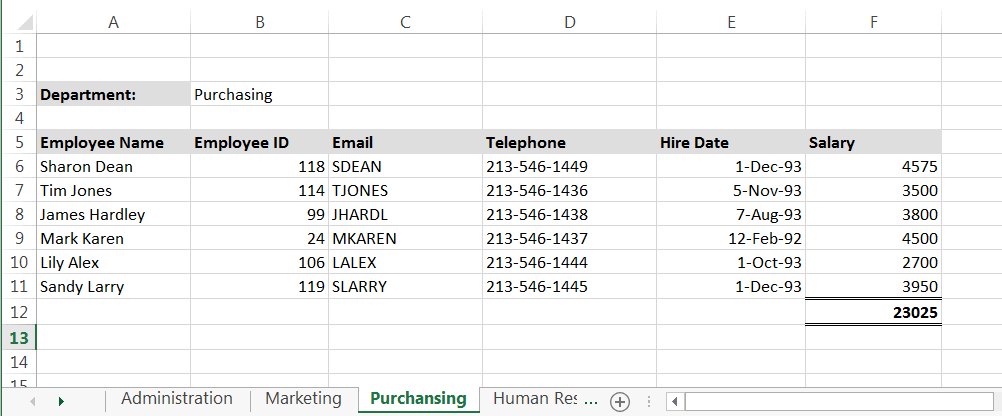

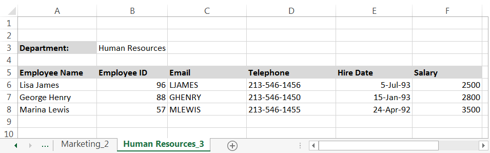

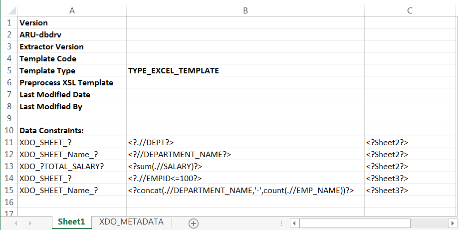

Example: Splitting the data into multiple sheets
Using employee data, this example:
- Lists the employees of each department in separate sheets.
- Creates a new worksheet for each department.
- Names each worksheet the name of the department. For example, Marketing.
- Lists the first 100 employees in separate sheets for the departments of the first 100 employees.
- Creates a new worksheet for each department to which the first 100 employees belong.
- Names each worksheet the name of the department with the number of employees with employee ID less than 100 in that department. For example, Human Resources-3 if three employees in the Human Resources department have employee ID less than 100.
- Enter the defined names for each cell of employee data and create the group for the repeating employee data, as shown in the following illustration. Do not create the grouping around the department because the data is split by department.
- Enter the values in the Data Constraints section of the XDO_METADATA sheet.
The entries are shown in the following illustration.
The following illustration shows the generated report. The data for each department is displayed on its own sheet, which is named per the specified convention.

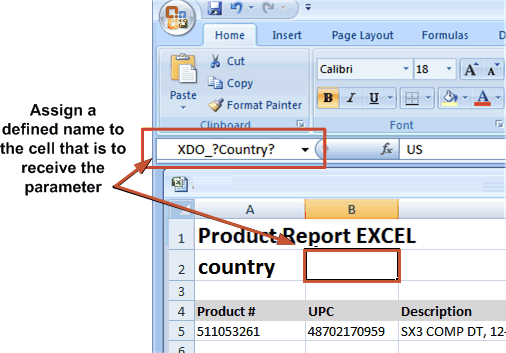

To declare and reference a parameter named Country:
In the template sheet, mark the cell with a defined name. In the following figure, the cell has been marked with the defined name XDO_?Country?

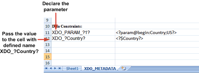

In the hidden sheet assign that cell the parameter value, as shown in the following figure:

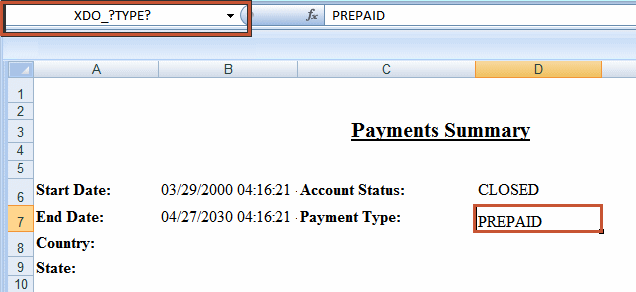

Example: Importing and Calling a Subtemplate
Assume you have the following subtemplate uploaded to the catalog as PaymentsSummary-SubTemplate.xsb. This subtemplate evaluates the value of a parameter named pPayType and based on the value, returns a string that indicates the payment type:
<?xml version="1.0" encoding="utf-8"?>
<xsl:stylesheet version="2.0"
xmlns:xsl="http://www.w3.org/1999/XSL/Transform">
<xsl:template match="/">
</xsl:template>
<xsl:template name="BRM_PAY_TYPES">
<xsl:param name="pPayType" select="string('ALL')"/>
<xsl:choose>
<xsl:when test="$pPayType = '0'">UNDEFINED</xsl:when>
<xsl:when test="$pPayType=string('10000')">PREPAID</xsl:when>
<xsl:when test="$pPayType=string('10001')">INVOICE</xsl:when>
<xsl:when test="$pPayType=string('10003')">CREDIT CARD</xsl:when>
<xsl:when test="$pPayType=string('10005')">DIRECT DEBIT</xsl:when>
<xsl:when test="$pPayType=string('10011')">CASH</xsl:when>
<xsl:when test="$pPayType=string('10012')">CHECK</xsl:when>
<xsl:when test="$pPayType=string('ALL')">ALL</xsl:when>
</xsl:choose>
</xsl:template>
</xsl:stylesheet>
In the Excel template, you've defined a field with the XDO Defined Name XDO_?TYPE?, which is populated based on the string returned from code performed in the subtemplate, as shown in the following figure:
Enter the commands shown in the following table in the Data Constraints region.
| Column A Entry | Column B Entry |
XDO_SUBTEMPLATE_?1? |
XDO_?TYPE? |
The XDO_SUBTEMPLATE_?1? function imports the subtemplate from the catalog.
The XDO_?TYPE? cell entry maps the results of the subtemplate processing entered in Column B.

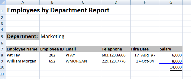

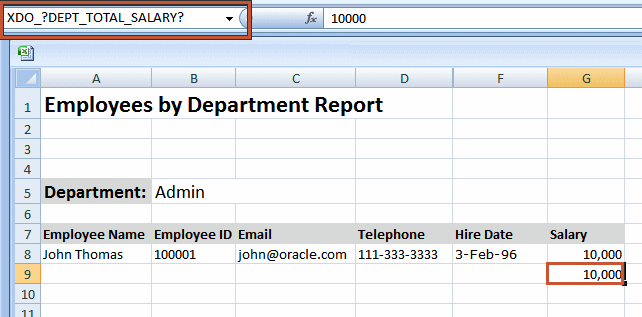

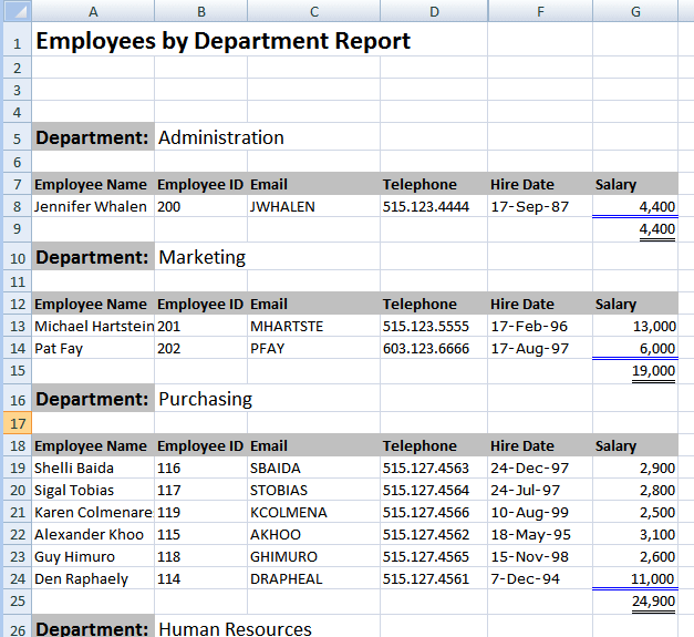

Example: Defining Styles
To apply a style in a template, the style value must be present in the data. In this example, a border style and an underline style are applied to the DEPT_TOTAL_SALARY field shown in the Excel template.
For this example, the following data is used. Note that the DEPT_TOTAL_SALARY element in the data has these attributes defined:
borderStyle
underLineStyle
borderColor
The value of each of these attributes is used to apply the defined style based on logic defined in the template.

<DEPT_TOTAL_SALARY borderStyle="BORDER_DOUBLE" underLineStyle="UNDERLINE_DOUBLE_ACCOUNTING" borderColor="0000FF">19000</DEPT_TOTAL_SALARY>
</G_DEPT>
</EMPLOYEES>
To define a style:
In the Excel template, assign the defined name XDO_?DEPT_TOTAL_SALARY? to the field that is to display the DEPT_TOTAL_SALARY from the data, as shown in the following figure:
In the XDO_METADATA sheet, enter the following:
To define the top border style, use these entries:
- Column A entry:
XDO_STYLE_1_?DEPT_TOTAL_SALARY? - Column B entry:
<xsl:value-of select=".//DEPT_TOTAL_SALARY/@borderStyle"/> - Column C entry: TopBorderStyle
The entry in Column A maps this style command to the cell assigned the name XDO_?DEPT_TOTAL_SALARY?
The entry in Column B retrieves the style value from the attribute borderStyle of the DEPT_TOTAL_SALARY element. Note from the sample data that the value for borderStyle is "BORDER_DOUBLE".
The entry in Column C tells Publisher to apply a TopBorderStyle to the cell.
- Column A entry:
To define the top border color, use these entries:
- Column A entry:
XDO_STYLE_2_?DEPT_TOTAL_SALARY? - Column B entry:
<?.//DEPT_TOTAL_SALARY/@borderColor?> - Column C entry: TopBorderColor
The entry in Column B retrieves the style value from the attribute borderColor of the DEPT_TOTAL_SALARY element. Note from the sample data that the value for borderColor is 0000FF (blue).
The entry in Column C tells Publisher to apply a TopBorderColor to the cell.
- Column A entry:
To define the underline style, use these entries:
- Column A entry:
XDO_STYLE_3_?DEPT_TOTAL_SALARY? - Column B entry:
<?.//DEPT_TOTAL_SALARY/@underLineStyle?> - Column C entry: UnderlineStyle
The entry in Column B retrieves the style value from the attribute underLineStyle of the DEPT_TOTAL_SALARY element. Note from the sample data that the value for underLineStyle is UNDERLINE_DOUBLE_ACCOUNTING.
The entry in Column C tells Publisher to apply the UnderLineStyle to the cell.
- Column A entry:
The following figure shows the three entries in the Data Constraints region:
When you run the report, the style commands are applied to the XDO_?DEPT_TOTAL_SALARY? cell, as shown in the following figure:

To suppress the display of the row of the employee data when the MANAGER attribute is set to "True", enter the entries shown in the following table in the Data Constraints section.
XDO_SKIPROW_?EMPLOYEE_ID? |
<xsl:if test="string-length(./EMPLOYEE_ID/@MANAGER) != 0"> <xsl:value-of select="./EMPLOYEE_ID/@MANAGER"/> </xsl:if> |
The output from this template is shown in the following illustration. Note that the employee Michael Hartstein isn't included in the report.
