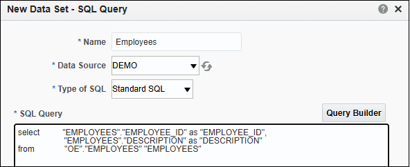

Use the Query Builder to retrieve the column in your SQL query, then use the data model editor to specify how you want the data structured. When the data model is executed, the data engine can structure the data either as:

To create a dataset from data stored as a CLOB:

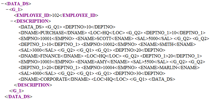

When you execute the query, if the CLOB column contains well-formed XML, and you select the XML data type, the data engine returns the XML data, structured within the CLOB column tag name.
Example output when data type is XML:
Note the <DESCRIPTION> element contains the XML data stored in the CLOB column, as shown below.
