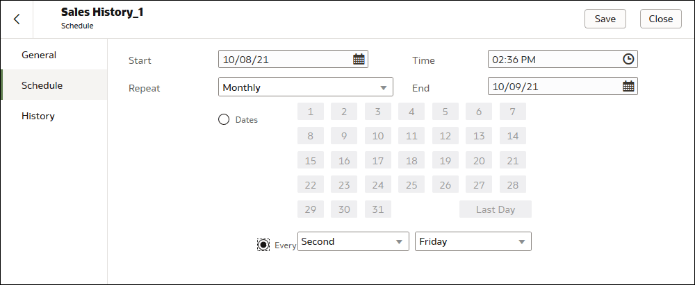

  4. Click the name of a schedule, and in the Schedule dialog click the General and Schedule tabs to view information about the schedule.
  5. Optional: Click the History tab to view a list of the schedule's completed jobs. Click a job to drill down for more information about it, such as its start time and completion status.
  6. Click OK.

  4. Click the name of a schedule, and in the Schedule dialog click the Schedule tab.
  5. Update the schedule details.
  6. Click Save.
