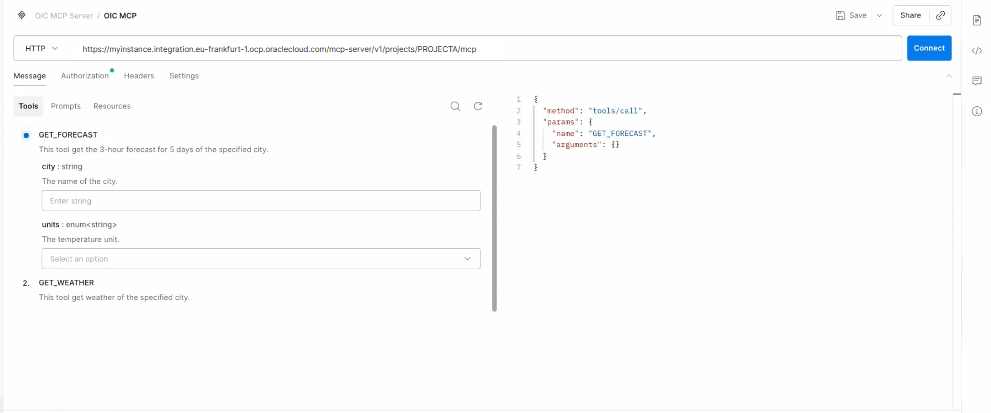

Here's an example of connecting to a project's MCP server with Postman. You configure OAuth Authorization in Postman and add the MCP Server URL.
Postman showing connection to Oracle Integration MCP server. The URL in the address bar is " https://myinstance.integration.eu-frankfurt-1.ocp.oraclecloud.com/mcp-server/v1/projects/PROJECTA/mcp ". The Tools tab displays GET_FORECAST and GET_WEATHER options, with input fields for city and units under GET_FORECAST. On the right, a JSON method configuration tools/call is shown. A Connect button is highlighted in blue at the top right.
