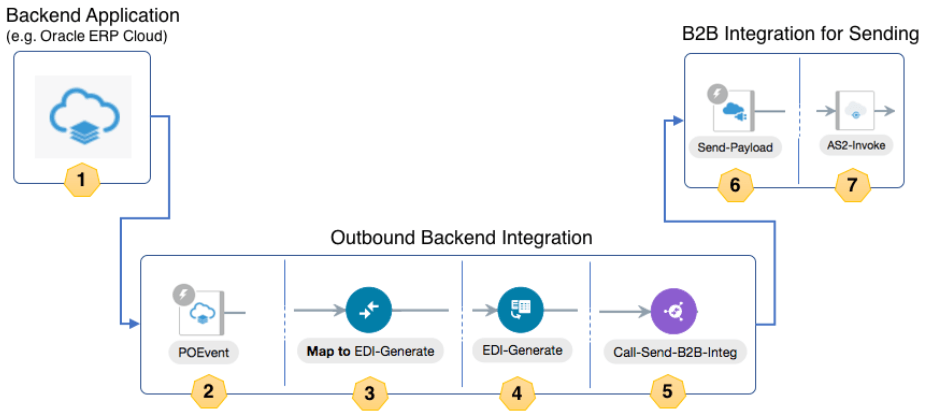

This section describes the high-level steps involved in processing an outbound B2B message.
The high-level steps involved in processing an outbound B2B message are as follows.
This diagram is described in the table below.
Step Description
1 Your backend application has a requirement to send a business transaction to an external trading partner. It triggers your outbound backend integration by sending it a notification message.
2 Your backend integration instance receives the notification that includes the application message in the backend application message format.
3
Using a mapper, the backend application message is transformed into a B2B canonical XML format.
When a document of Opaque standard is used in outbound agreement, the backend application message contains base64 encoded payload. This is only supported within projects in B2B trading partner mode.
4
The canonical XML message is provided to a B2B action for outbound translation (the action named EDI-Generate above). A trading partner is specified as an input to the B2B action. The B2B action translates the canonical XML message to a native EDI format (X12 or EDIFACT) and persists it in the Oracle Integration persistence store. A unique ID is assigned to it.
If base64-encoded data is received by the B2B translate activity, it decodes the data and sends it to the specified trading partner in its original (decoded) format.
5 Based on the target trading partner, the current document type, and the outbound agreements defined for the trading partner, an appropriate B2B integration for sending messages is triggered. The message ID is handed to it.
6 The B2B integration for sending messages instance starts and receives the message ID at its REST Adapter trigger endpoint.
7 The B2B integration for sending messages instance uses an adapter (AS2 or FTP) to pack the message and then transmit it to the external trading partner through the AS2 or FTP protocol.

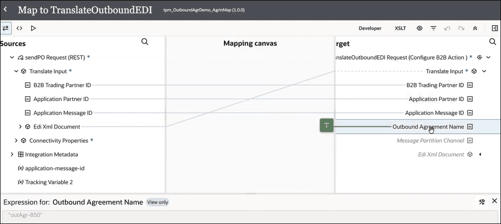

To use the Outbound Agreement Name:
  • Map the outbound agreement’s name in the mapper while configuring the B2B action in the outbound backend integration.
    Outbound Agreement Name mapping

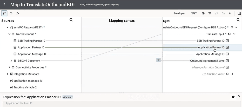

To use the Application Partner ID:

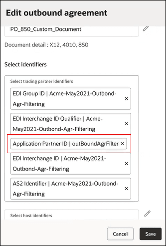

  1. Configure the Application Partner ID in the outbound agreement
    1. Specify the Application Partner ID in the B2B identifiers tab.
      Define B2B identifier for Appliction Partner ID
      For more information on B2B identifiers and their usage, see Define B2B Identifiers.
    2. Select the identifier you defined for the Application Partner ID in the outbound agreement.
      Select Application Partner ID identifier in the Create outbound agreement panel.
  2. Map the Application Partner ID in the mapper while configuring the B2B action in the outbound backend integration.
    Mapping Application Partner ID

  1. If Outbound Agreement Name is available, it will be used first to identify an outbound agreement. If a unique match is found with it, then processing continues. Otherwise, an exception error is thrown informing that no matching outbound agreement was found.
  2. If Outbound Agreement Name is not available, then the Application Partner ID is used to identify the agreement. If a unique match is found with it, then processing continues.
